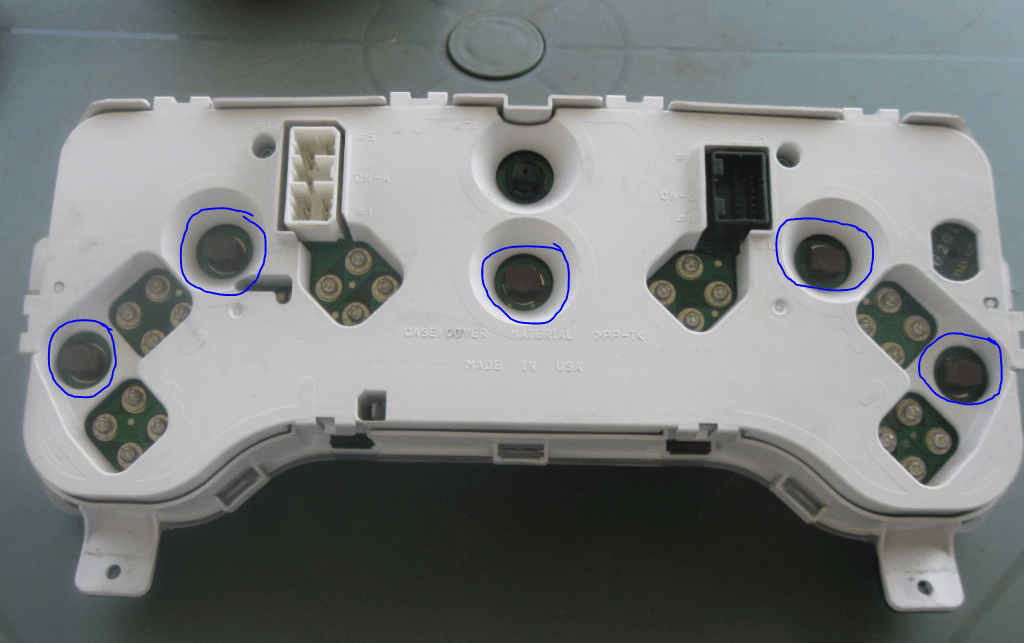

All five bulbs in the cluster are the same. You don't need to change the high beam or turn signal lights. See below:
Your cluster version may vary from this slightly, but the positions of the bulbs are the same.
The bulbs referenced above do not come with housings as you will reuse the existing 1/4 turn housing. Superbrightleds.com does now carry bulbs that include the housing as well (https://www.superbrightleds.com/mor...led-bulb-high-power-instrument-panel-led/709/). I haven't used them, but they only have one SMD (emitter) whereas the bulbs referenced above have three SMD. I would assume the bulbs with three emitters produce a bit more light.

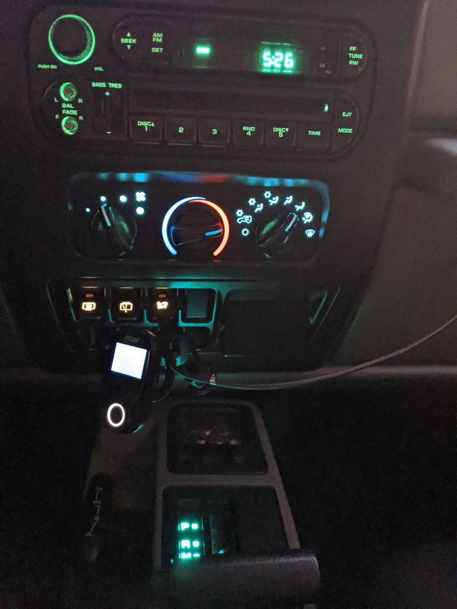

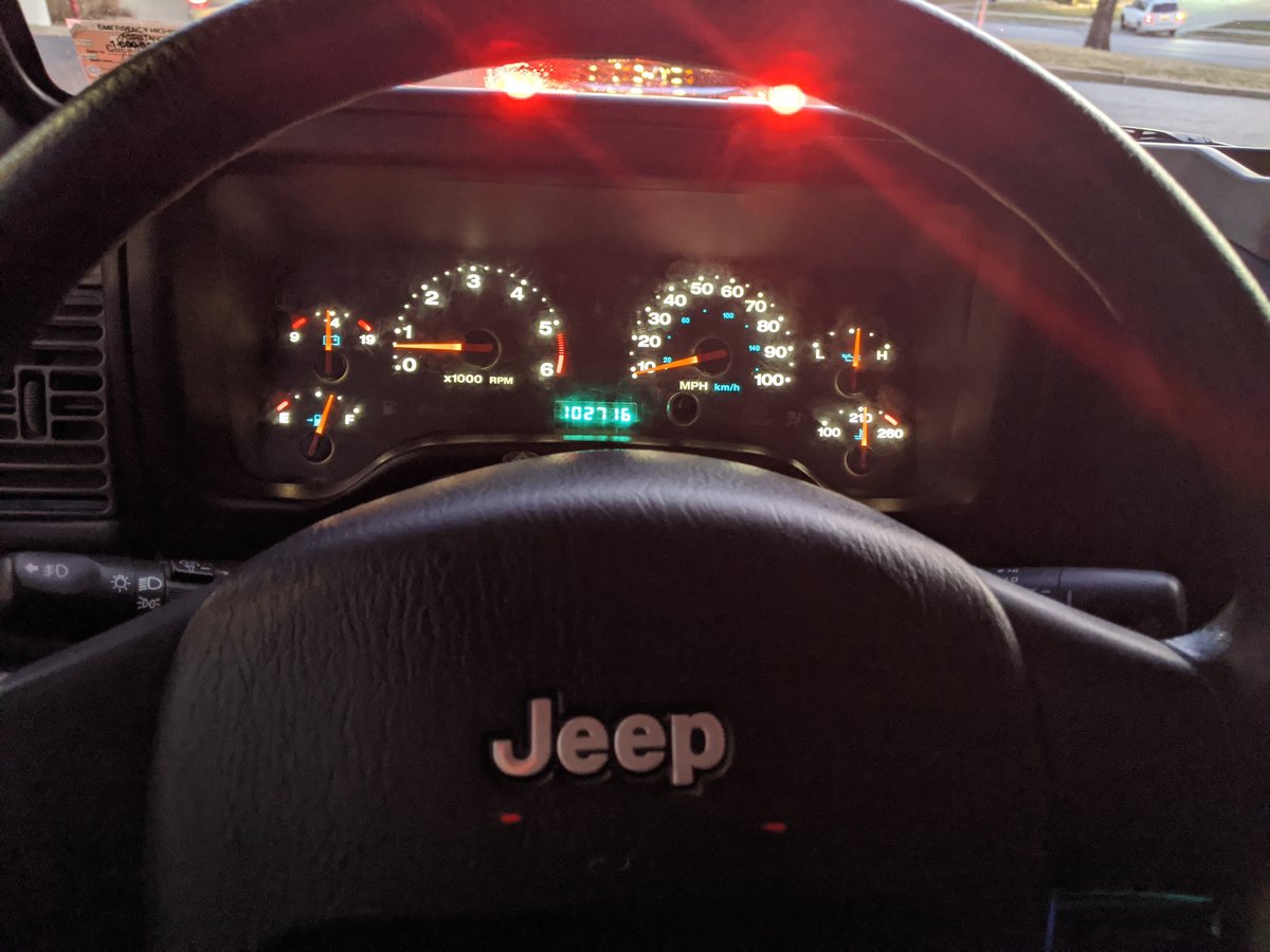

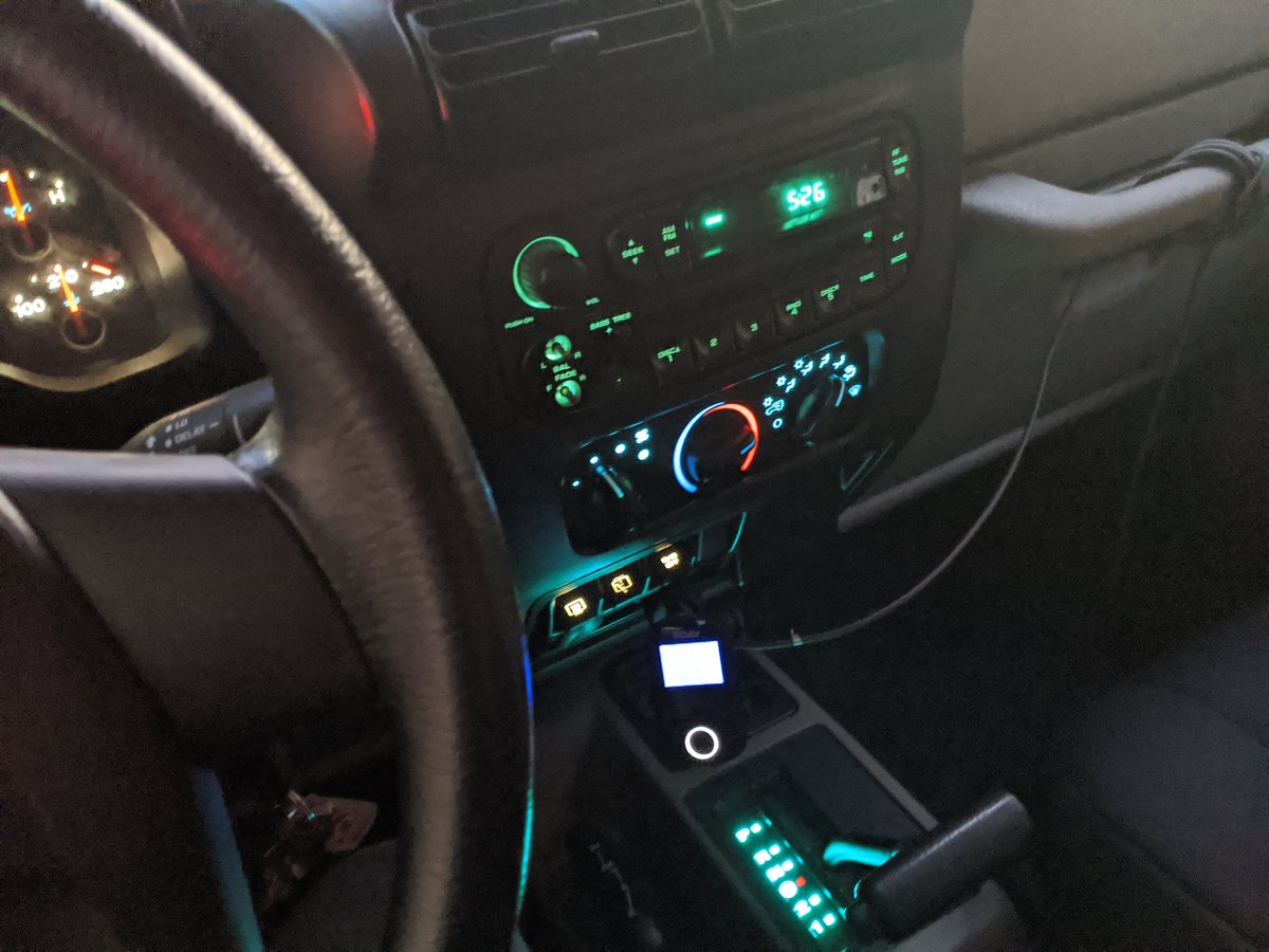

Really happy with how these turned out and thanks again to this thread. I'm always trying to maintain a stock look as much as possible and the natural white was a great choice for that. Accidentally ordered cool white for shifter but I'm into it.
View attachment 133085View attachment 133083
@Not_Invented_Here_
That really looks great. You said you ordered cool white accidentally for the shifter. Do you remember which one you used for the HVAC panel? Wondering if it's cool like the shifter or natural like the instrument cluster?
