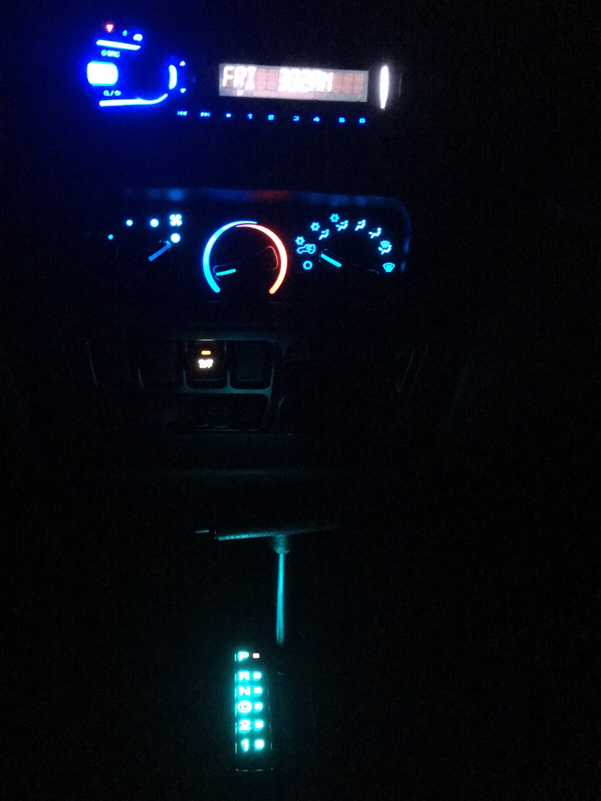

As hard as I tried, the camera just couldn't get a good photo. It looks so much better than factory though. The lights are much more green, and the Rubicon locker switch I put a red LED bulb in (so it looks red like factory) and it turned out great too!
It's not as blindingly bright in person as the photo make it seem. I also have the dimmer set to max in this photo, so that might be part of it too.
I want that same green. What is the name of that LED, size, and where you bought them?

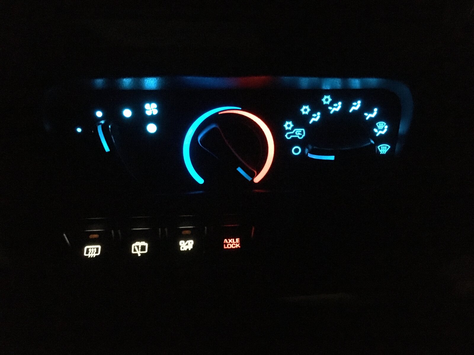

Is there any way to get rid of the blue hue that the HVAC controls have? I would love to be able to have everything cool white.
When I replaced my stock bulbs to cool white LEDs from Superbrightleds.com, they didn’t look bluish anymore.
I’ve since replaced all bulbs with green.
Here's what the HVAC controls and switches look like with cool white LED. The cool white inherently has a hint of blue to it.
I take that back, I just looked at this picture I took when I had cool whites in there and they are bluer than I remember.
The green I have now overrides the blueish color.
