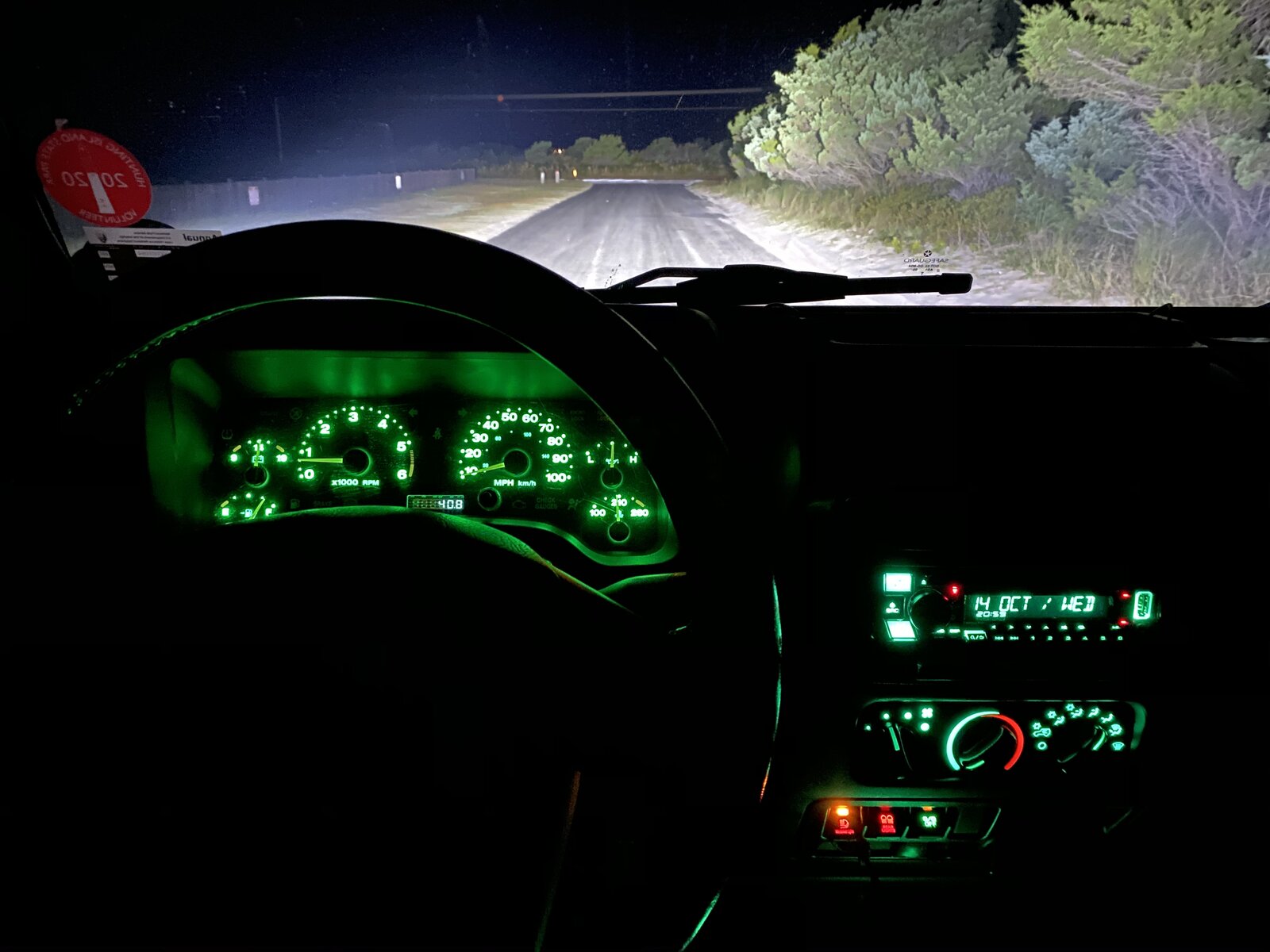

I have green and like it a lot. Easy on the eyes. Some are from Superbright LEDs, and some from Amazon. I don’t remember which ones though. I‘ve never had an OEM radio in it, so I can’t compare that part of it.

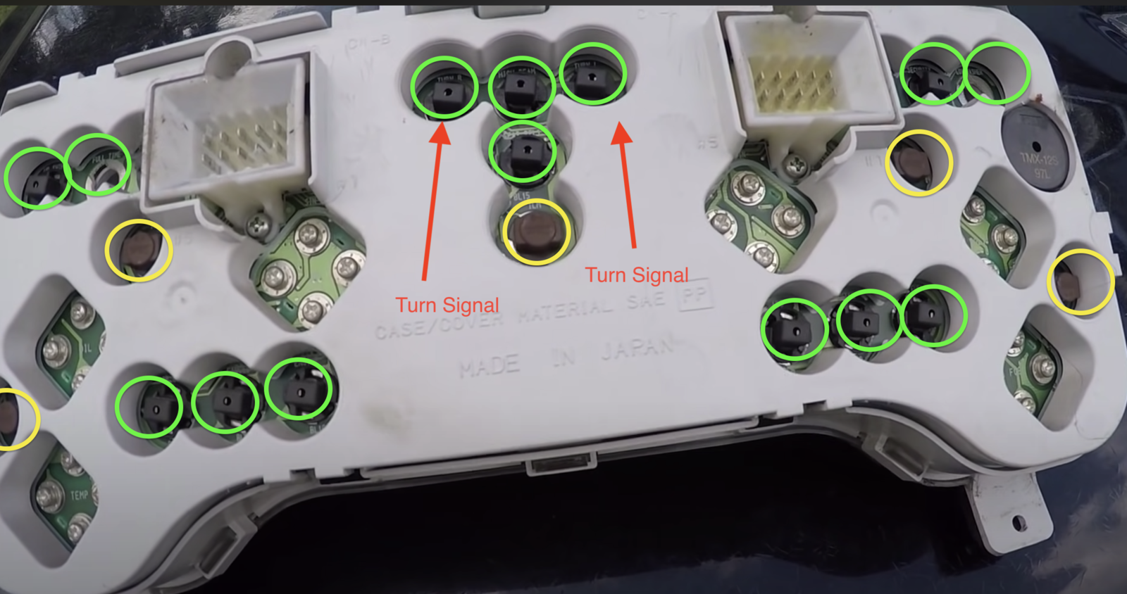

Wanna do this mod but one question. List says instrument cluster takes 5 bulbs. See below highlighted in yellow.
What about all the other bulbs circled/highlighted in green? Are they even bulbs? For example the turn signals (below). Are they separate bulbs? Can someone help me clarify?

The five bulbs are for the backlight of the cluster. all the others are indicator/warning lights. I changed only the backlight. Left everything else the same except for removing the upshift light.
But what size are the other bulbs?
I think the (5) yellow backlights are 194 bulbs and the other green indicator lights are PC74 bulbs. Both are available in LED versions now. However, the PC74s are generally not replaced because incandescent bulbs have a fairly reliable lifetime in hours, and since the indicator lights don't light up very often, they almost never burn out. On the other hand, the backlights are on whenever your headlights are on, so they do burn out eventually.
