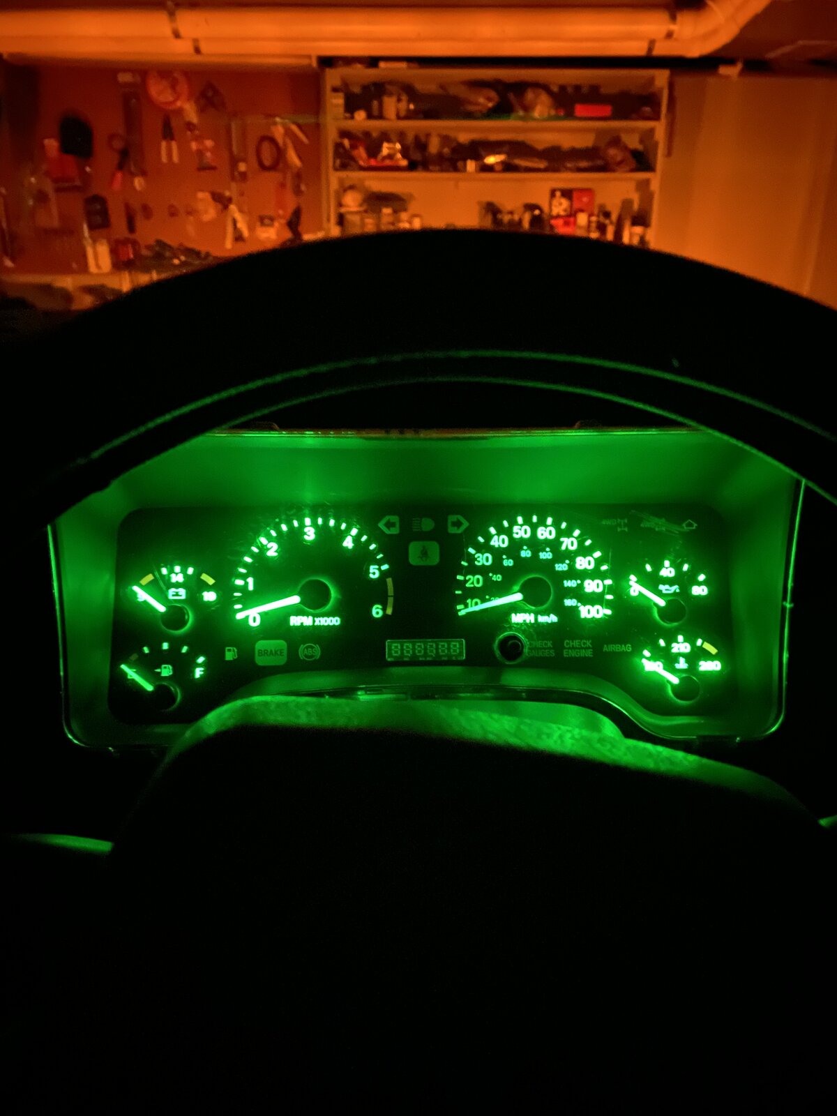

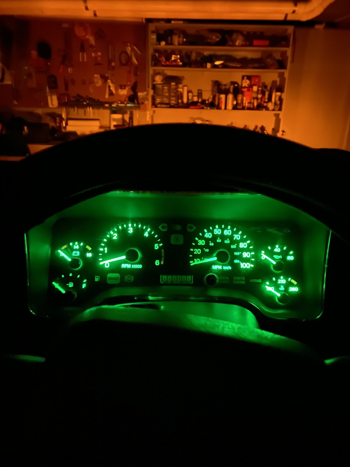

I did get 4 working LEDs out of 5 this evening! Check it out! I figured I’d leave the middle bulb stock until the replacement came in.

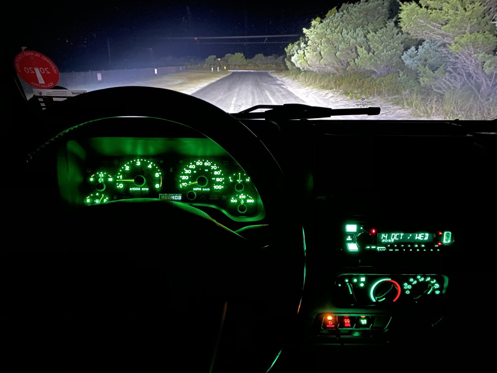

All but a couple of my interior lights are green also, including the footwell and sound bar lights. Very happy with it.

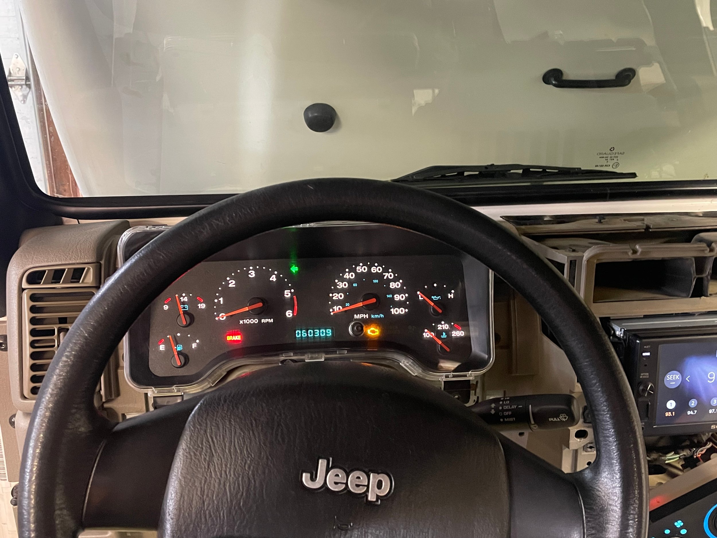

I bought all the requirements for the Parts Required for 1997-2002 but I think I also still need to buy the hubs? When I tried to replace today, the bulbs weren't removeable from the old hubs, at least I couldn't figure out a way to do it. I started with the instrument cluster and just stopped there once I ran into the issue. Do I need a different hub or do the old lights come out of this one some how. If so, how? If I need new hubs, do I get the same kind of hub for the footwells, soundbar, HVAC lights, etc? Also, where is the footwell light on the passenger side? I couldn't find it.

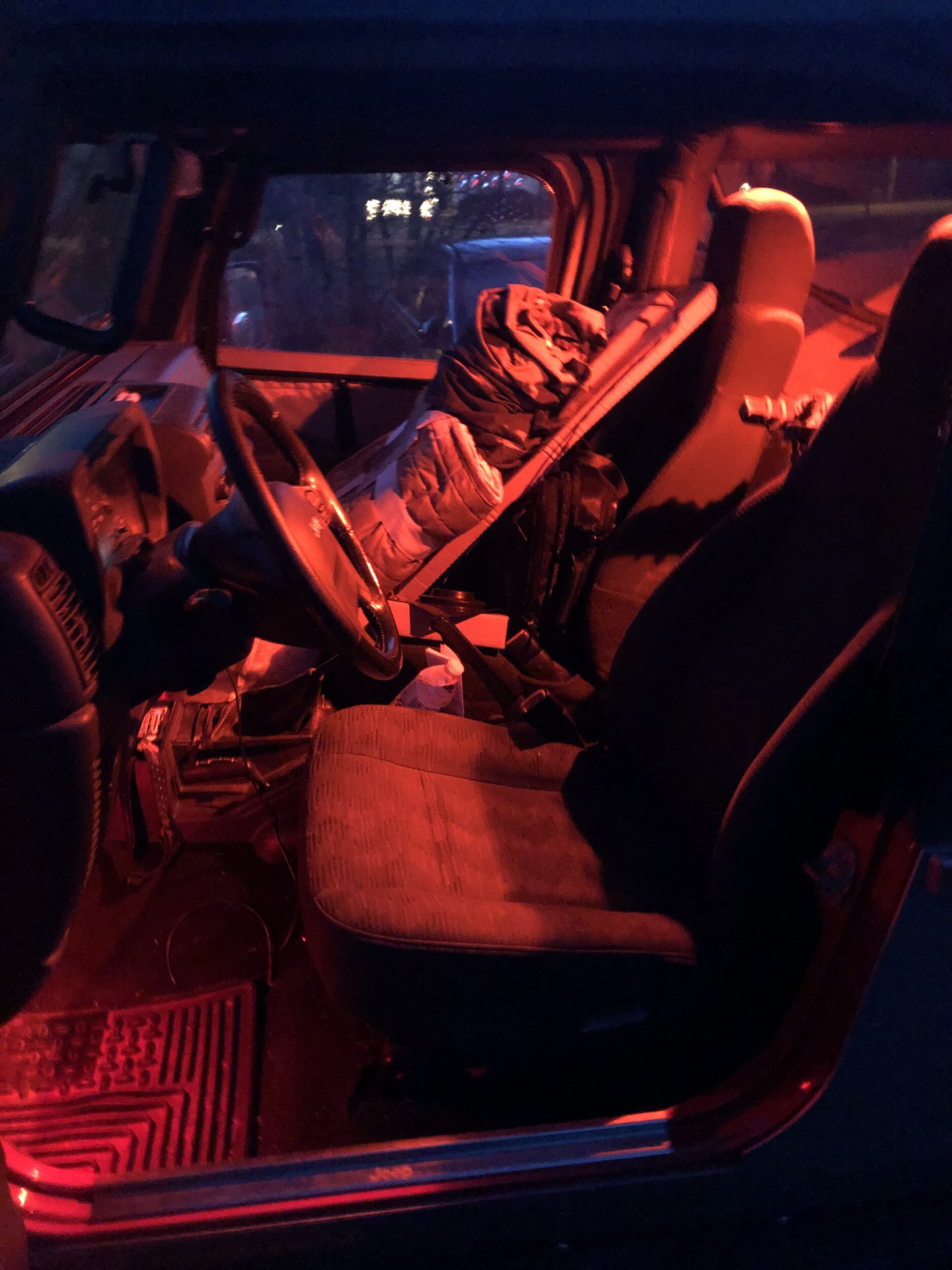

Here's mine I decided to switch it up a bit, and two tone mine with red/white, btw great write up.
