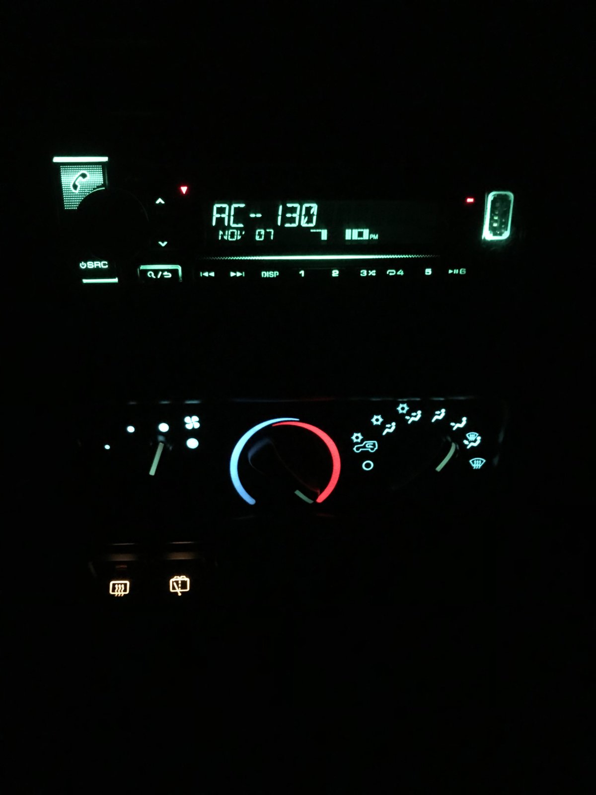

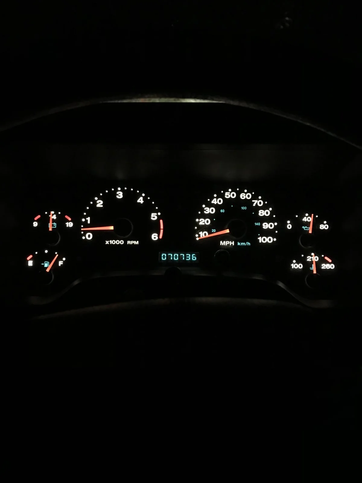

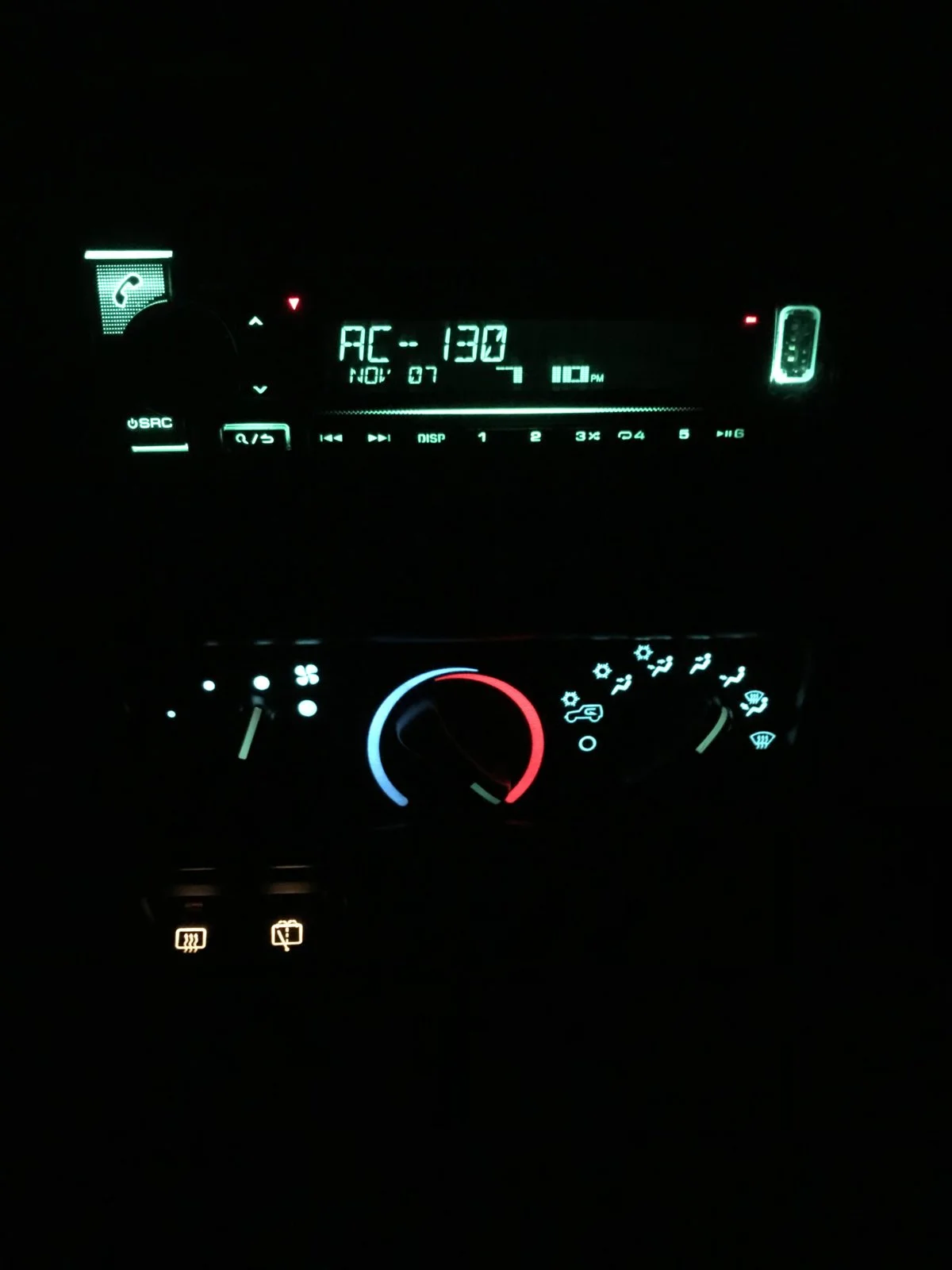

Just thought I would throw in my results since I decided to go with “warm white” and no one else has a photo.
The color is pretty much spot on with stock, just much brighter. My only thing is that the HVAC symbols came out more a whiteish-blue than the original color that matched with everything else. Which is weird because the LEDs are the exact same color as the bulbs I pulled out.

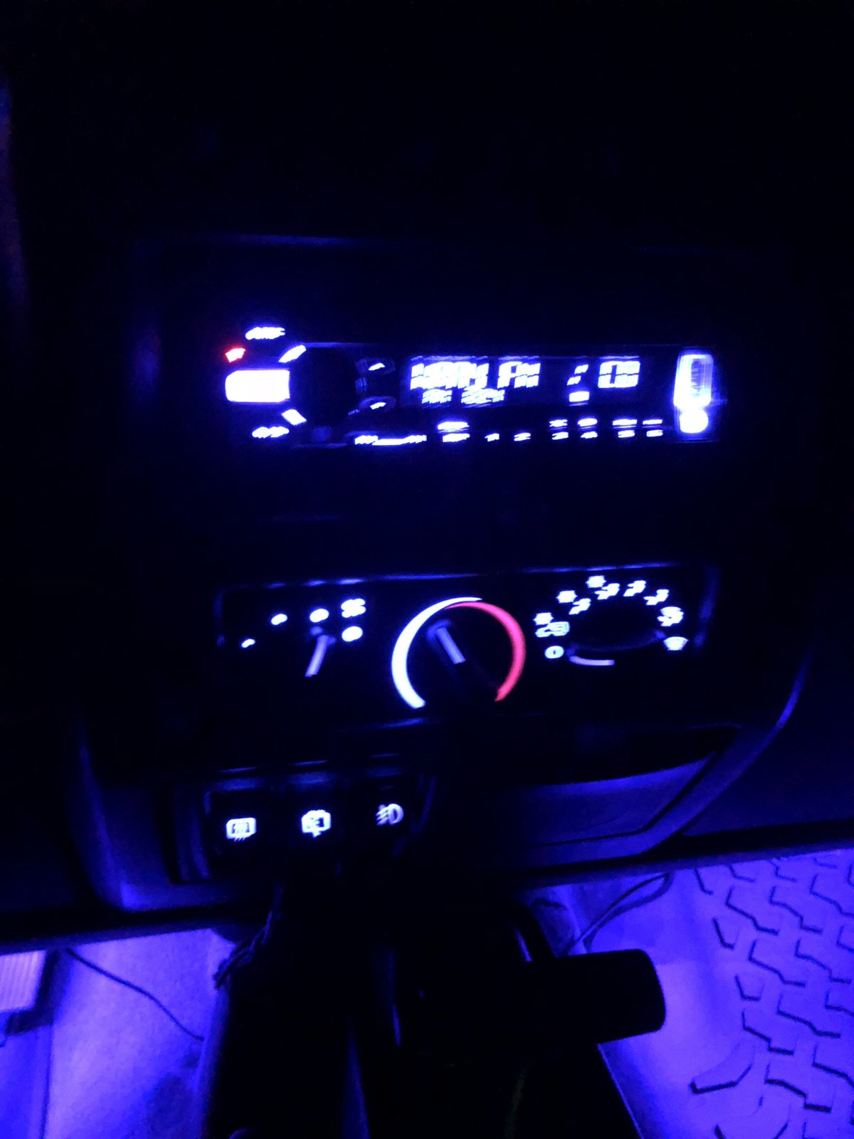

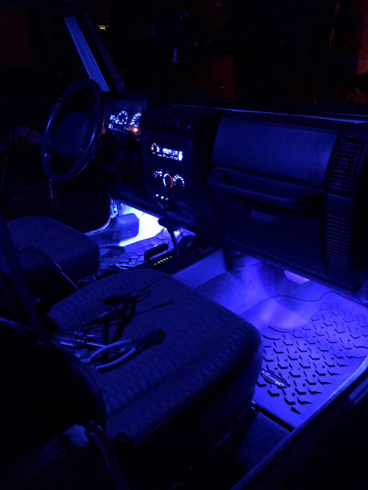

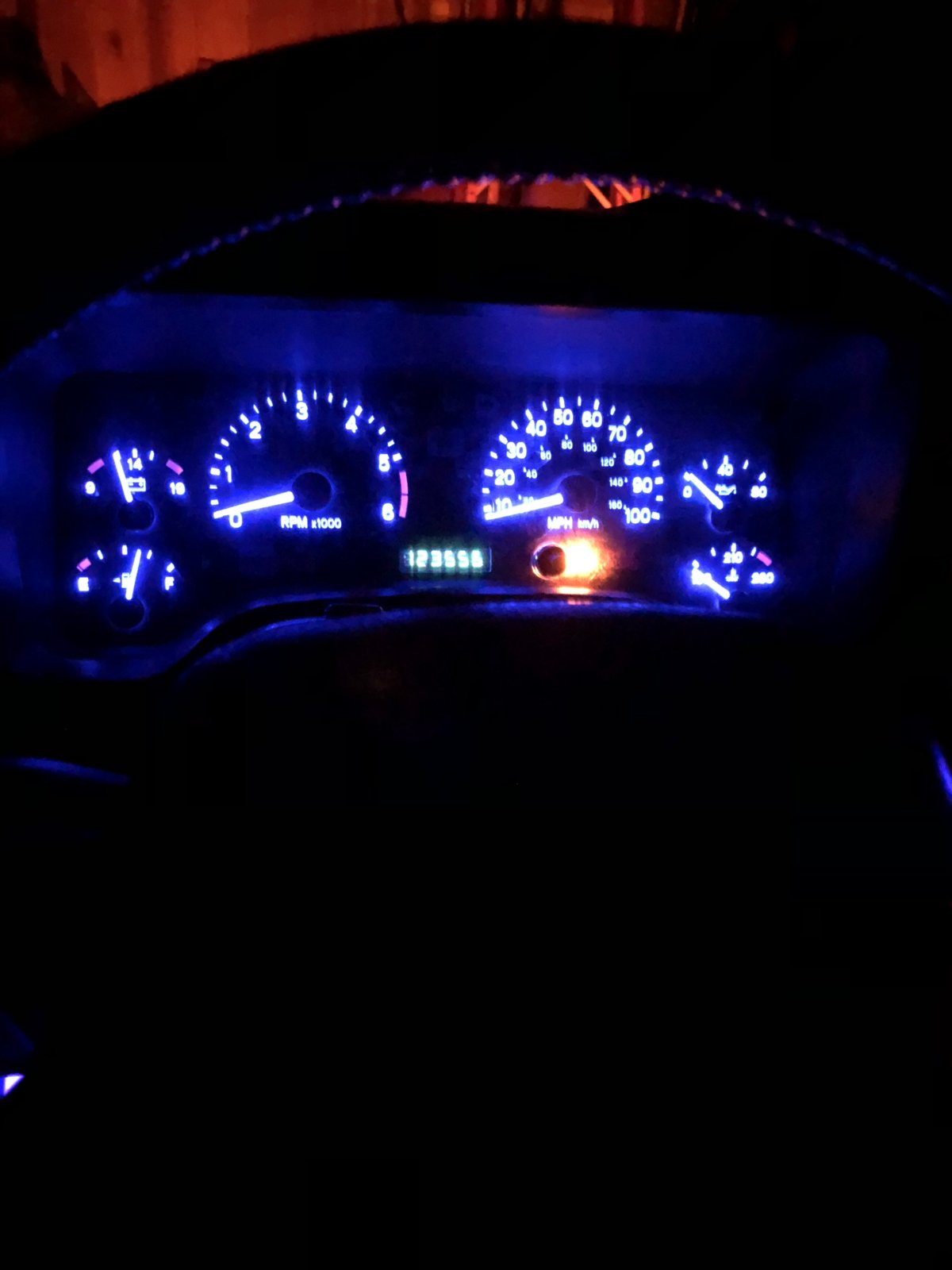

Just finished installing the blue led interior lights if anyone is curious what the blue looks like, here are some pics. The blue shows up a bit blurry and blinding in the camera but looks great in the TJ. Thanks @Chris for this thread, very pleased with the outcome!

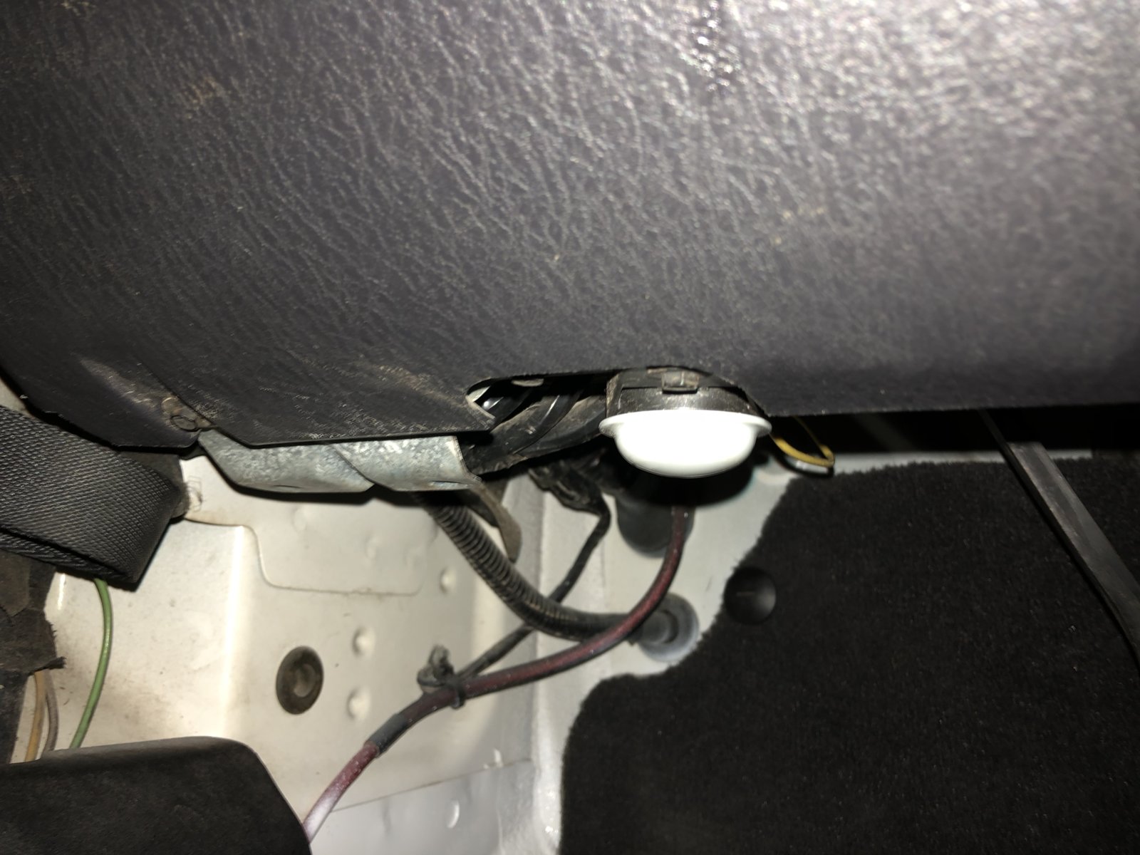

If you’re asking where the footwell light is to replace with an led, look at the attached image. It’s simply held on with a screw.
