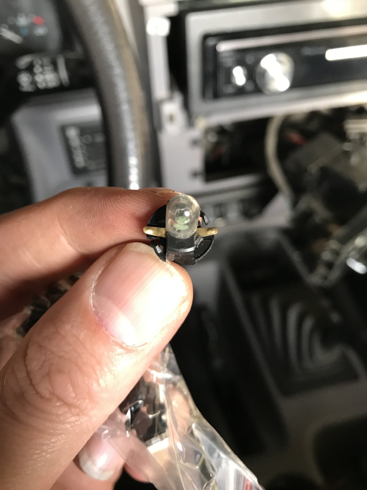

Nope. But the hvac bulb looks like this:
That bulb looks a bit larger than the NEO4. I'm guessing it could be a NEO5 (5mm). Did it twist out with a quarter-turn?
