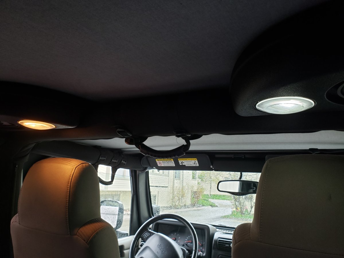

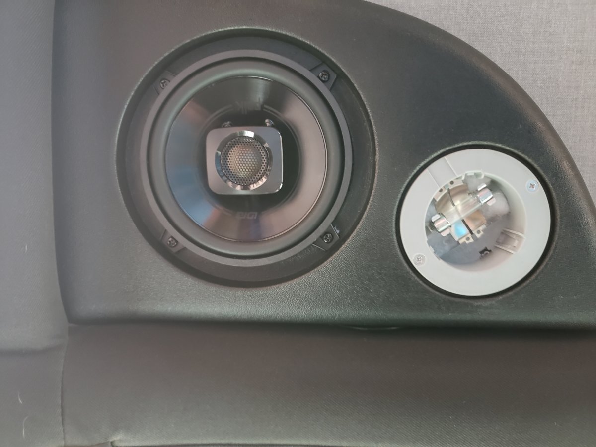

Updated the overheads with cool white, and dash panel, climate & floor wells with red. The dash and floor looks great, but I'm not sure I'm sold on the red climate knob backlight.

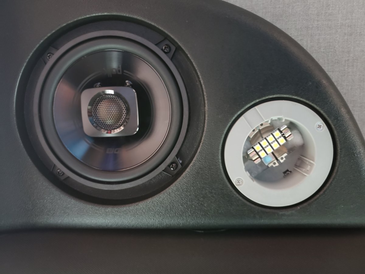

I'd done this swap before in my old Ranger pickup, and it wasn't much different in the Jeep. Pretty effortless and quick, though I guess this means I'll have to upgrade my stereo to make the colors match.

  • There are a few differences for the '97-'02 models. Cluster and rocker switches are the same as above. There is only one light in the soundbar, and that is the same as the footwells/shifter as shown above. There is a separate light in the rear of the hard top, and that is the same as the lights in the sound pods as shown above.

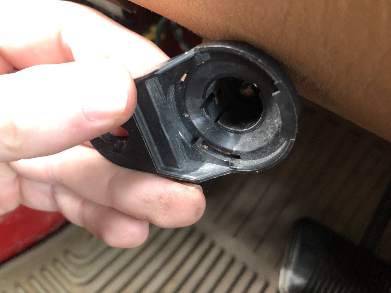

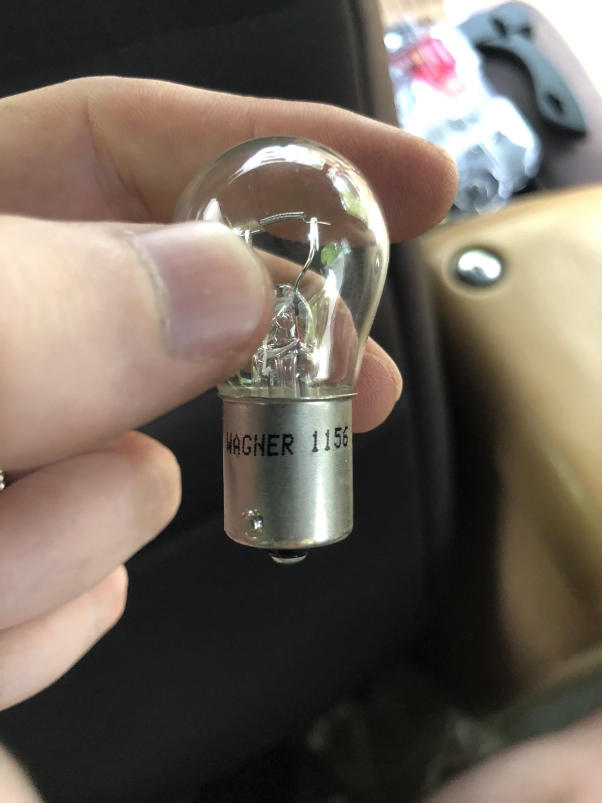

Hey, thank you for the write up. On my 1998 Sport, the instructions for the instrument cluster worked fine. However, there's only one footwell on the drivers side ( at least that's all I could find anyway ), and the LED bulb does not fit.

All you would need for that is a 1156 LED bulb such as these ones:

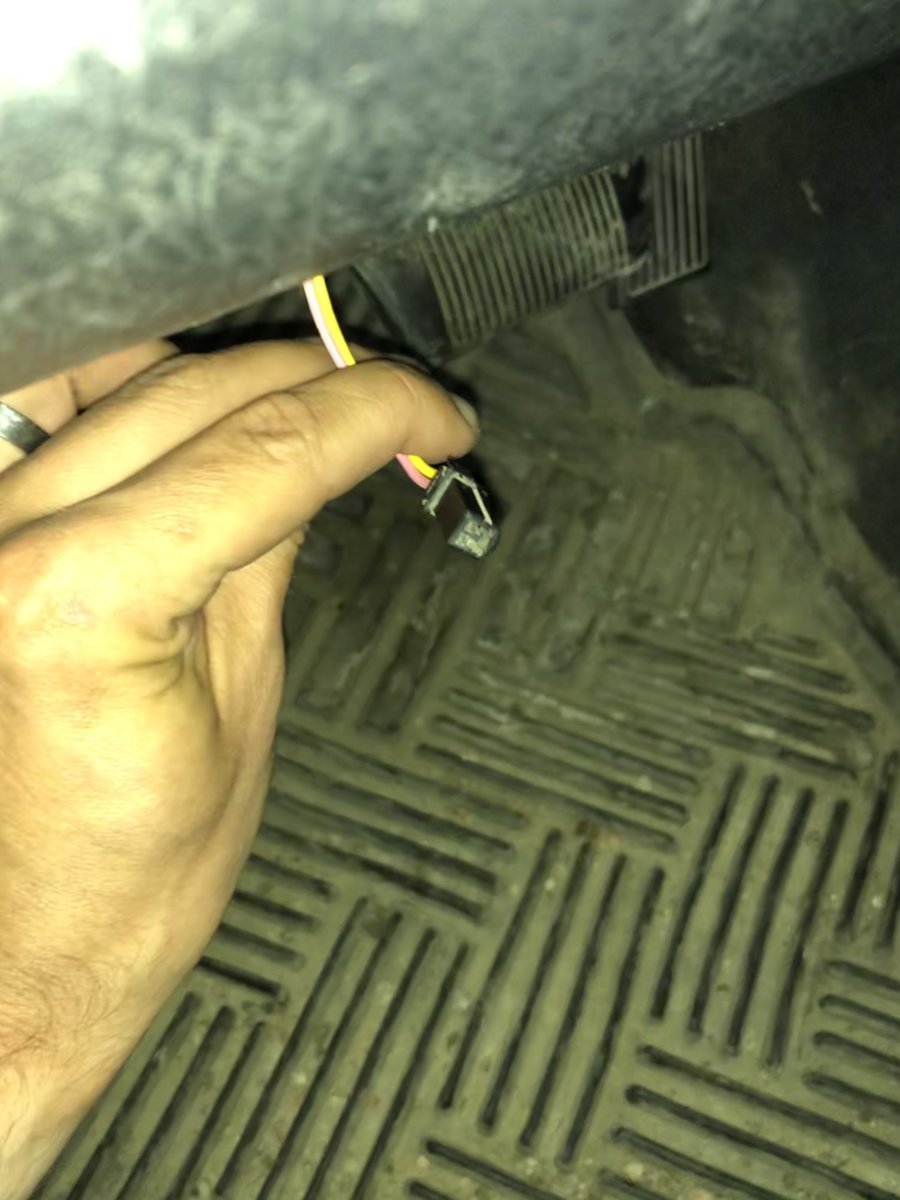

I do have two of these unused connections on both sides in the footwells. Green and yellow are the wire colors. If that helps anyone?
Those are the connections for the footwells lighting, check to see if they have power when your door is open, if so use them. If not it is probably a matter of inserting a missing fuse.

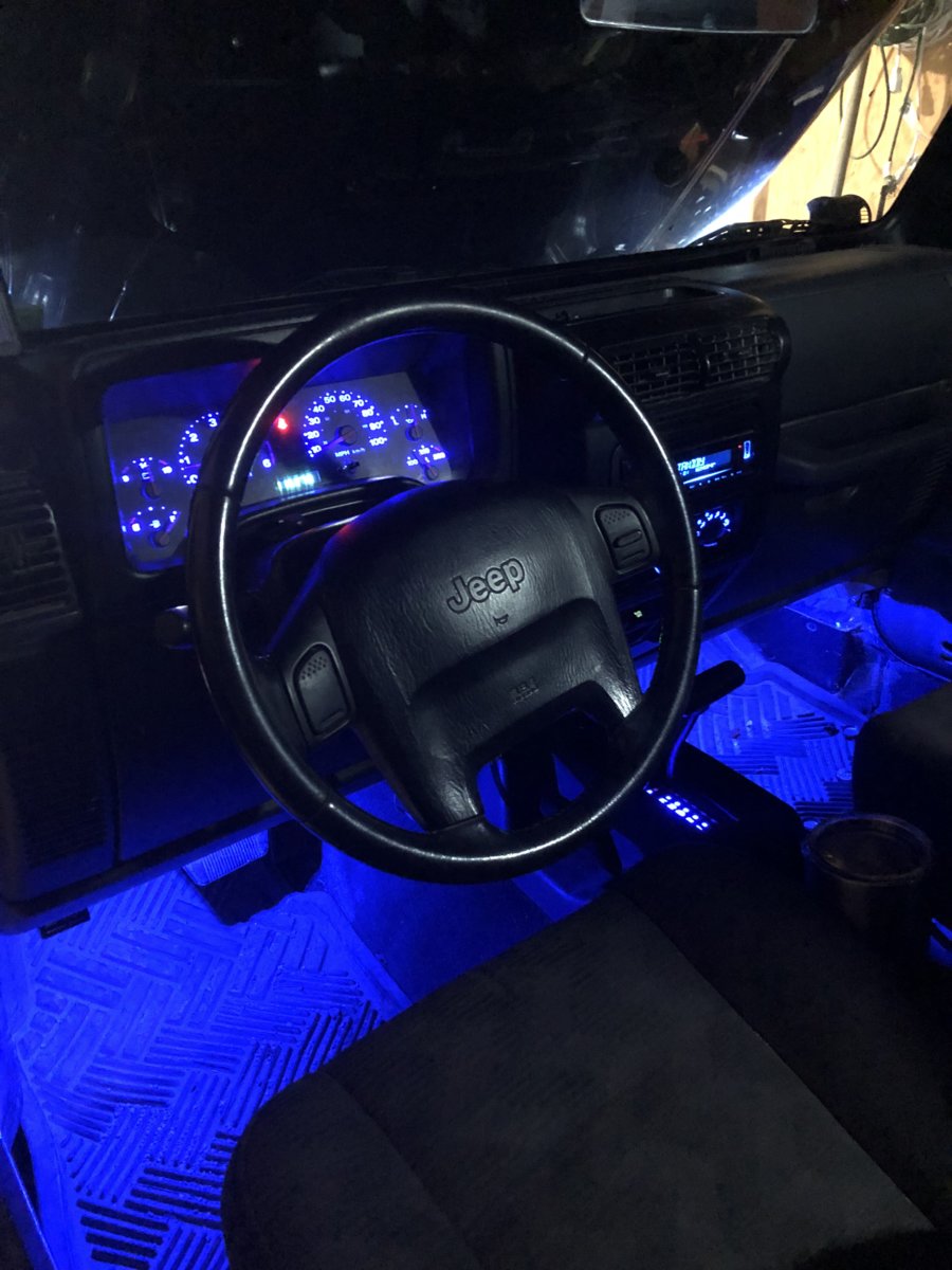

Awesome looks great! Almost thought that was my Jeep, looks almost the same! I think the blue looks great
Thanks dude! I kinda felt obligated to go with the blue lighting beings my Jeep is patriotic blue. Really ties things together. Now if they’d only make some American flag seat covers, American flag floor carpeting, and an exhaust system that howled “These colors don’t run” I’d be about done with mods. LOL

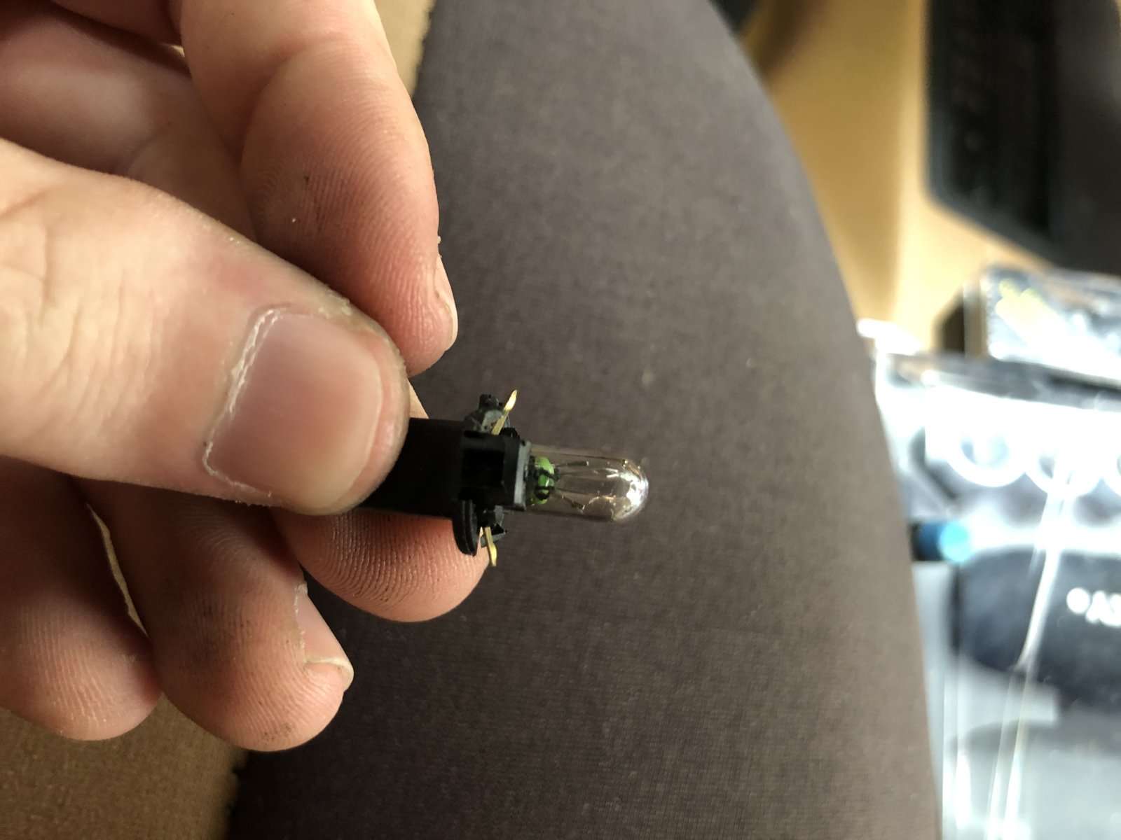

I think you need a number 74 for the slider controls and a number 67 for the foot wells. I bought mine from superbrightleds
