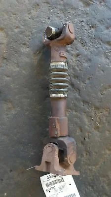

I’m looking to replace the u-joints on the rear drive shaft of my 2003 Rubicon. This drive shaft mates up to the 241OR transfer case.
My question is do I need to melt a plastic retaining ring to remove the drive shaft? I know this is a common feature on GM vehicles. The white plastic nipple sticking out of the drive shaft is what is throwing me off. See picture.
My question is do I need to melt a plastic retaining ring to remove the drive shaft? I know this is a common feature on GM vehicles. The white plastic nipple sticking out of the drive shaft is what is throwing me off. See picture. View attachment 103809View attachment 103810
Is that a factory driveshaft? I don't see the external snap rings like I have on mine or what is called out in your manual:
