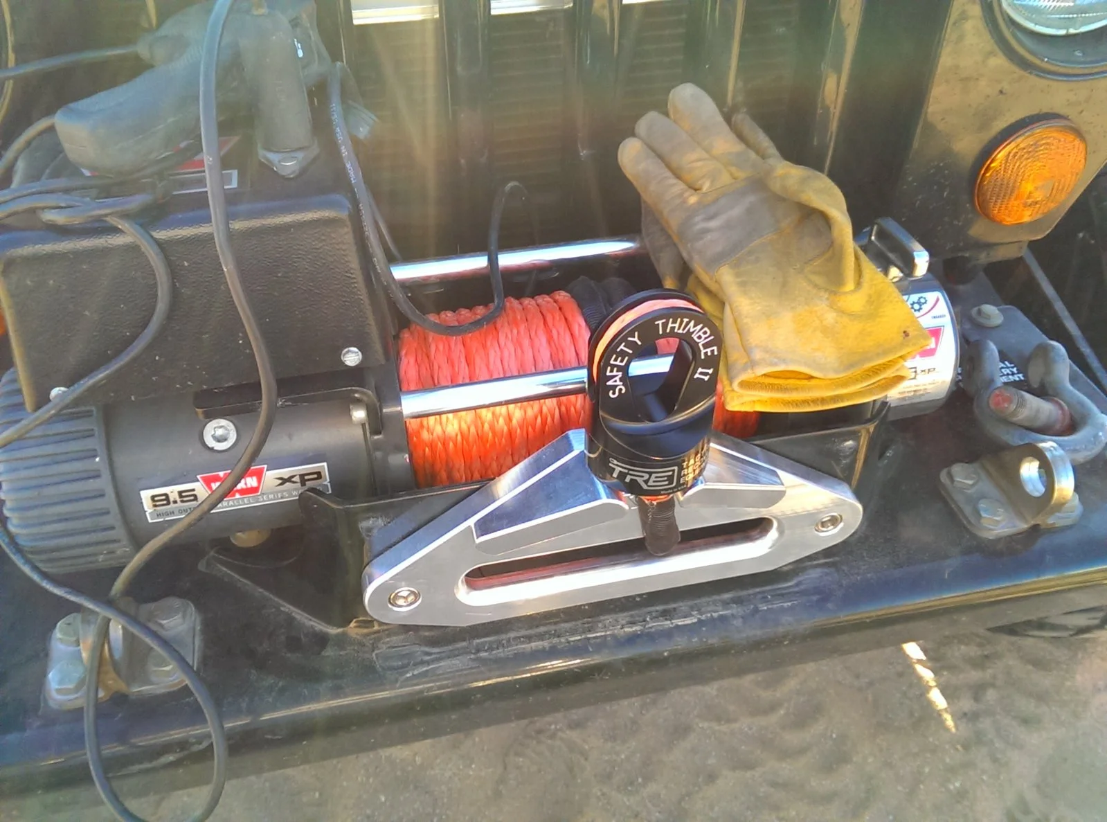

3/8" is a good choice, the Safety Thimble (developed by mrblaine) would be a good choice as well. This is where I obtained my last 3/8" synthetic rope from, it's a good source owned by a Jeeper. Check their ropes out at https://www.4lowparts.com/shop/product-category/tre-tactical-recovery-equipment/
I've had blue and orange, I prefer orange since it's so much easier to see in all lighting conditions. That hawse from 4LowParts.com is designed to hold the Safety Thimble up & out of the way so it doesn't get in the way of a steep approach angle.
Make sure you inspect your Roller Fairlead for any nicks, gouges or burrs as they can damage the synthetic line or consider swapping it out for a Hawse fairlead.

A grinder or file makes it easy to smooth up an existing gouged up roller fairlead to make it safe for synthetic line.

Is your connector better/safer than the Safety Thimble? The Safety Thimble is hard to beat, not to mention its developer is mrblaine aka Black Magic Brakes who is a regular contributing member here.
I will second the 4lowparts winch line. Bought some orange line a few months ago and am very happy. Some of the best prices you'll find and great customer service. Also, I think you should seriously consider the safety thimble. It's a genius design if you understand some of the basic rules of rigging (and no, I'm not saying that to brown nose Mr. Blaine) and it is different than the factor 55 "thimble", which is just a glorified, expensive hook in my opinion.
