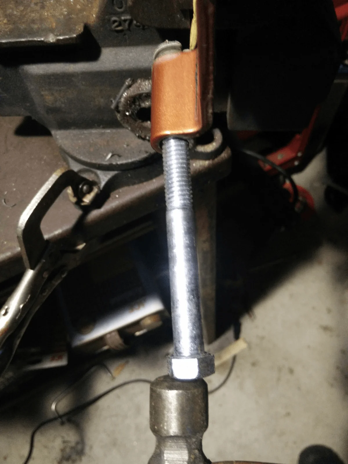

1) Place it in a vise and, using an appropriate sized bolt, dowel, or whatever, drive the OE bushing out.

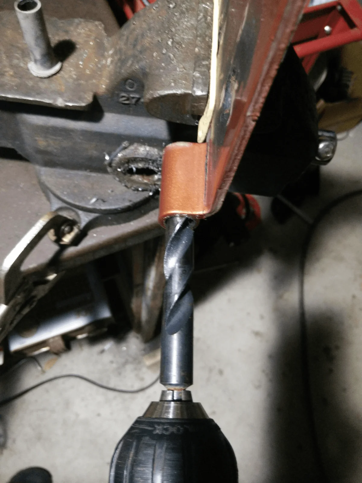

2) Using a 1/2" bit, drill out the opening of the hinge half to accommodate the bronze bushing. Be careful with this step, you don't want to wallow out the hole as it needs to be very close to 1/2". If you have a 1/2" reamer, you can drill the hole at 31/64 and ream it out to 1/2".

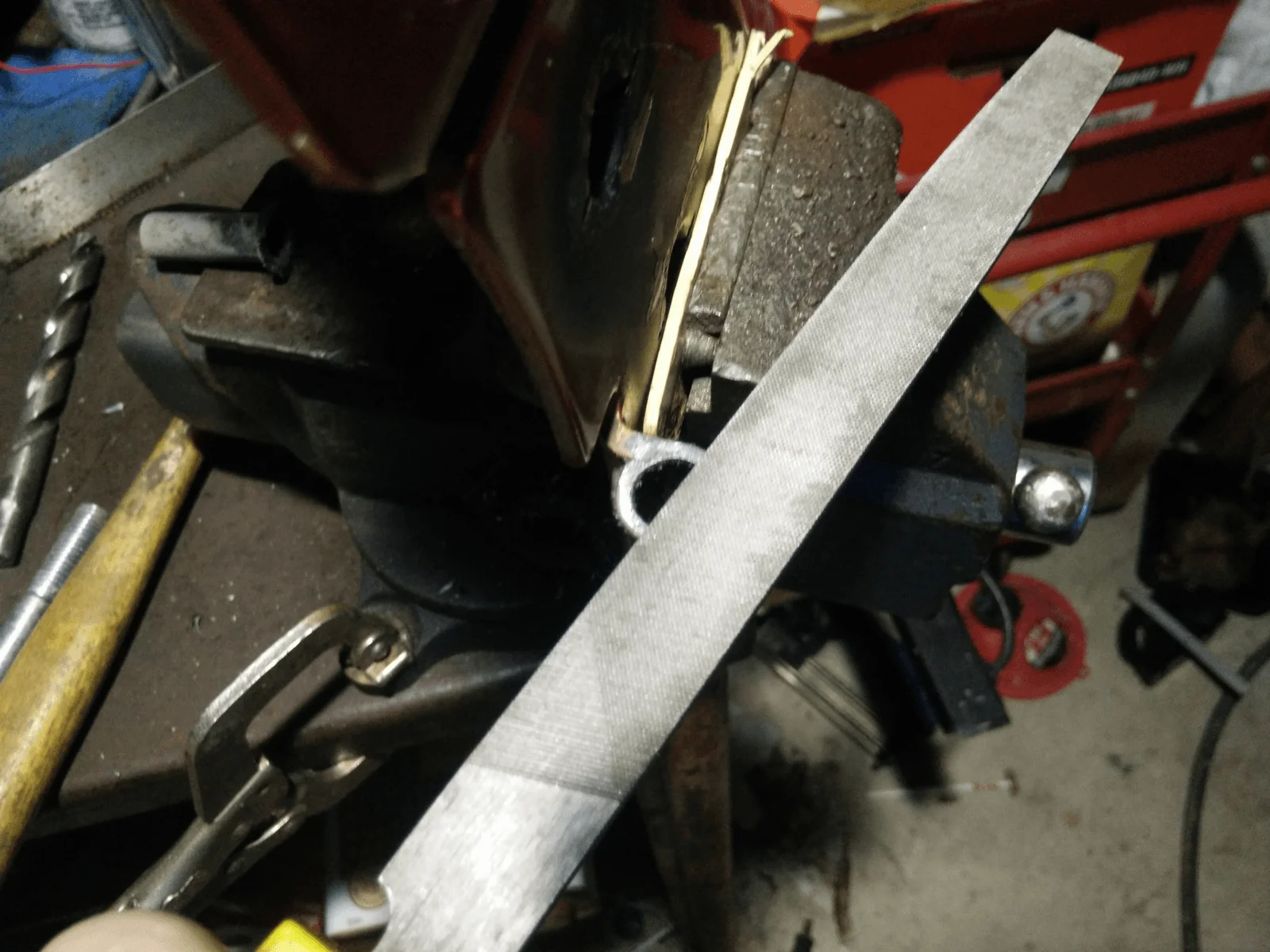

3) Next, use a file to clean off the top end.

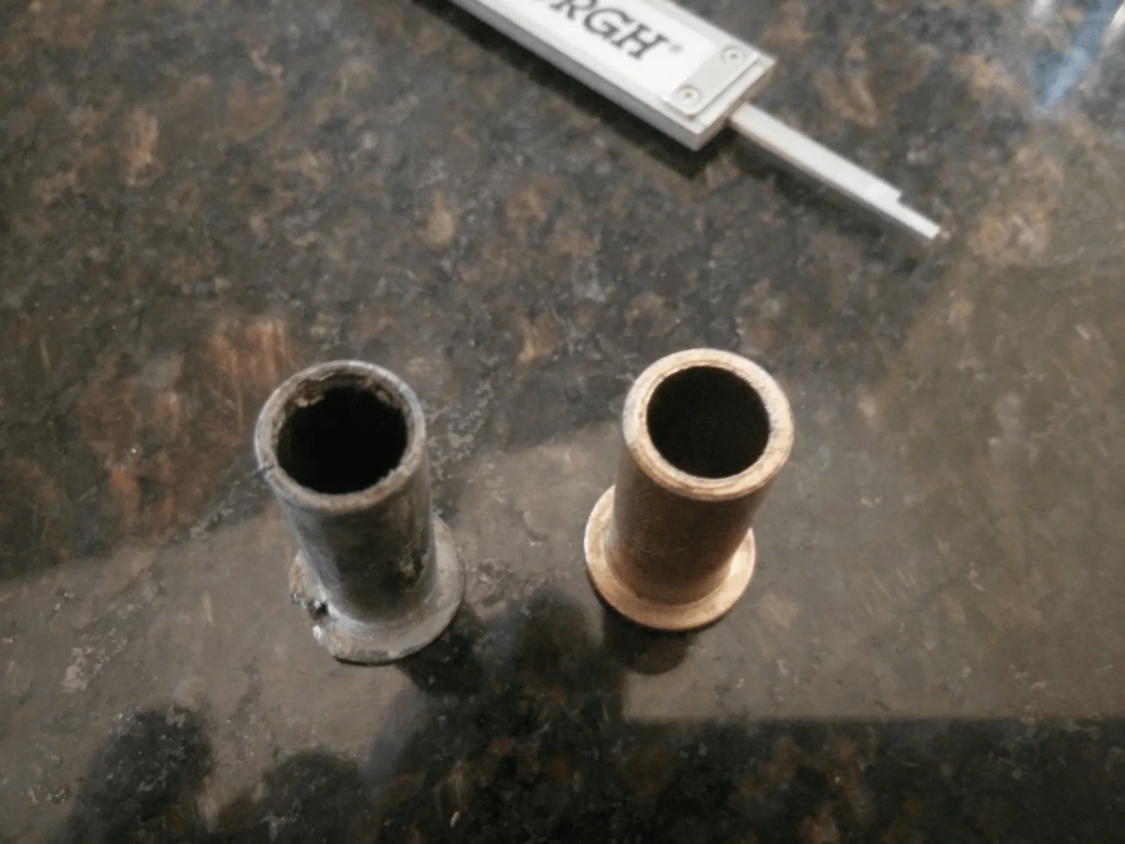

4) Finally, carefully insert the new bronze bushing (don't put in upside down :)). Again, you should take care in this step in order to keep from deforming or breaking the bushing. If your vise jaws open wide enough, you could use your vice for this, or a press if you have one, or, as I opted for, mount the hinge half back on the TJ and use a hammer and a block off wood to carefully run the bushing home.

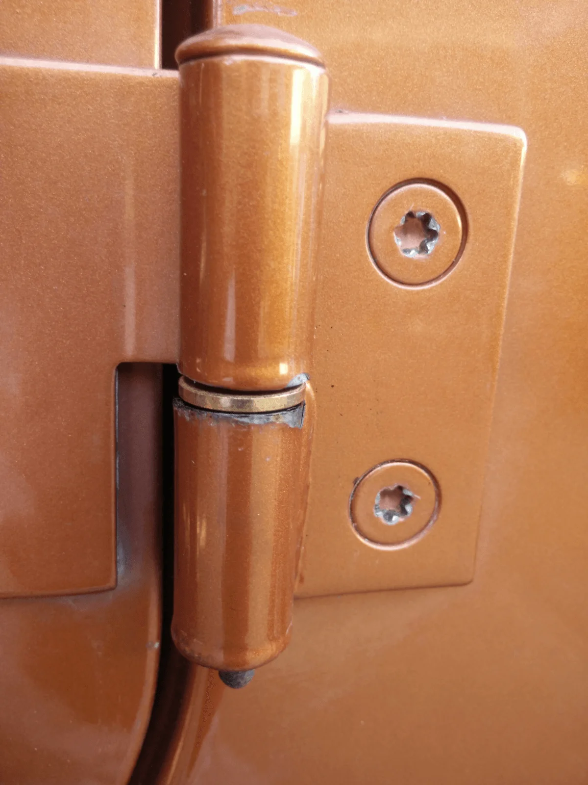

Not sure what year they changed from the cast hinges like these on my '01:

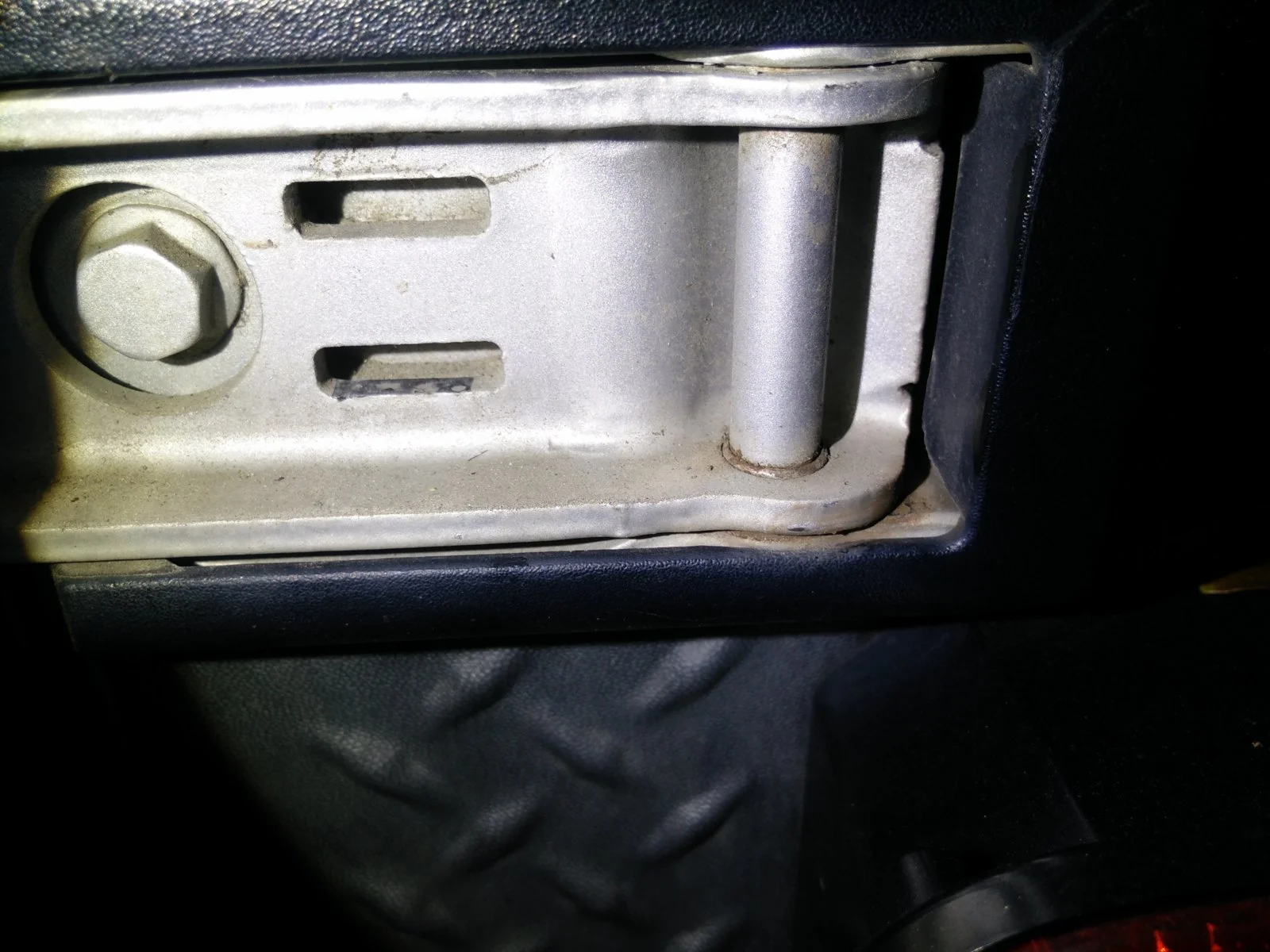

to the stamped steel ones like these on my '06 (one of the plastic covers removed):

In the case of the cast ones, the magnet test shows that they are non-magnetic so probably aluminum or an alloy. I'm not sure I feel great about the chances of the pins holding after pressing them out and back in.
For the stamped steel ones, they appear to have bushings of some sort from the factory an, if a bronze bushing of the appropriate dimensions is available (certainly looks possible), then you could always do a tack weld on the pin to keep it secure after re-assembly.
