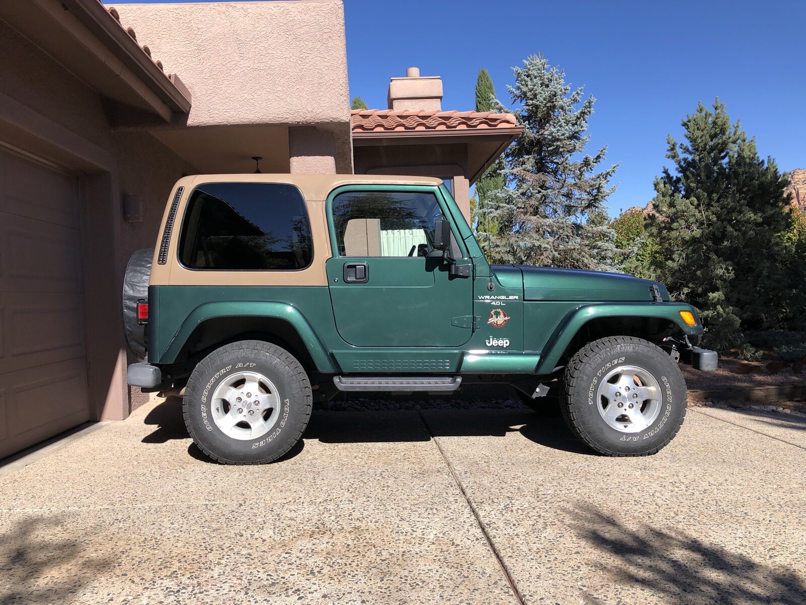

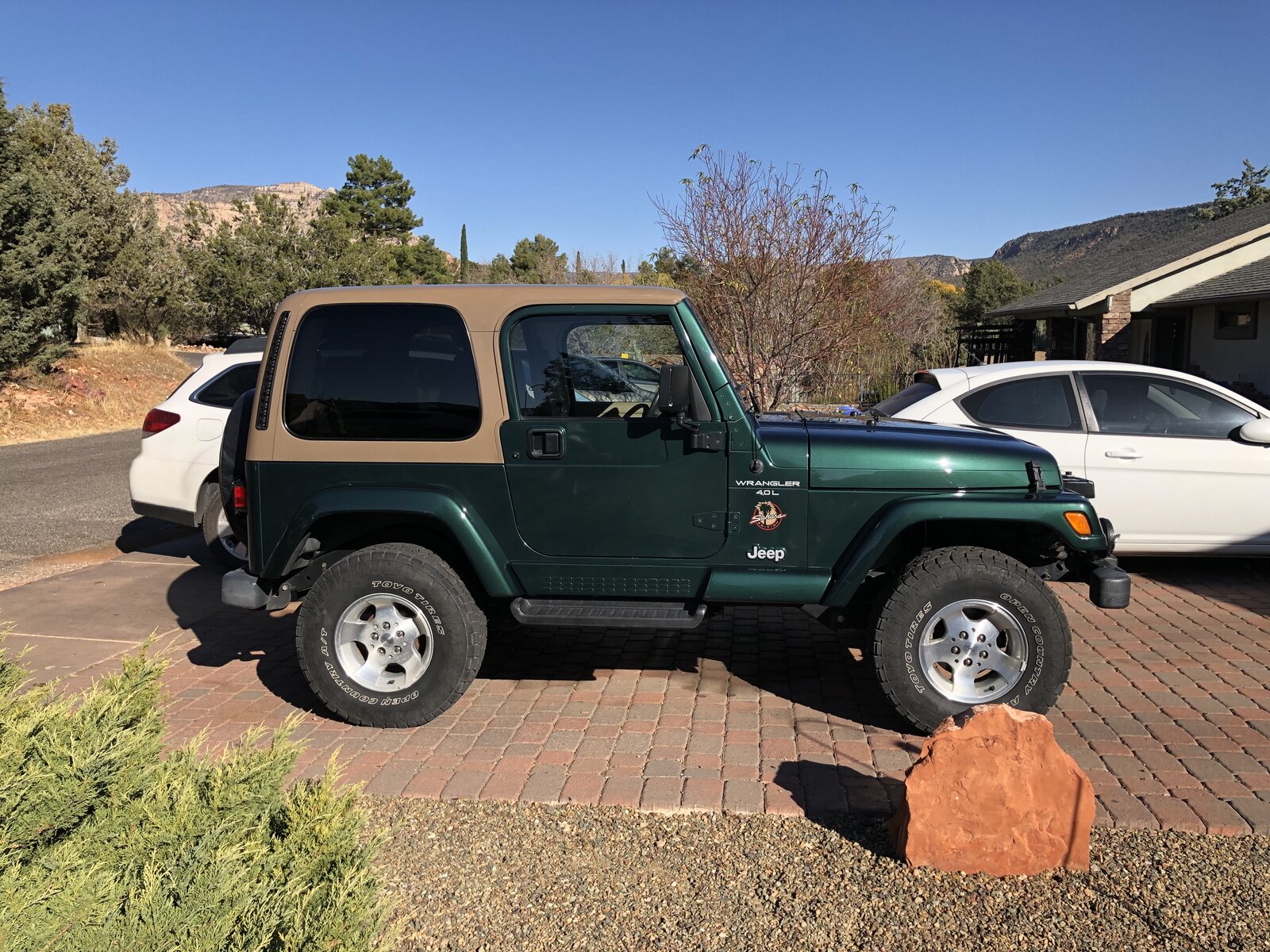

Before and after with Penetrol.

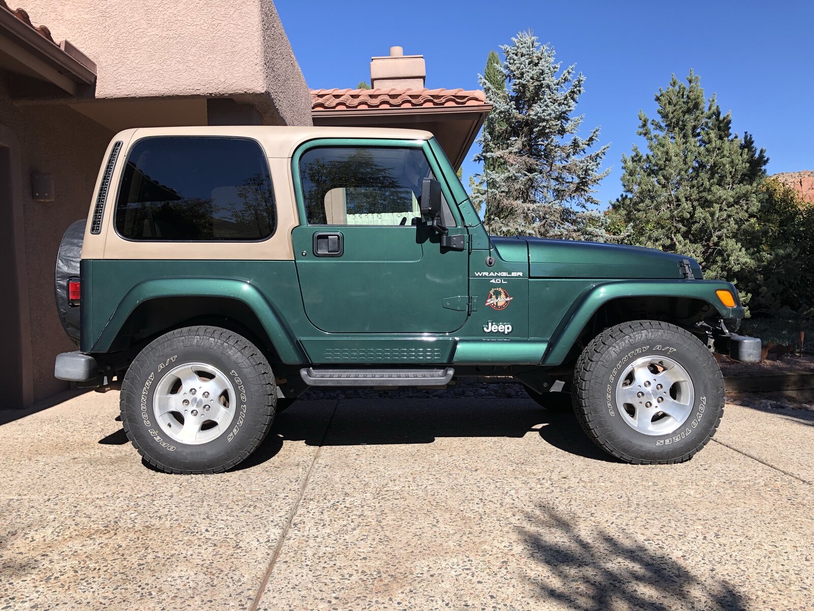

And then after buffing.
Gotcha, thanks. Ok, I'll keep this in mind when I get to the Penetrol step. For now I'm just wondering how much different to expect from the erasing step.
Also, just curious if the buffing process gave it a darker look, or if that's just a difference in the lighting between your second and third pics?

There have been good results with both. I like penetrol because it adds oil back to the paint vs removing oxidation.
The buffing definitely added color. And it cleaned up the streaks from wiping on the penetrol.

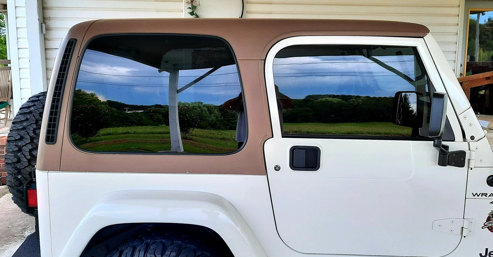

Just wanted to post an update photo to show what the top looks like 2 years after using Penetrol. Took this picture today. Still looks great with no oxidation.
