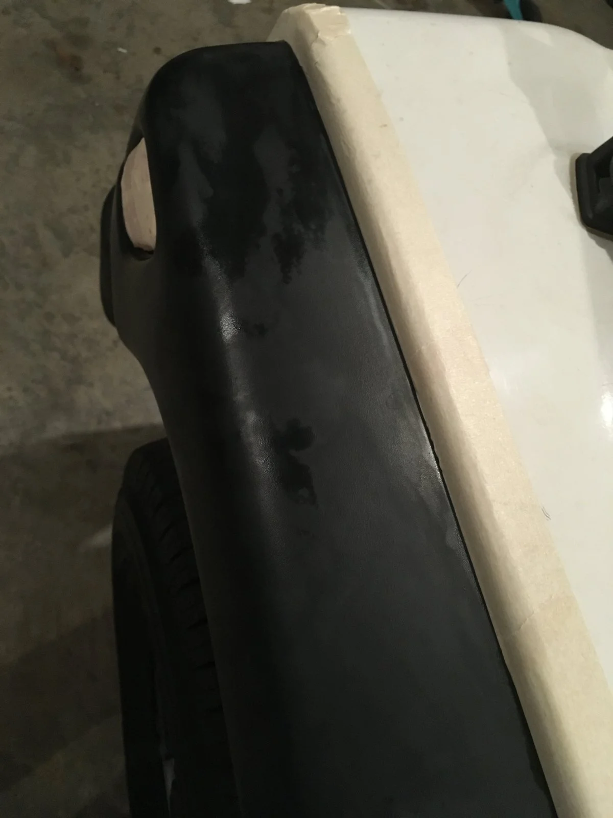

Hey guys, new here. I have tried to restore my plastic trim on my 2000 Jeep Wrangler. I used a heat gun and did it just like the videos showed but it’s very spotty. I’ve done multiple times. I can’t figure out what I’m doing wrong. Any suggestions?

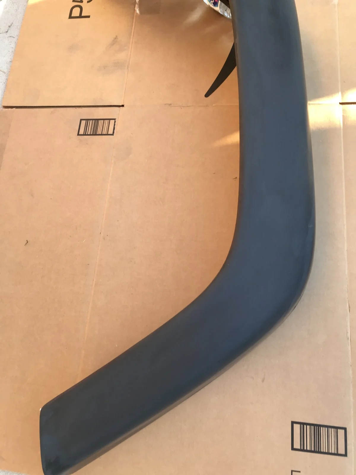

I used a heat gun when I used to run flares and it always came out nice. I used the lower temp setting, a heat gun's high heat setting is too hot.

I didnt clean it. The video didn’t say to.should I clean what I’ve done and retry? I uploaded photo. What heat setting did you use? What do I clean with?

The area should be cleaned, soap and water with a scrub brush will do the trick, I used a power washer and as Jerry stated a low setting is preferred.
