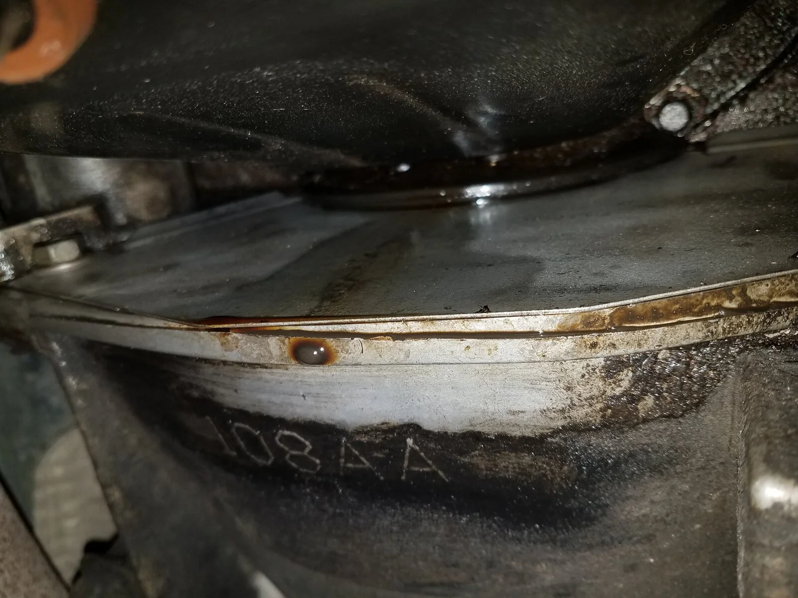

Came back the next week, parked it in the garage and find this...

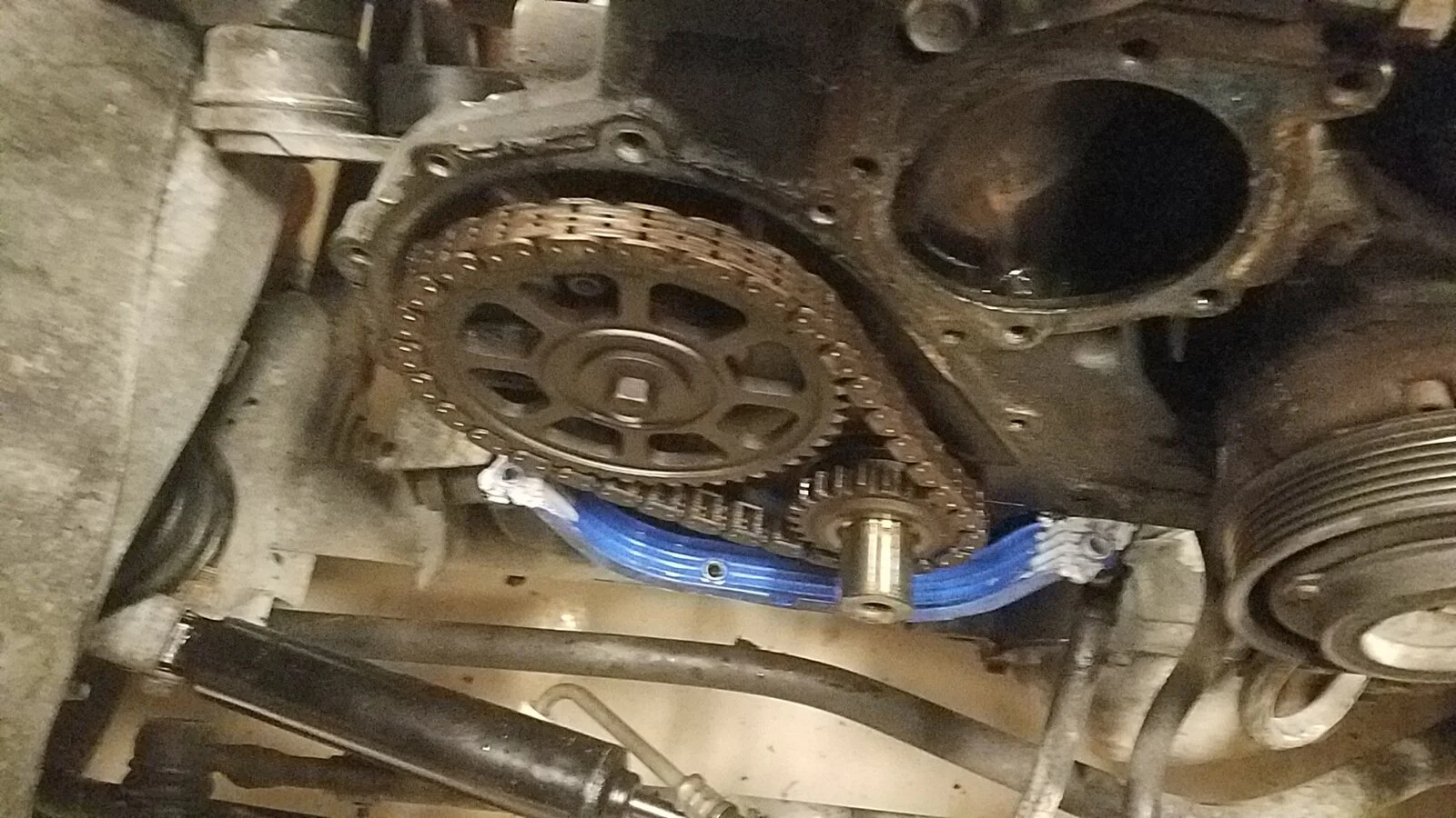

Changed out the valve cover gasket just in case, but it was the rear main seal.
One new oil pump, pan gasket, two rear main seals, no oil pressure (because of oil pump shaft priming), 5 gal of synthetic 10w-30, and an oily floor it was done. While working on the rear main seal I found a progressive coolant leak dripping by the rear main seal and a oil drip on the front of the engine so the front of the motor came apart. Also had the radiator steam cleaned.
A timing chain cover gasket, water pump, thermostat (205 I think), a bunch of gasket maker, and 10 gal of antifreeze (even though it won’t leave Florida), and a new mess I was done with coolant leaks and oil spills. But then there was a oil leak by the rear main seal and I died on the inside but it turned out to be the oil pressure sender line.

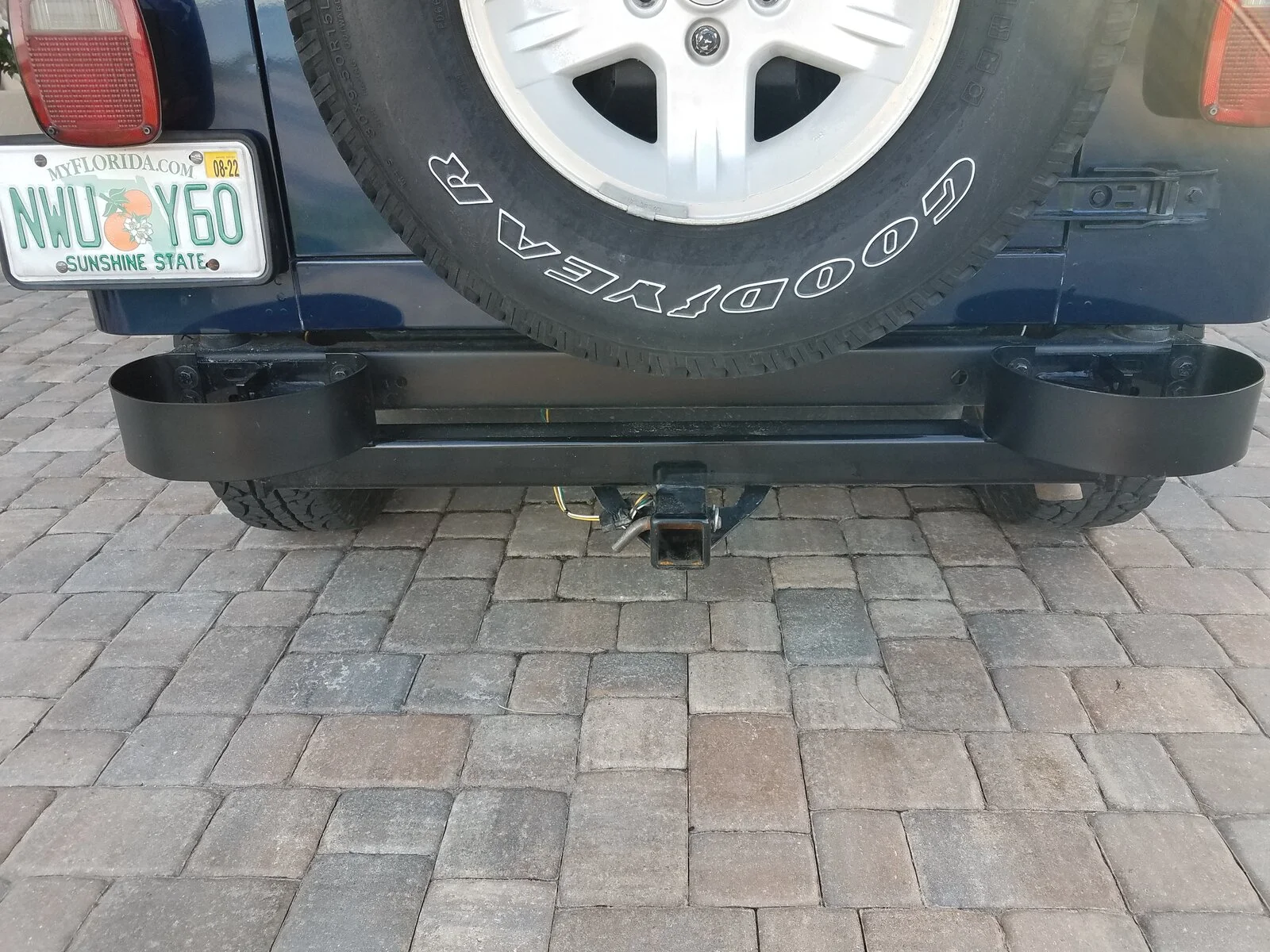

I got rid of the factory rear bumper for a overbuilt tow bar and some bumperettes. Don’t shame me I like the look of them and they also protect against the snow birds.

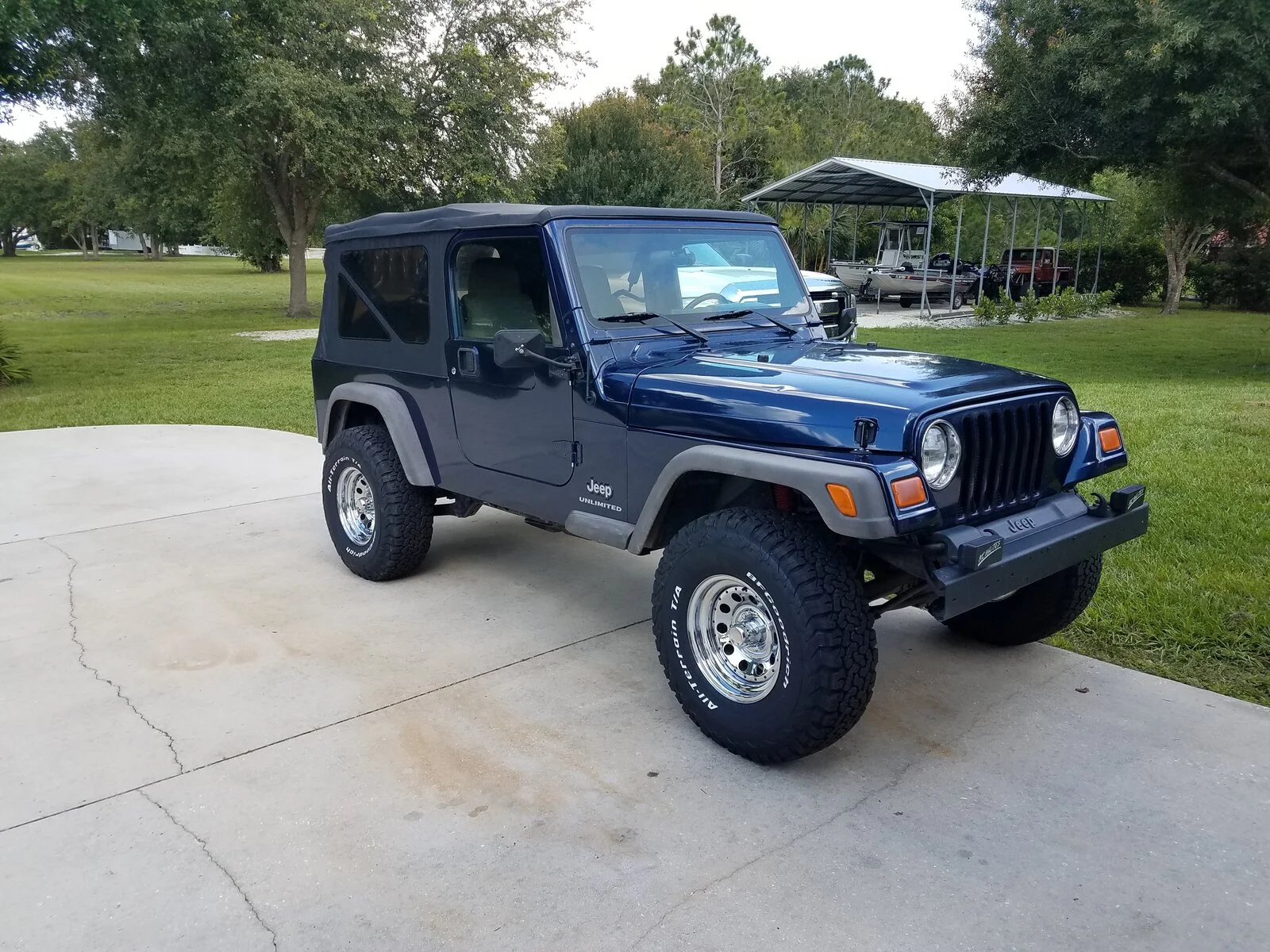

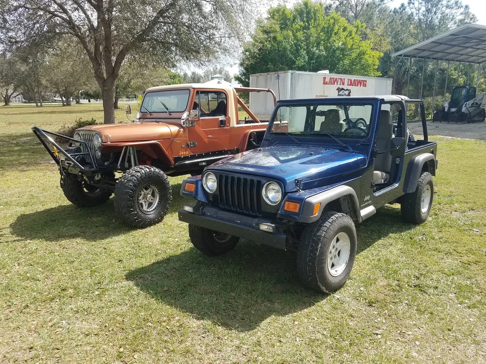

We have 3 Jeeps (4 now) so I need to come up with a name instead of blue Jeep. I was thinking of Stockish because that’s how I plan to build this one. Overall, I want this LJ to look factory and perform well off-road but also be a good daily driver. Not a weekend warrior but an all around well built. This is going to be a budget project and will contain a lot of mismatched parts.

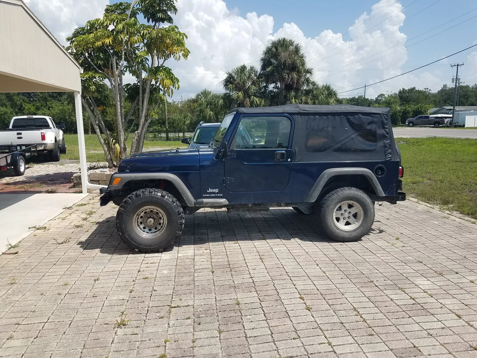

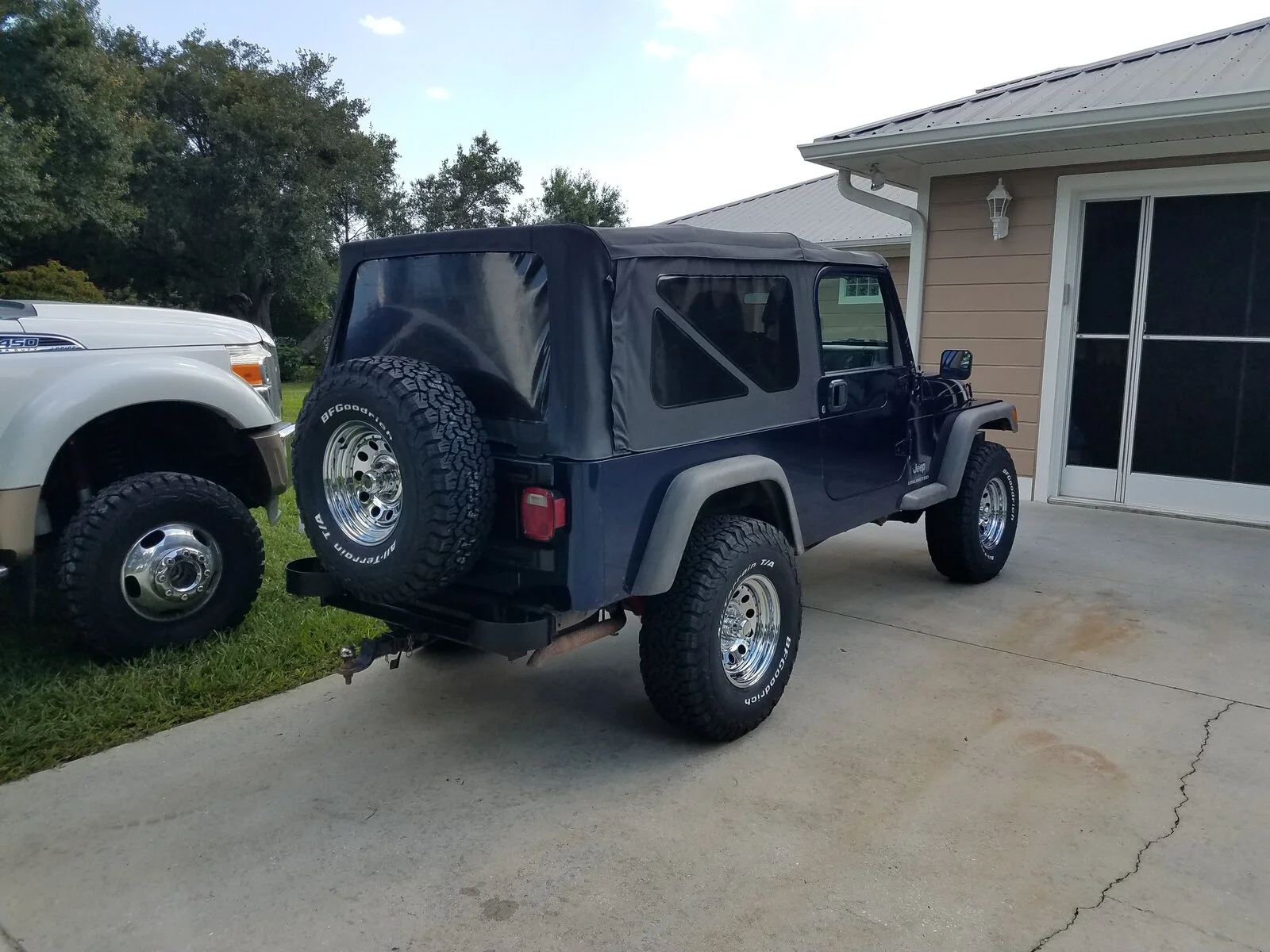

Up to date pic.

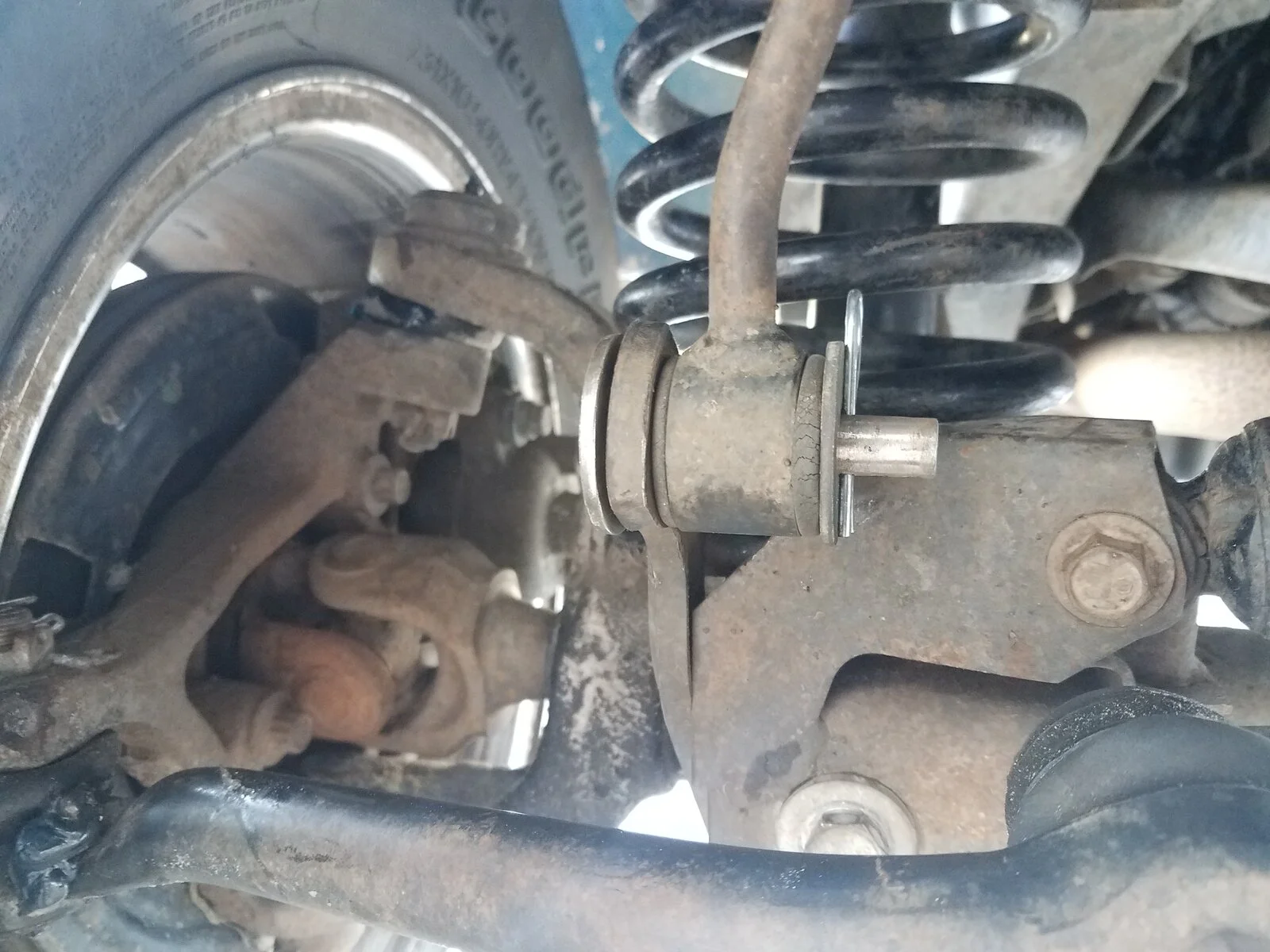

Made some budget sway bar disconnects and here is that little project.
Parts List:
  • 2x (2 1/2x1/2 Clevis Pins)
  • 2x (1/2 Clips)
  • 2x (Washers)
Had to sand down the 1/2 pins ~2 thousandths. Don't buy the 7/16 pins they are too small.
While doing this I took the springs out and removed the bump stop extensions. I had to take the track bar out to get the passenger side spring out and couldn't get the track bar back in without a ratchet strap. Also, noticed my shocks were way to short and I need some longer ones.

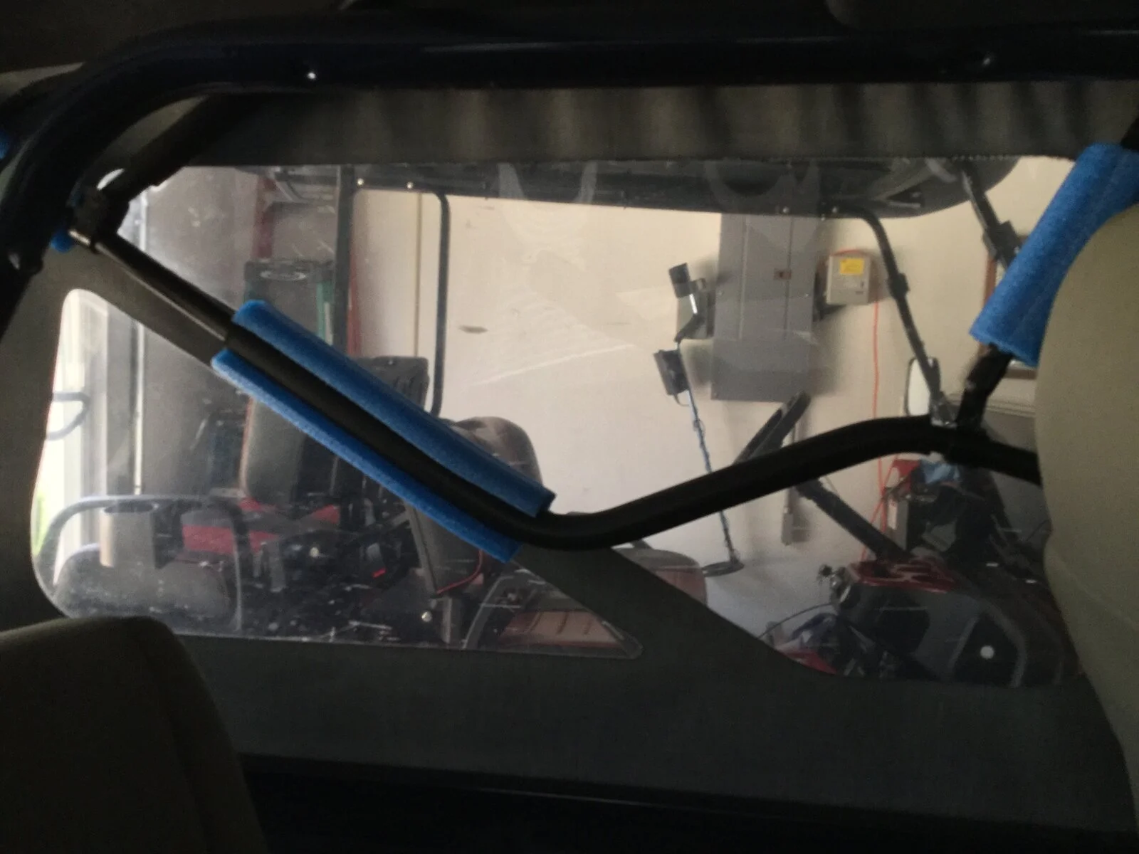

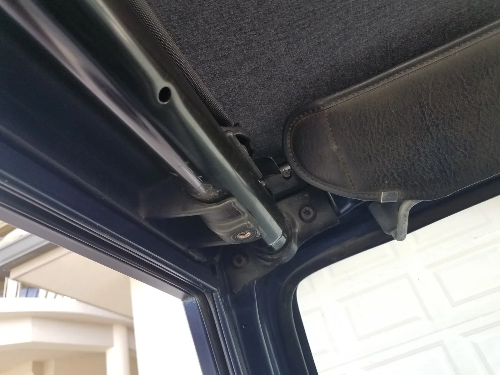

I removed what was left of the roll bar padding.

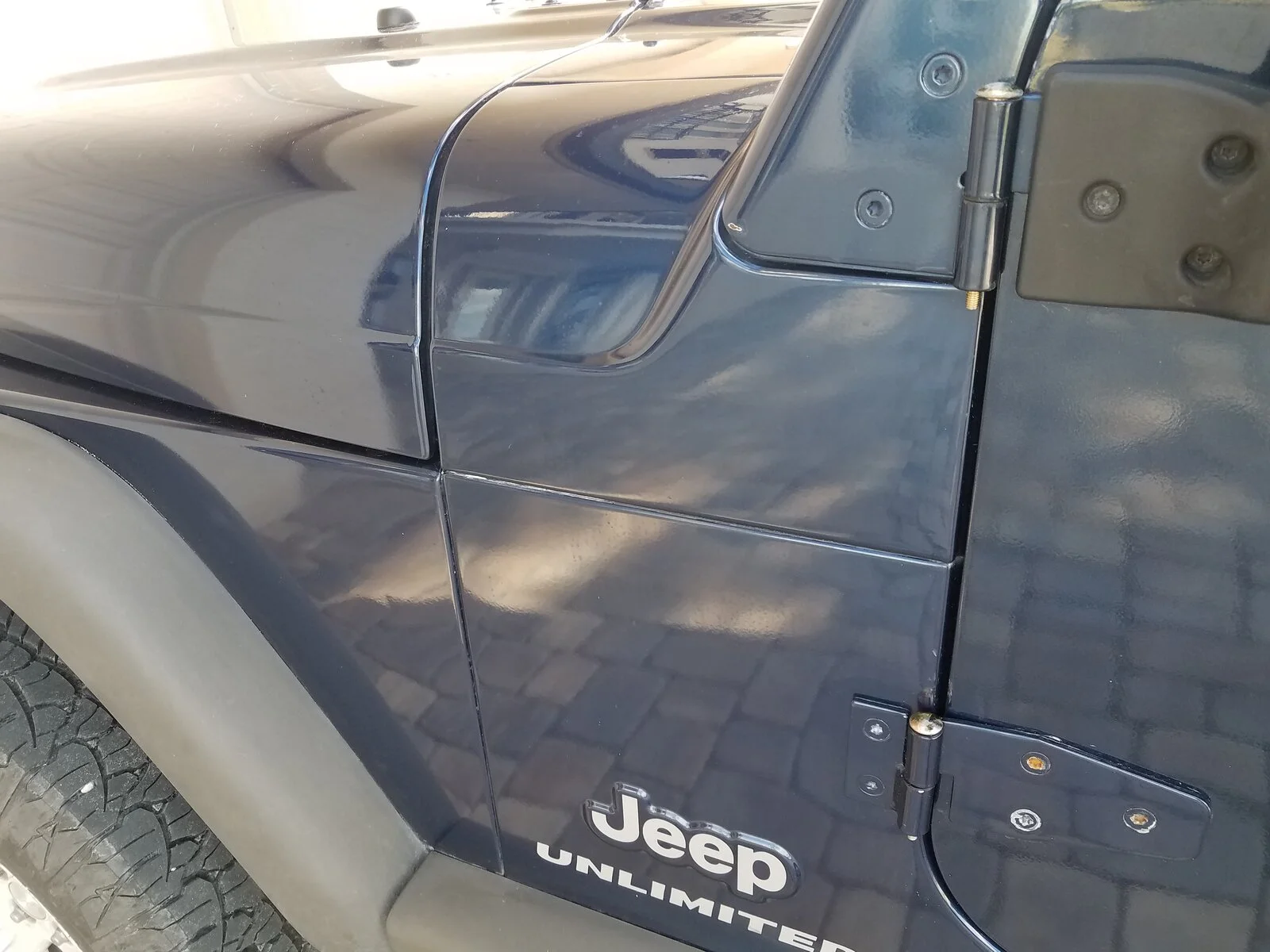

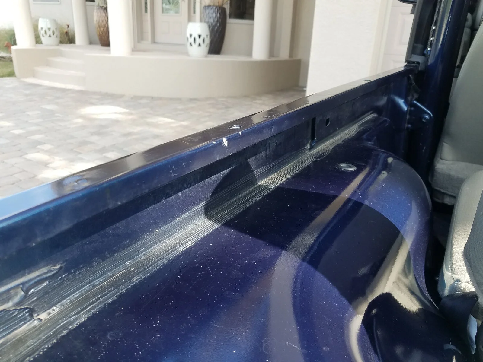

Tucked up the rear wiring and bent tabs. I also used a drill eraser and removed the entry guards, trail rated badge, dealership stickers, and rear tub guards.

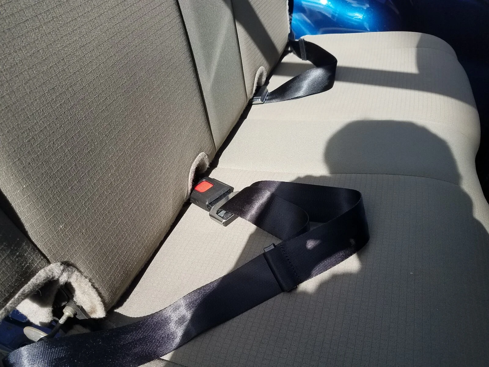

And yes lap belts work fine in tj's.

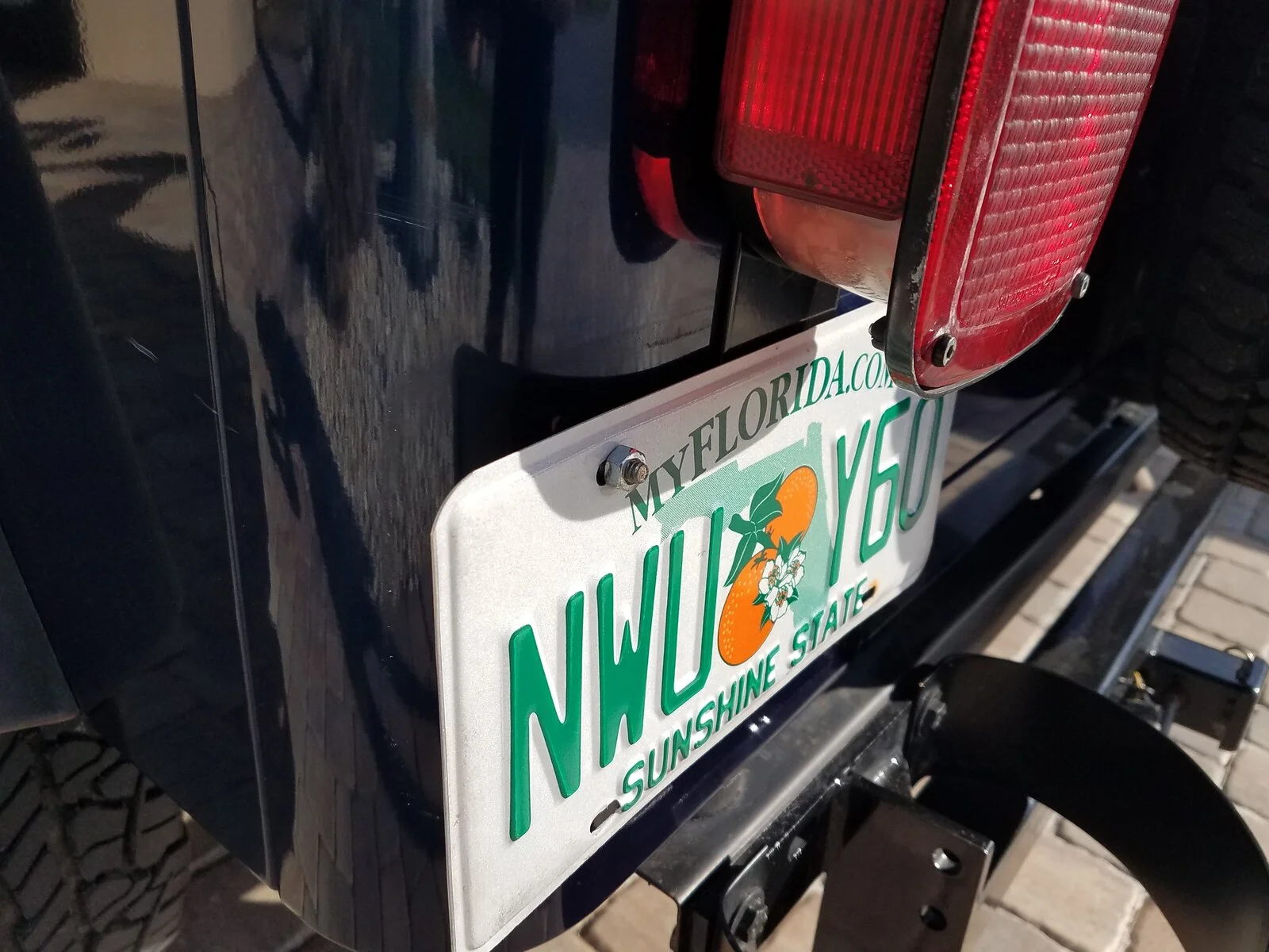

Just ordered CJ/YJ Hood Latches, CJ Style Mirrors, and CJ License Plate Bracket.
Got all of my parts in and started on the mirrors.
Removed the spreader bars, for now.
Put on my CJ License plate mount, had to trim the connector a little bit.

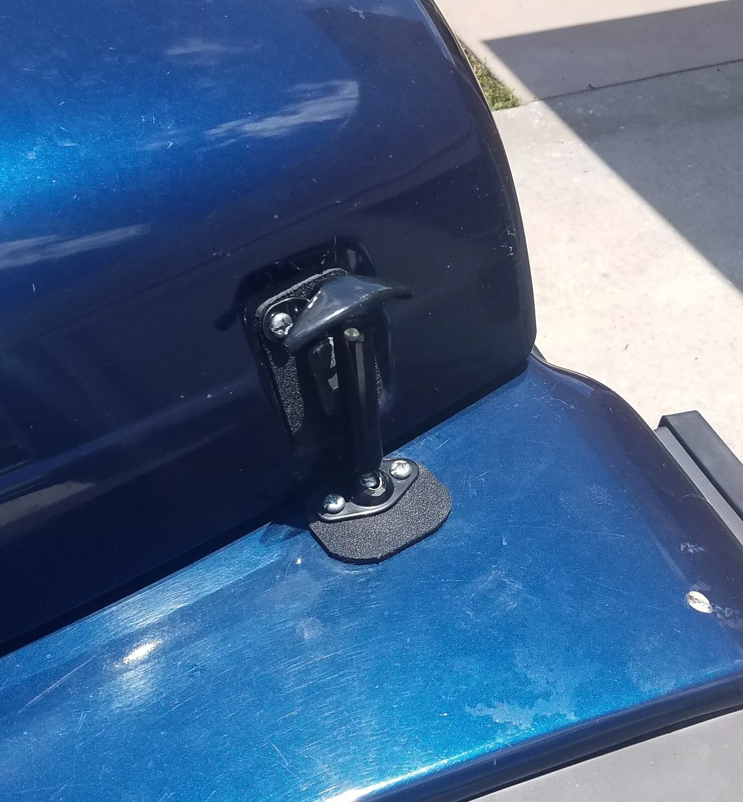

Made some hood latch "guards" that cover the spin marks and clean up the hood.
The CJ style hood latches greatly reduce hood flutter and don’t squeak like most people complain. To keep them from squeaking you have to run them long.

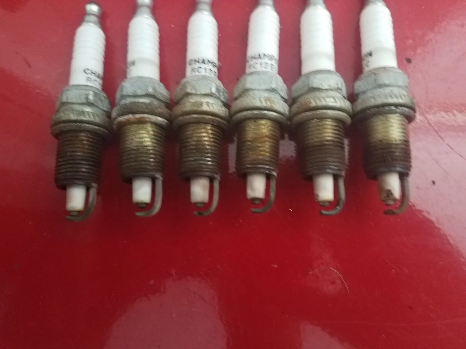

Last time I checked, spark plugs had gap right?
One of these is not like the other. Looks like I'm getting a 6cyl now, not a 5cyl. Number 1 was not very pretty and they weren't double iridium tips. I'm thinking this jeep never had a service since around 100,000 miles. Getting my tractor up to over 100 horse. Still have a bad computer, thinking my o2's shorted out.
