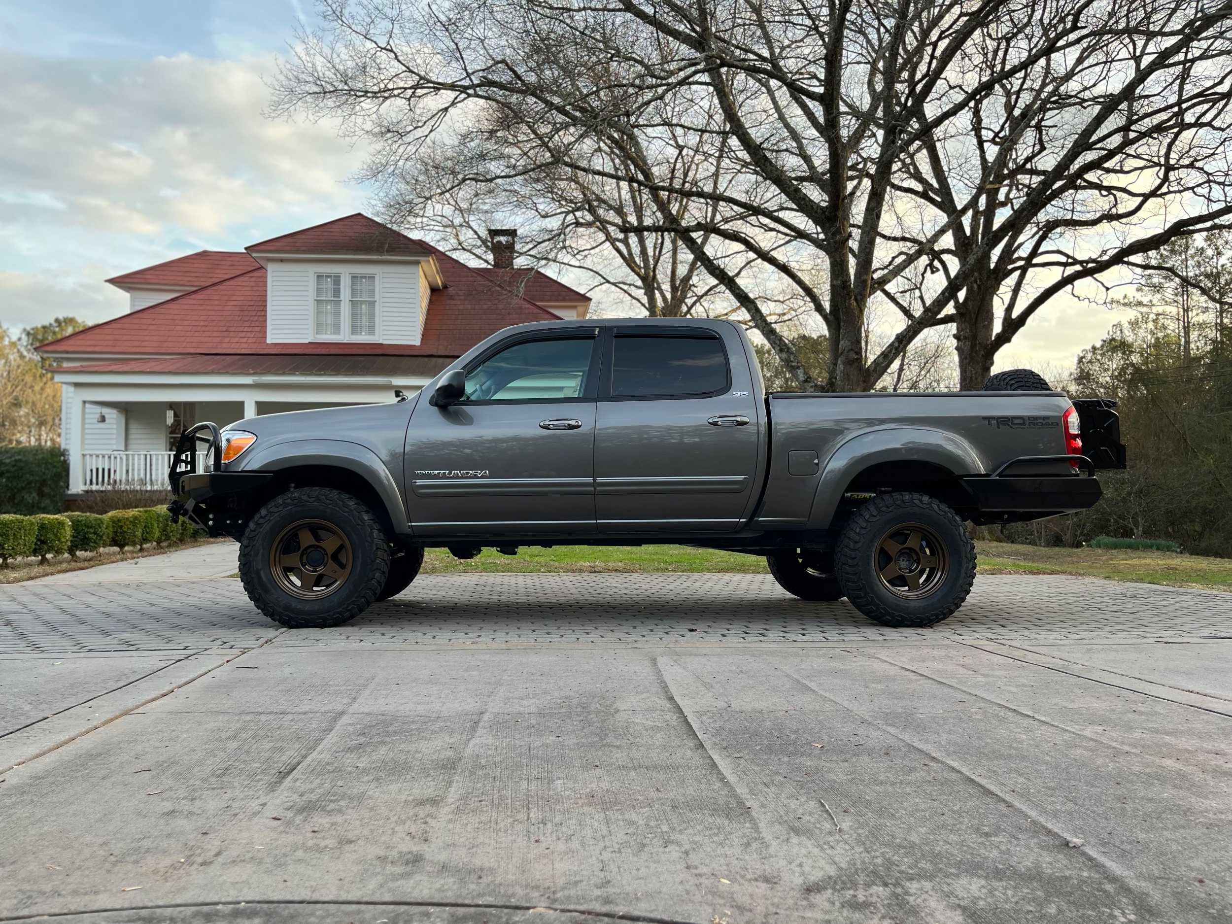

While I haven't spent a ton of time under a TJ, Ive been in the Toyota game for a long time. My most recent 1st gen Tundra build took a year and hundreds of hours trying something, then tweaking it and trying again. I went through several suspension set ups and ultimately ended up with what I would consider a near perfect set up, which required pulling the rear axle and having custom lower shock mounts fab'd, pulling the bed and installing a new crossmember with upper shock mounts, and having custom shocks built by Arizona Desert Racing and leafs from Deavers. It was a lot of fun, but with an 18 month old and a 3 year old keeping me busy, I don't want to take on a project like that right now.
I say all that to say I know how much of a difference the "right" shocks can make and respect that shocks and spring weights and static load with armor and gear make a huge difference in ride quality. I am hoping by surveying the group here, I can skip a lot of the try and try again process and do something tried and true. It sounds like the Savvy short arm is a good plug and play option.
