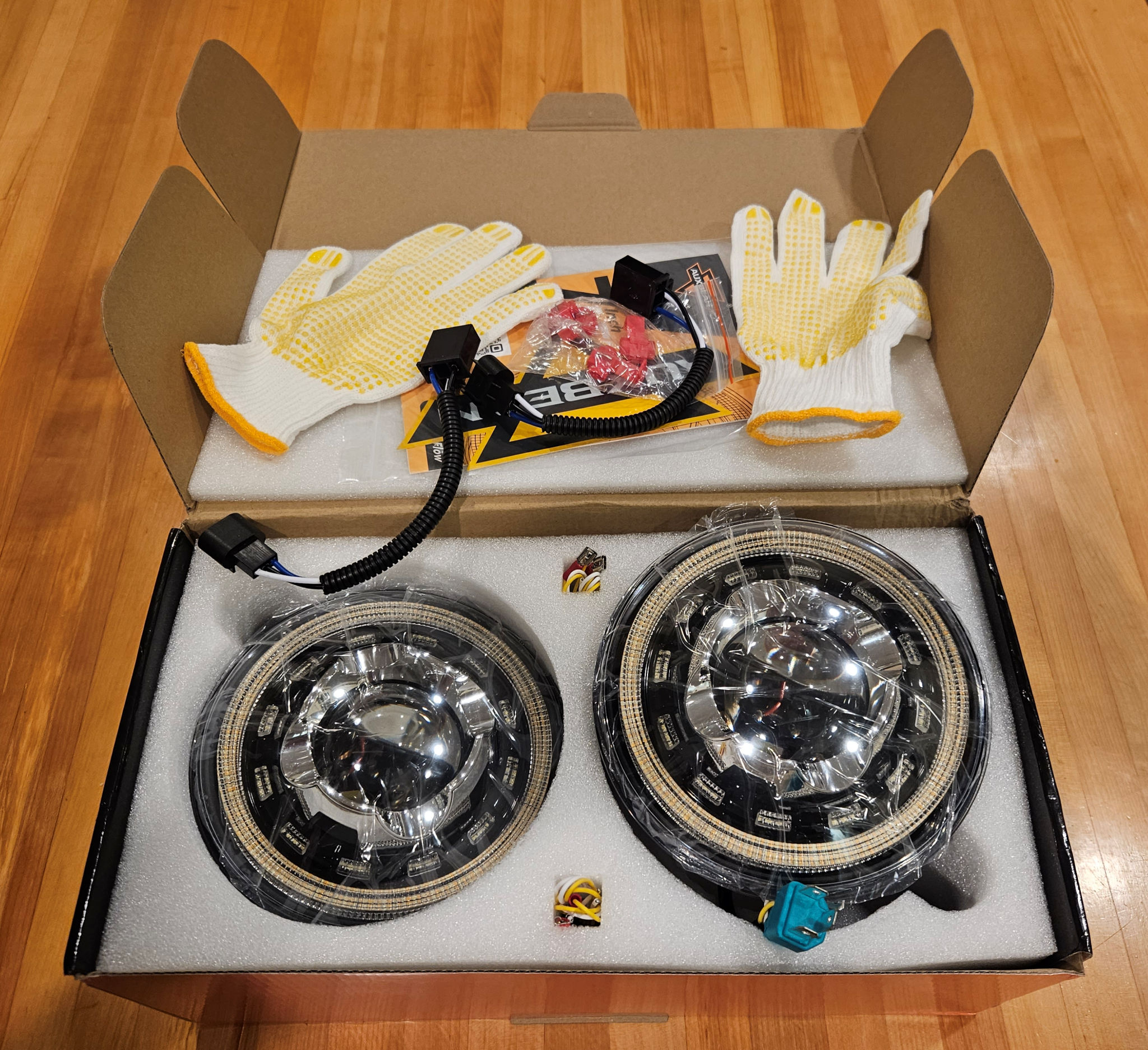

The contents of the box includes two headlights and adapters for H13 plugs - the H13 adapters are for a JK. The plug on the headlight is a standard 3-pin H4 sealed beam plug which will fit a TJ. Also included are wire and suitcase connectors to connect the DRLs and turn signal halos, instructions, a large Auxbeam decal and gloves with rubber grips to help with installation.

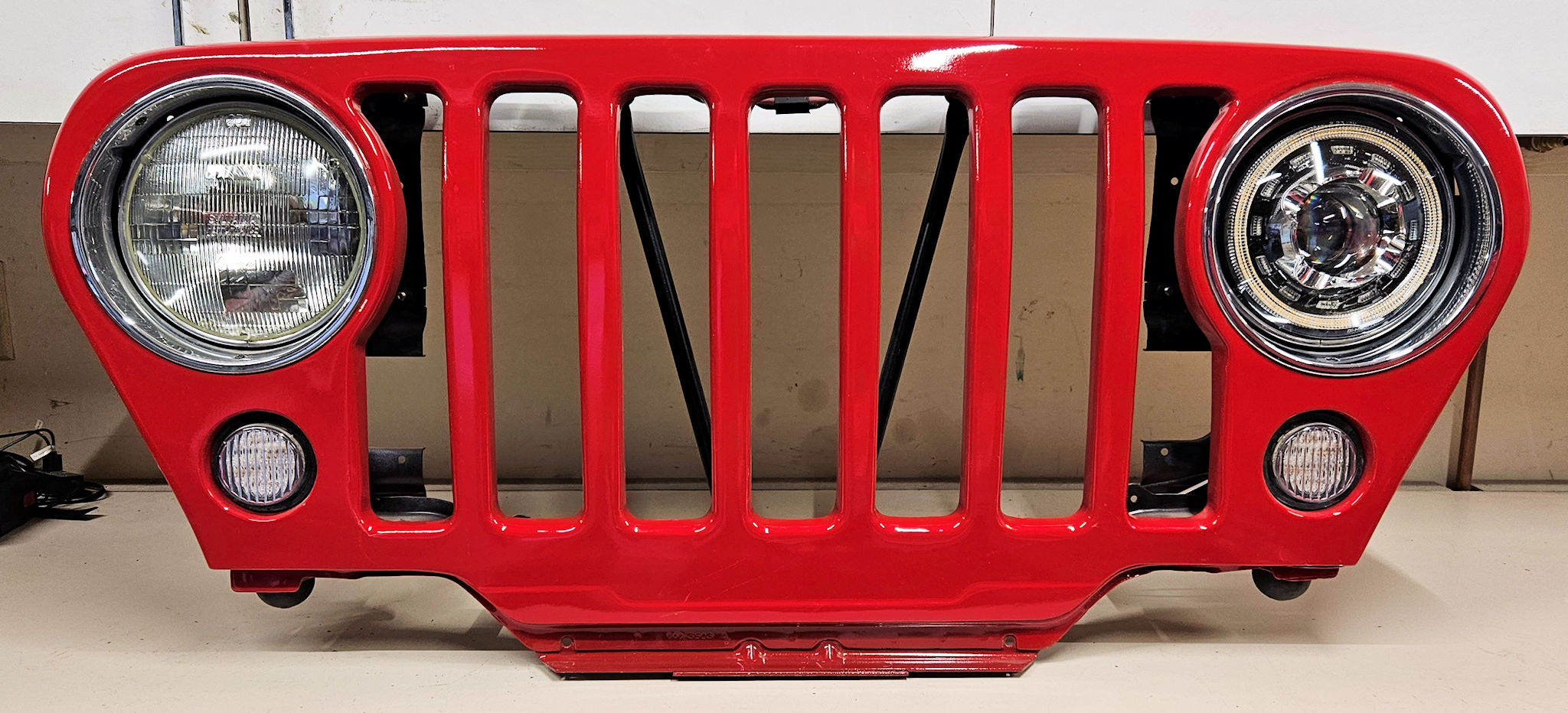

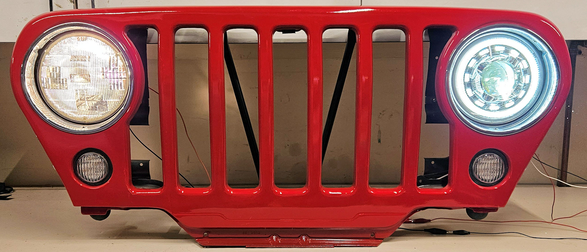

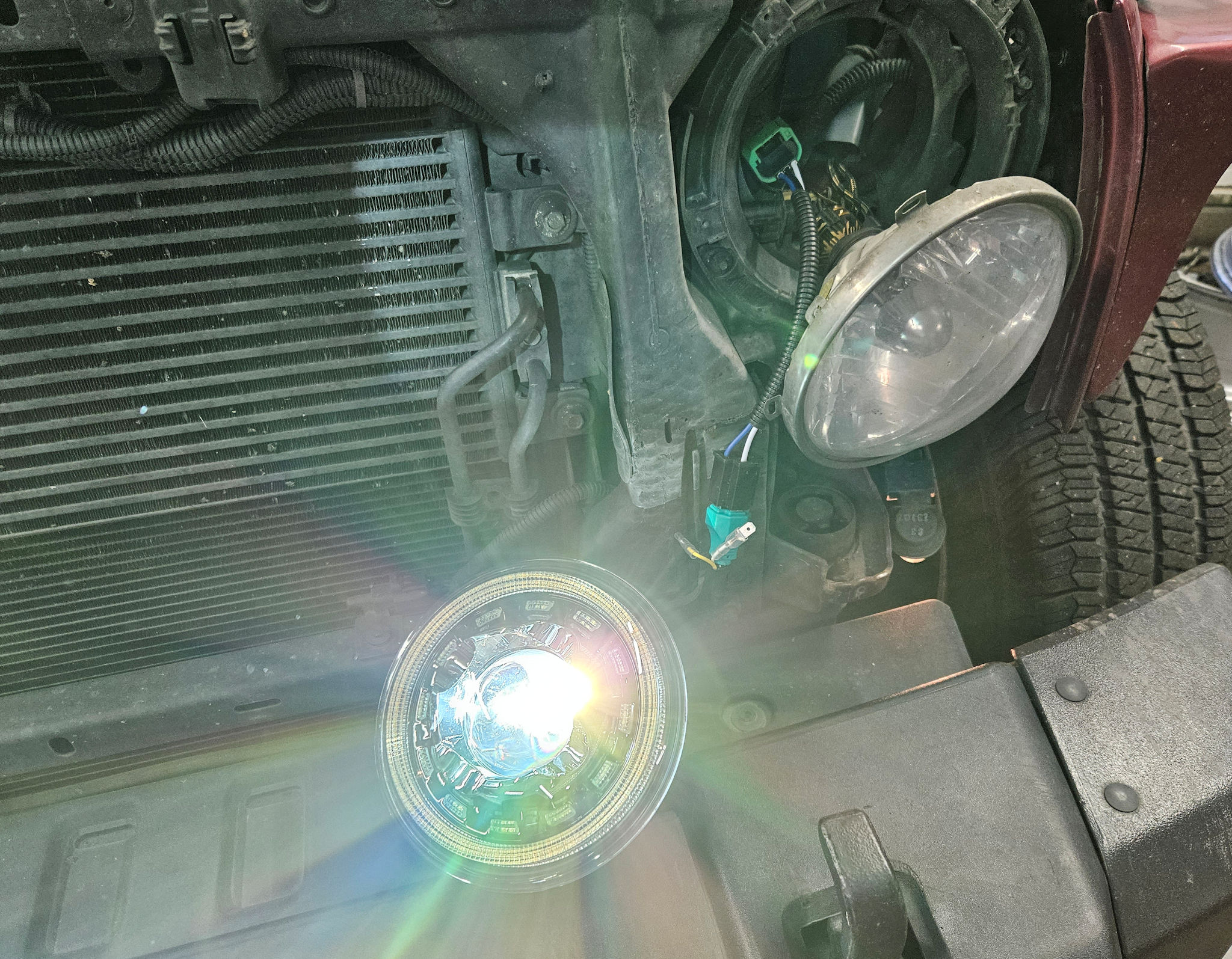

As a first test, I installed one in a TJ grille in the workshop to compare it to the stock sealed beam.
I powered both the LED and the sealed beam and my first impression is that the LED is a lot brighter than the sealed beam but I'll have to get it out on the road to verify that it improves visibility.

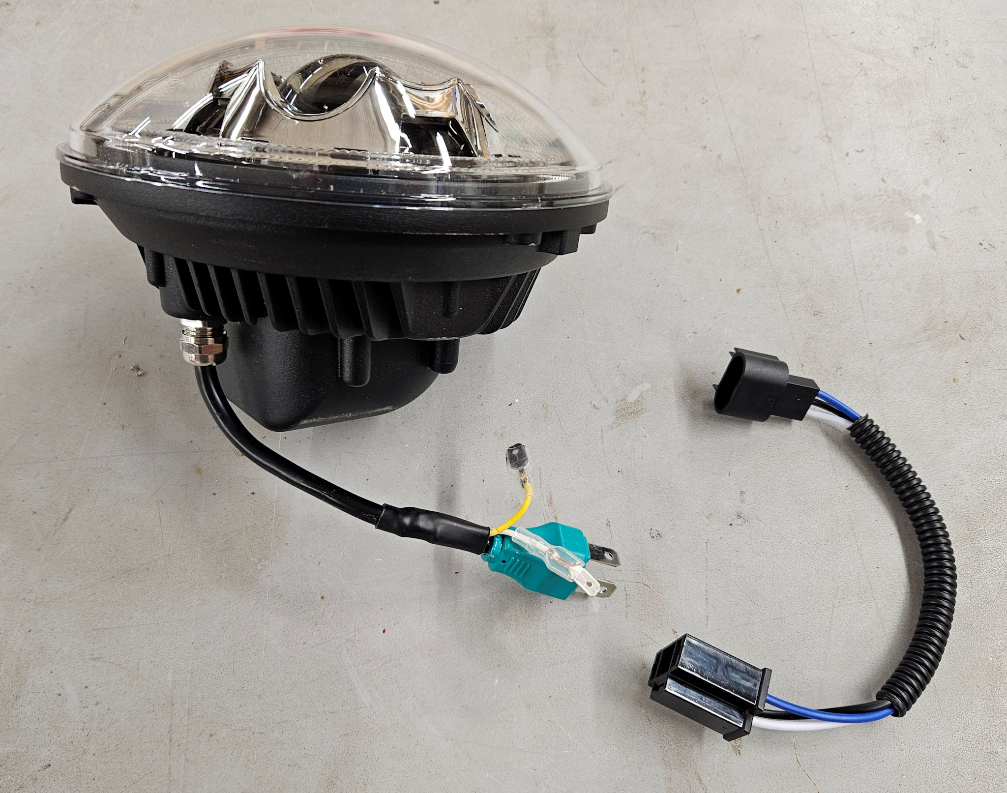

The headlight has a standard H4 plug on the back on a short cable sticking out of the headlight which matches the prongs on a sealed beam so the TJ's headlight plug will connect directly to it. The kit also includes a pair of H4-H13 adapters to use these headlights in a JK Wrangler. There are two extra spade connectors on the headlight cable, the white one is to illuminate the DRL (Daytime Running Light) halo function and the yellow one is for the turn signal halo. The DRL halo light is white and the turn signal halo is amber.
Next, using clip leads and a power supply I tested all of the functions of the light.

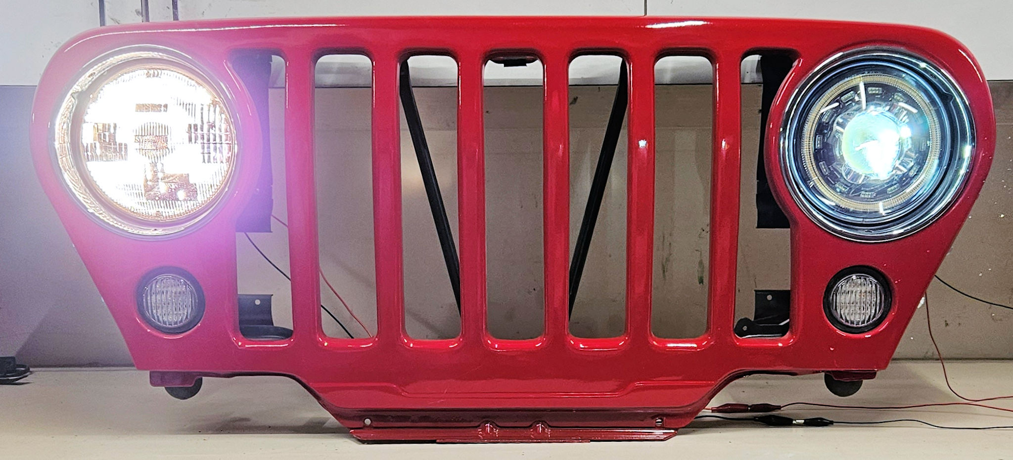

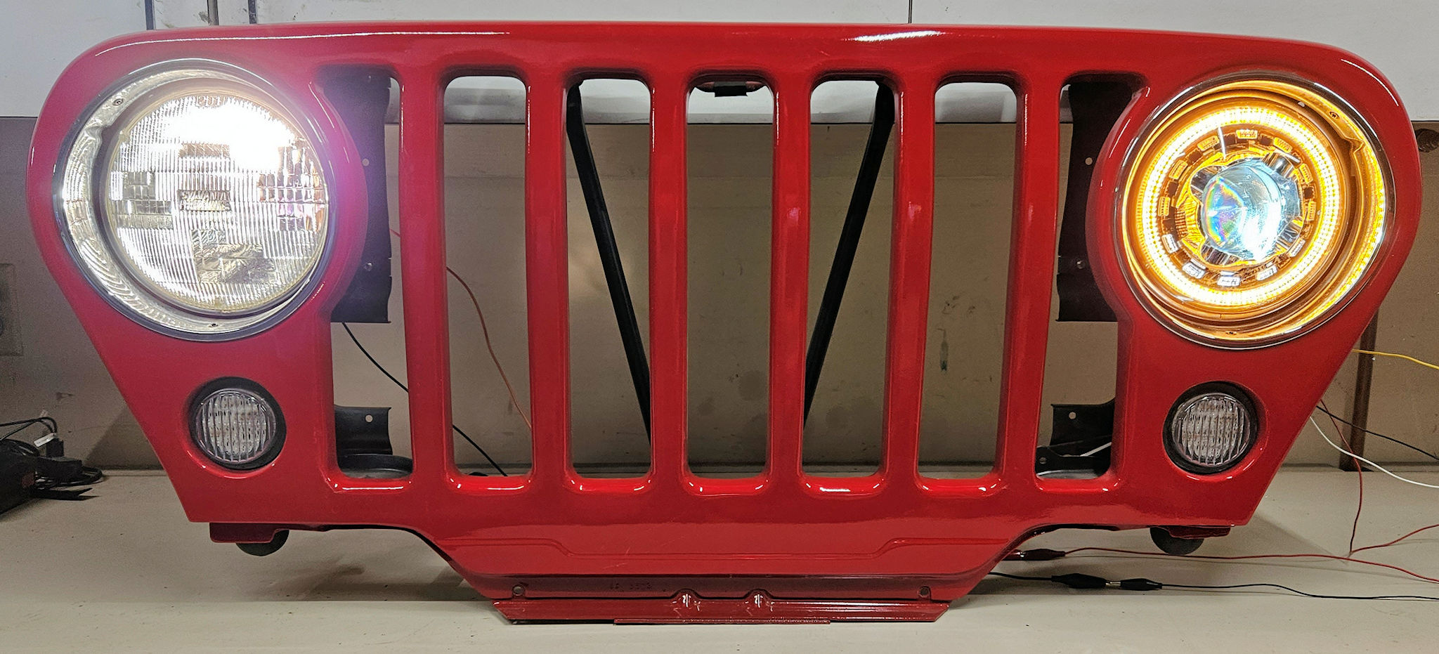

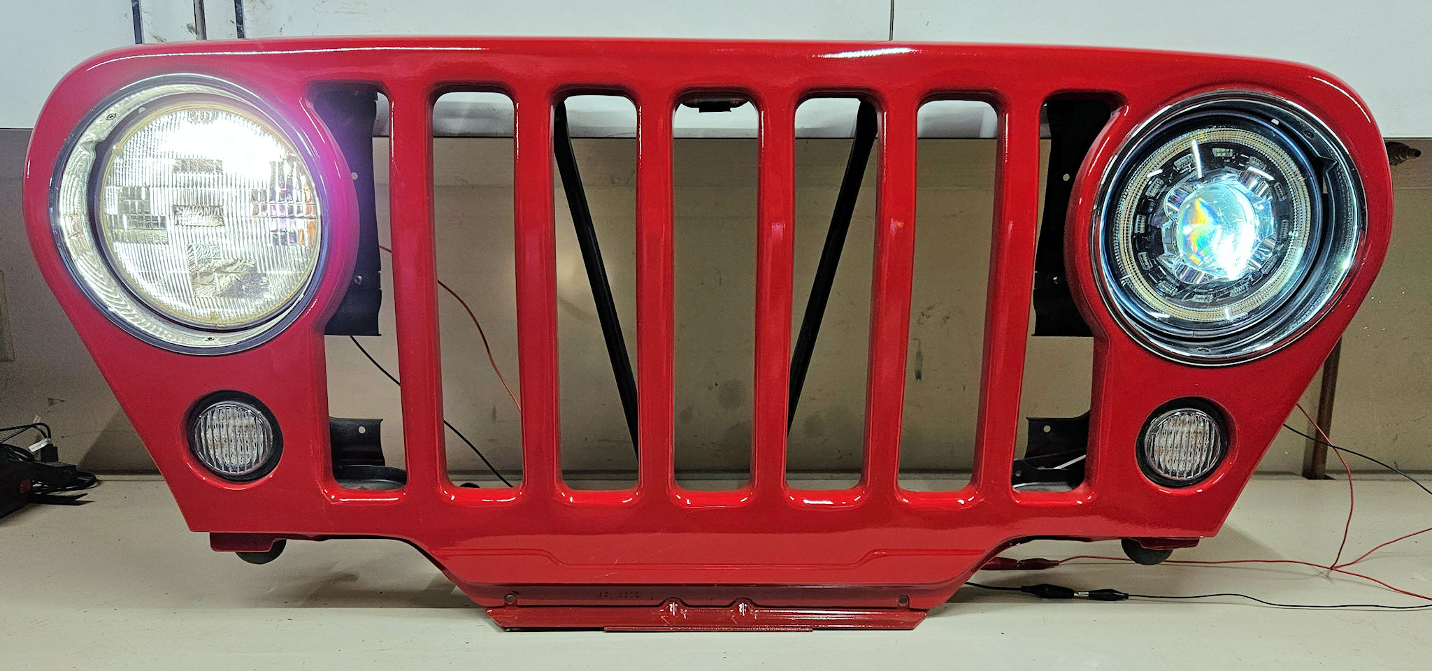

In this next photo, both headlights are illuminated in low beam. The LED side is deceptive in this view because it's a got a projector-style lens and unlike the sealed beam at right, not much light is wasted out the sides.
And both in high beam:
DRL halo:
Turn signal halo:

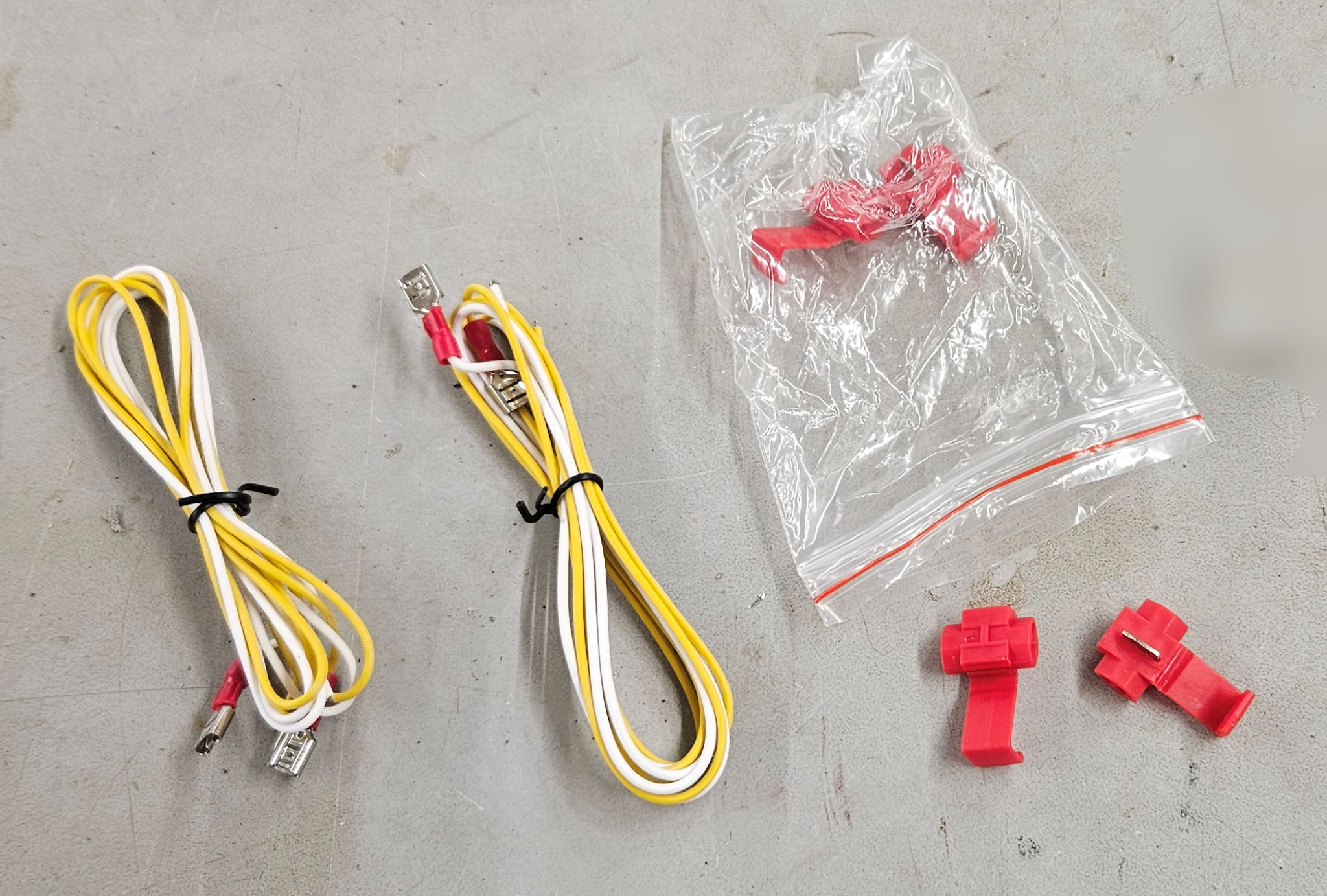

The tests above were done with clip leads and a benchtop power supply. To install these in the Jeep, Auxbeam has supplied a number of suitcase connectors and wire leads. The suitcase connectors clamp onto an existing wire, penetrating the insulation and completing a circuit to the wire to be tapped into the existing wire.
For the turn signals, a wire from each headlight will need to go to the wire for the turn signals on that side of the Jeep, and the connection to the turn signal wire will be made by crimping the suitcase connector over both the turn signal wire in the Jeep and the turn signal wire from the headlight. Auxbeam has supplied extra wire for that purpose.
The DRL function can be wired in several different ways. If you want to control when the DRLs are on or off, you can connect them to power through a toggle switch and this can be either switched or unswitched depending on whether you want to be able to turn the DRLs on when the Jeep isn't running. If you want the DRLs to be on automatically whenever the Jeep is running, connect them directly to a switched circuit, such as the one that powers the radio.

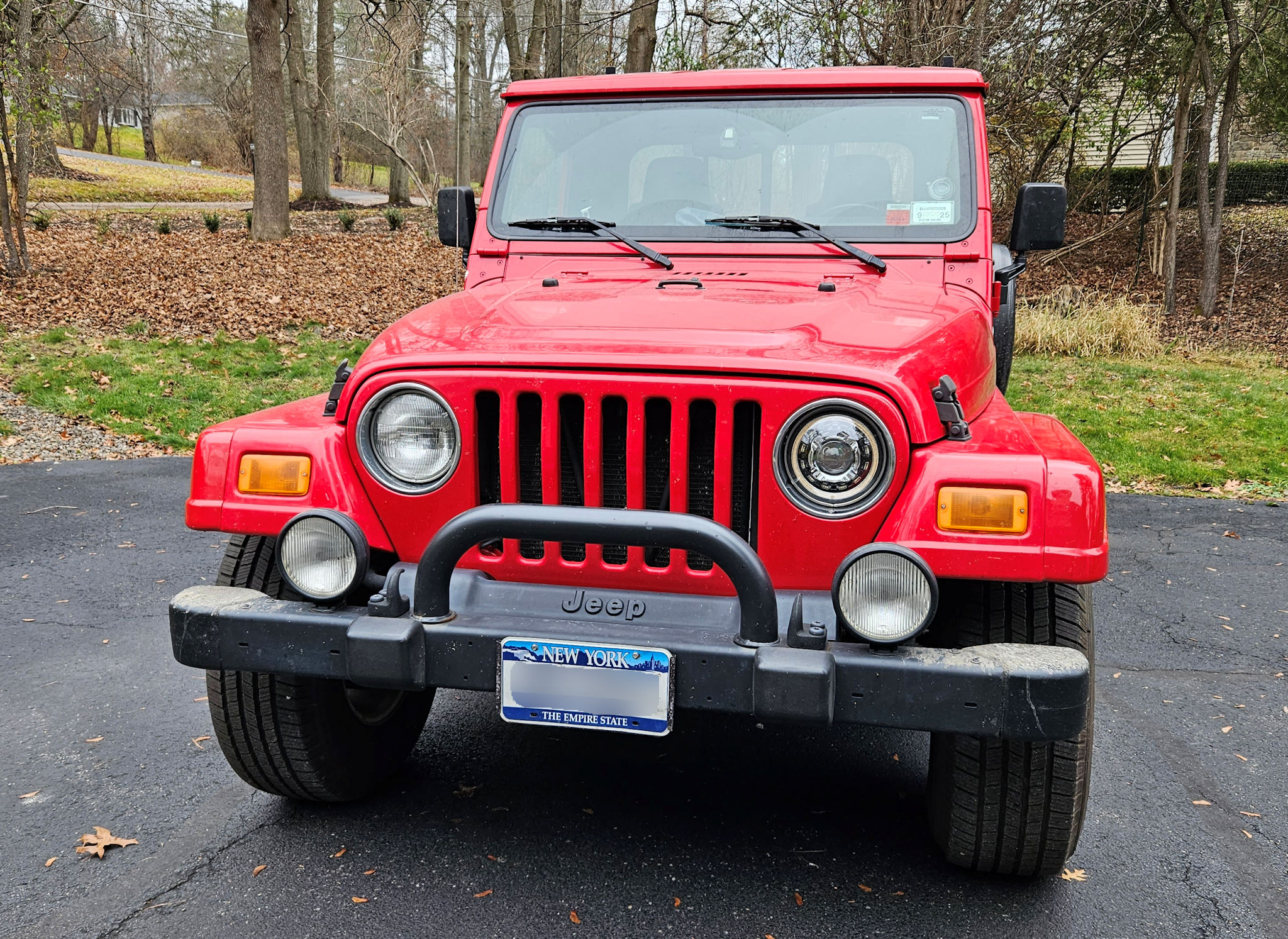

Since the housings and plugs are a direct swap for 7" sealed beams, these lights should work in most vehicles that have sealed beam headlights so I decided for the nighttime road test I would install one of the new LEDs in my '06 Wrangler pickup to compare the left and right sides on the road. I installed the new LED on the driver's side for the nighttime test:
With the lights aimed at the garage door I took these next photos to compare the lights in daylight. The left photo is low beam, the right is high and on both photos the left headlight is the new LED and the right headlight is the factory sealed beam. The LED is much brighter.
The instructions that come with the headlights explain how to wire both the DRL and turn signal functions for the JK/JKU but they don't cover wiring in the TJ so I did some experimenting. It turns out that the halo turn signals are compatible with the TJ's floating ground front turn signal wiring as long as there is power to the DRL halos. Operation of the turn signals is shown in this next video... I did a close up to show the wiring - notice a pin sticking in the white wire/green trace in the front fender marker light/turn signal plug - for this demo that "pin tap" is connected to the yellow wire on the headlight with a clip lead, and the white wire on the headlight (DRL) is connected directly to the battery with a clip lead. You can see that the DRL and turn signal functions work fine with the headlights on or off.
So to wire the turn signal function in a TJ, connect the yellow lead of each headlight to the turn signal wire for that side front fender, and connect the white lead (DRL) to a switched power source (the radio fuse in the fuse panel is probably a good choice) so the DRLs are lit whenever the Jeep is running. In my '06, the correct wire for the left turn signal is white with a light green trace and on the right it's white with a tan trace but different year TJs will have different colors for these wires.
After dark I did a quick drive around town to see how the extra brightness translated into extra visibility. These lights offer a significant improvement in nighttime visibility. The beams seem well-focused on the road, and no oncoming drivers flashed their lights at me to indicate that the lights were bothering them - the vertical cutoff of the beam is very well defined and below other driver's eyes. The new LED is only on the driver's side, the stock sealed beam is on the passenger side so things would be even brighter with these LEDs installed in both sides. This is low beam:
The lights are definitely more powerful than the factory halogen sealed beams, and the pattern is much more defined.bbbb

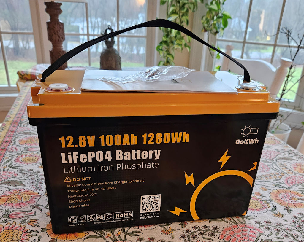

The product for my next review arrived today - this 100ah lithium battery. I'll start a thread on it in a few days after I do some initial testing.

Do not heat above 70C (158F) is probably an issue in an engine compartment. Is this intended as a secondary or camping battery where it could go in the back?
There are a few questions I'm waiting for answers from the company, using the battery in the engine compartment as a starting battery is one of them.
I plan to use the battery as an auxiliary to run my refrigerator and other overland/camping accessories and it will be carried back by the kitchen so it won't be subjected to extreme heat. I currently carry a deep cycle lead/acid back there that the lithium battery will replace for a comparison test. The lithium battery will also be used as an alternate starting battery though, the way my dual battery system is designed the auxiliary battery can be used as the starting battery with the flip of a switch on the dash.
I'll review the battery in detail and provide details on my dual battery/overland power system and solar charging in the review thread.

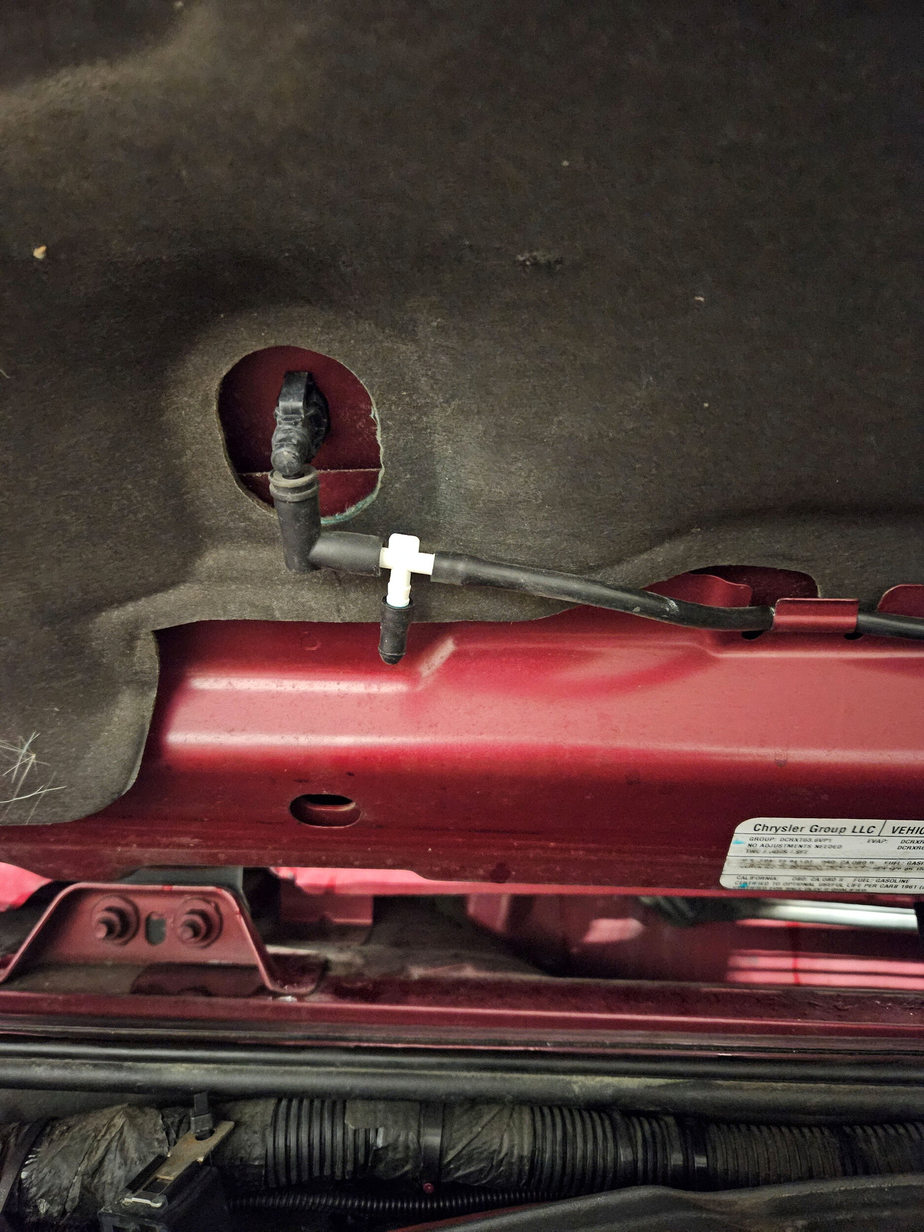

The other day the windshield washers in my JKU stopped working and the reason turned out to be that one of the hose connectors broke - apparently a victim of engine compartment heat. The only connector I had on hand was a tee, so I put that in and plugged the third leg:
And that gave me an idea - what if I ran a hose from that leg of the tee to washers installed on the grille? Every time I wash the windshield, the headlights would get sprayed with washer fluid that won't freeze in the winter. The washer pump has plenty of pressure to supply both the windshield and the headlights. For the summer, the hose could be disconnected from the tee and the tee plugged again.
Might be worth trying. Images of a washer nozzle held in place on a TJ grille...
Maybe not an ideal solution, but very easy and inexpensive to implement. And it it works well but washing the windshield and the headlights at the same time isn't desired, an extra pump could be added to the washer reservoir to just feed the headlight nozzles, and coincidentally a few minutes ago I got a marketing email from MPJA, one of my favorite surplus electronic components suppliers, and this submersible pump is on sale:
