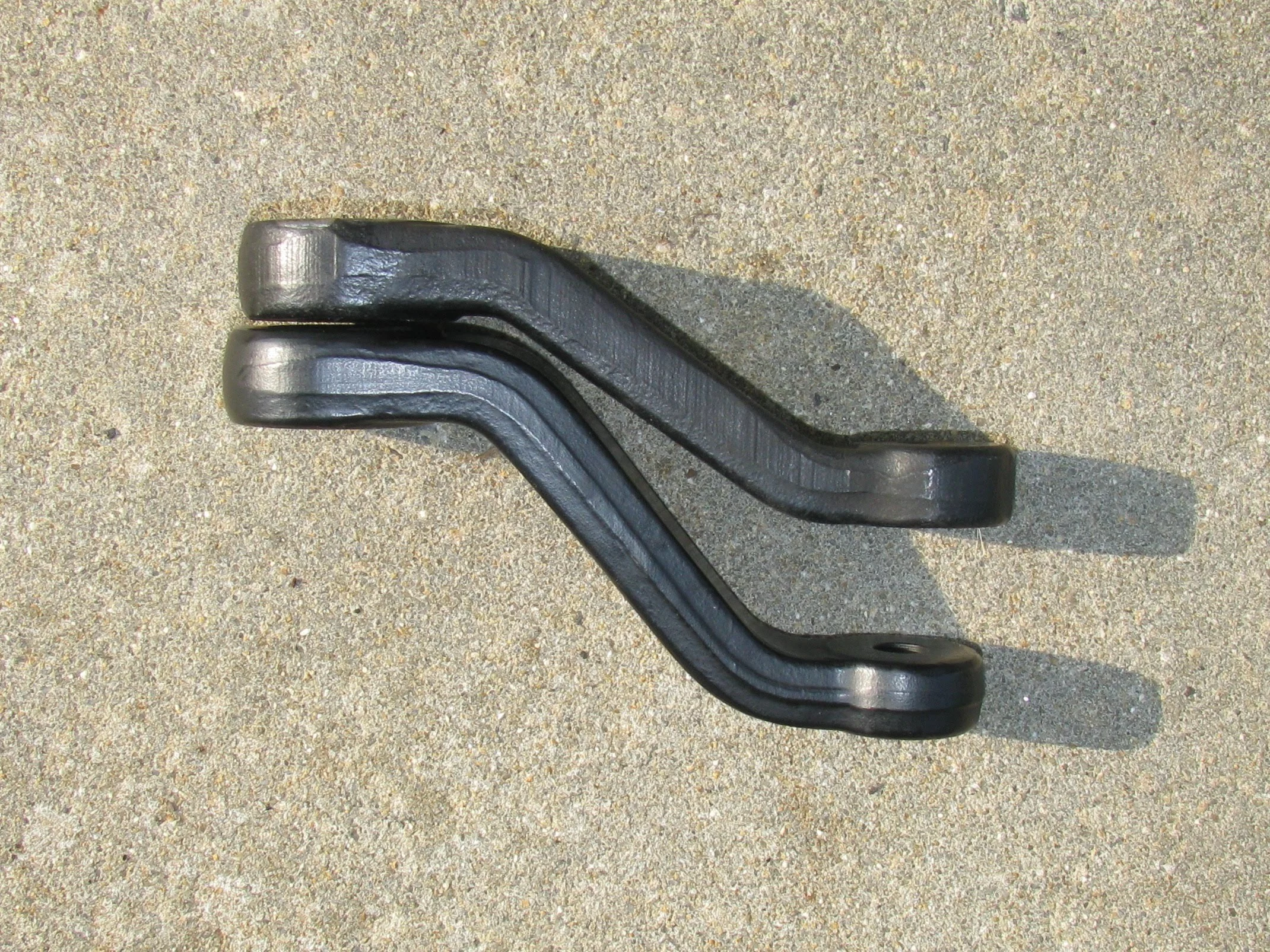

I bought a Jeep with the RC X-series 4" lift on it and I couldn't even keep it in my lane on the drive home. I removed the drop pitman arm and went back to stock. I also swapped the crap shocks to Rancho RS5000X shocks and did a DIY alignment too. Drove great afterwards.

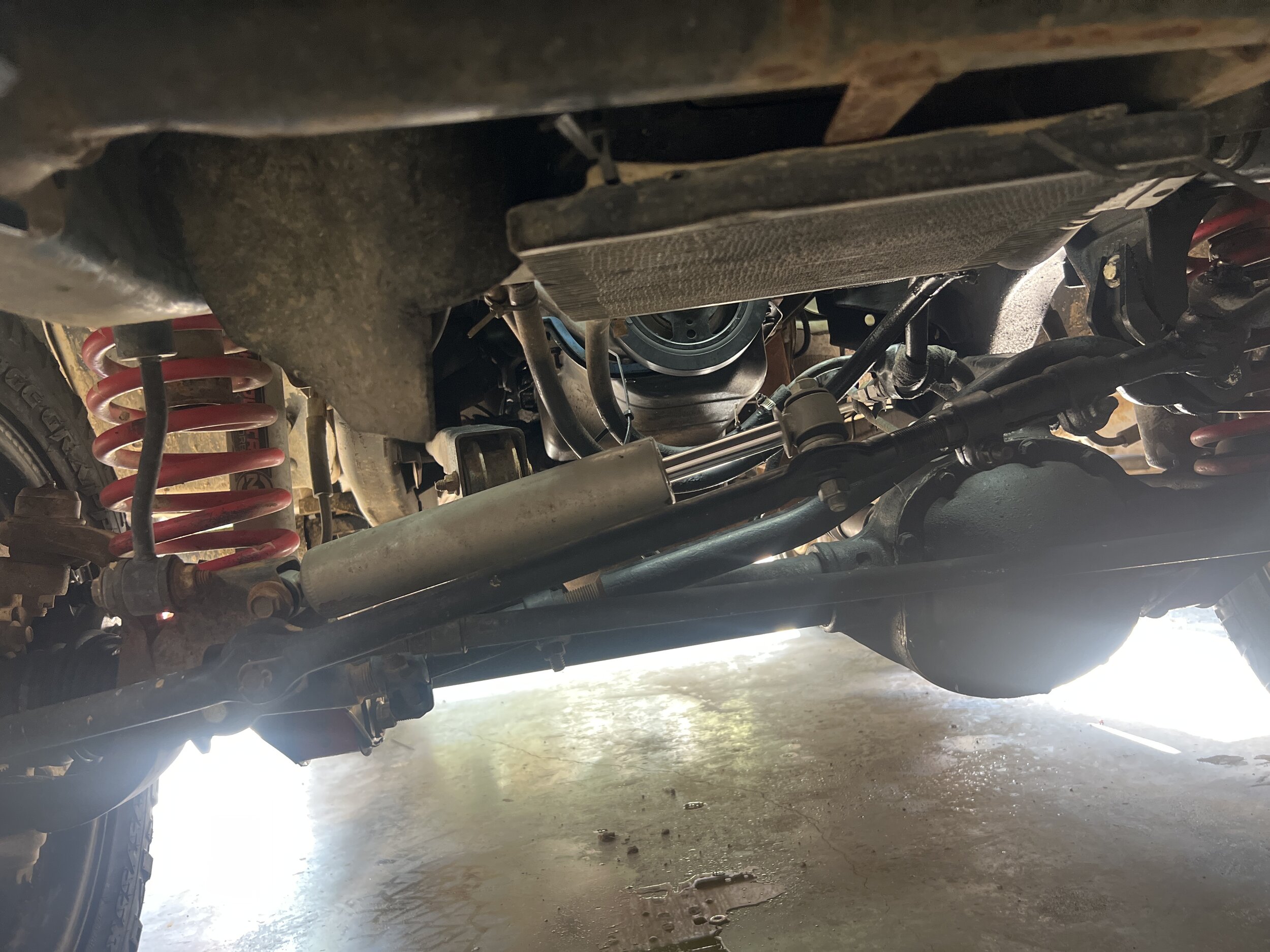

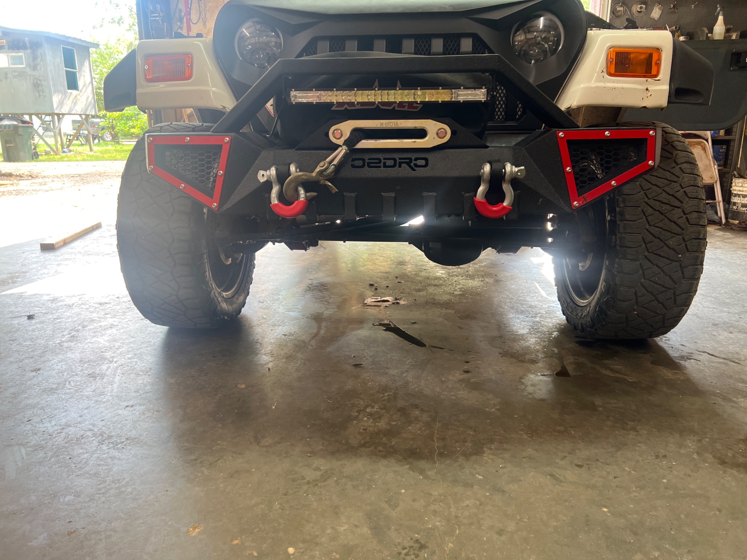

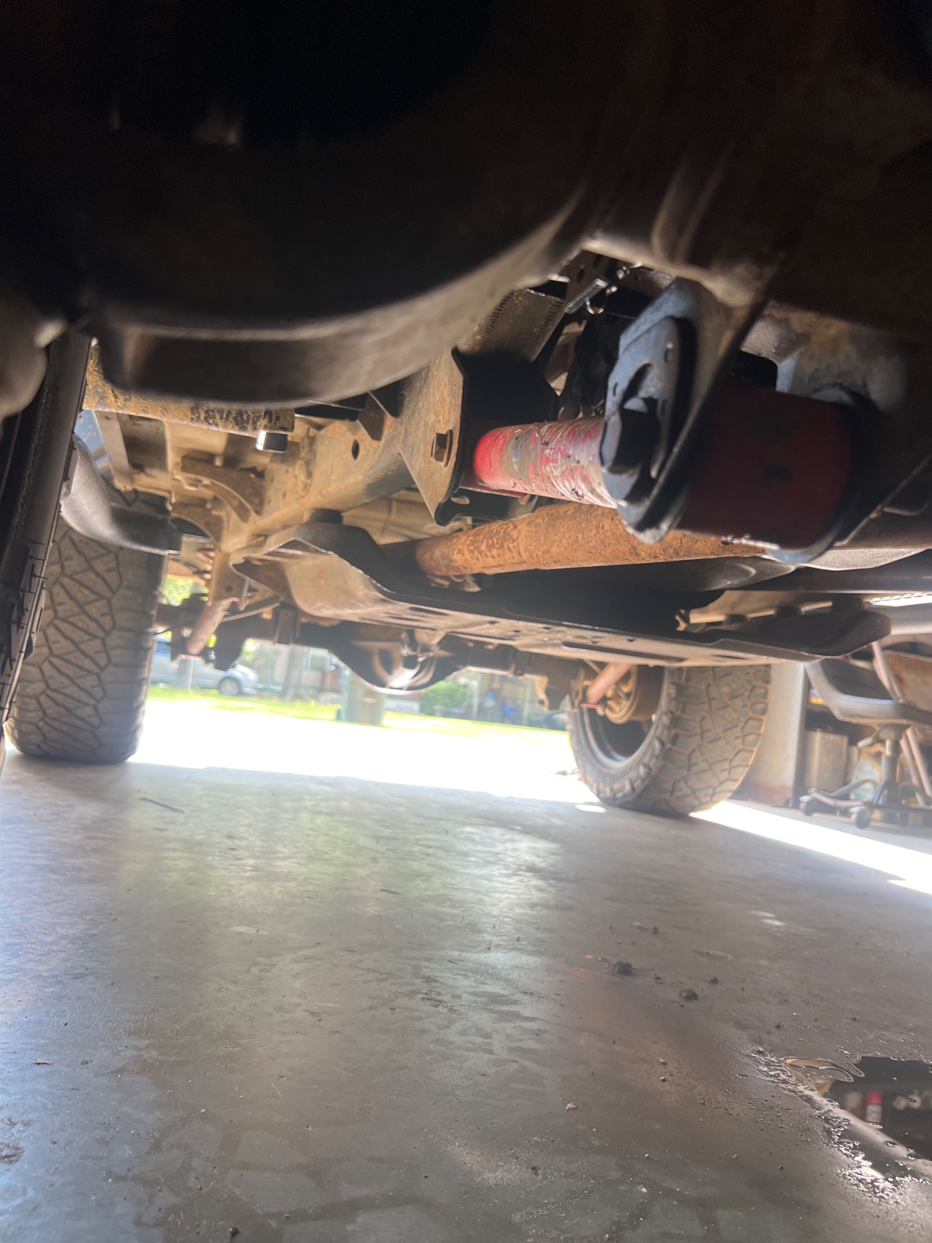

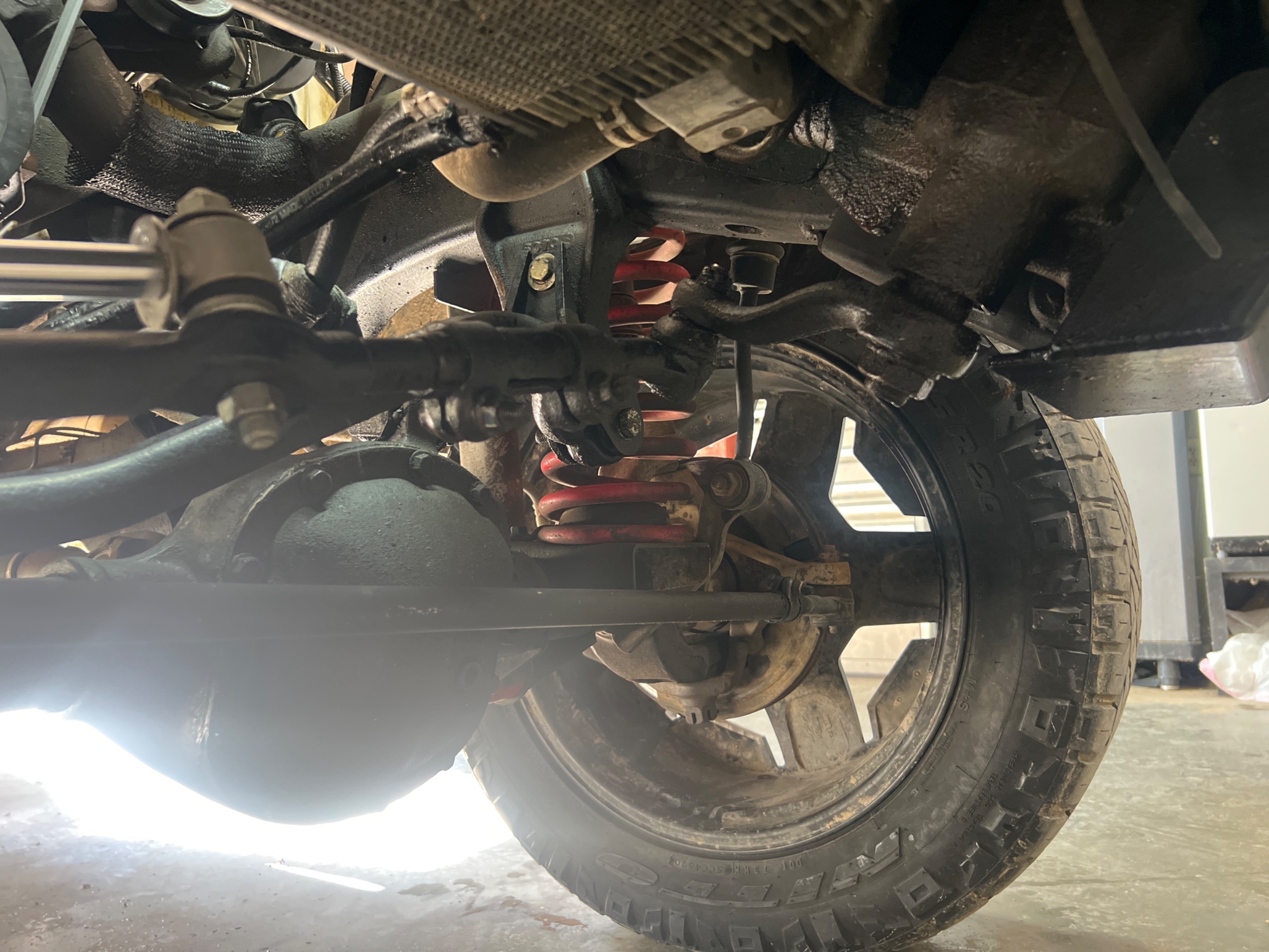

It may need an alignment. The toe looks out on the driver side. If these aren’t the pics you guys wanna see let me know. First jeep to total noob on the suspension

Looks OEM. No clue on the caster and toe. That’s above my pay grade. I’m running 30 psi in the tires but seems like I may need to drop that some.

Just a couple observations.
Because it's a solid axle, toe isn't adjustable per-side. If it's off it's off an equal amount to each side, essentially. Think of the two main adjustable components of the steering being overall toe and steering wheel alignment.
Unrelated to the current conversation but you've got a transfer case drop. Just something you might not be aware of.
If those red control arms are like the lower skycrapper arms that were on my TJ when I bought it, they're poly bushings. Poly bushings fight articulation and bind up, right up until they become wallowed out garbage then they allow movement. I'd take a look at those to see what you're working with.
What's going on with the track bar? It looks like a bracket bolted to the mount at the frame. That could be the source of all sorts of trouble.

The reason people bring up pitman arms right away is because you want the axle track bar and steering drag link to be parallel. If you move the mounting point on one and not the other and they're no longer parallel (or similar length) then they travel in different arcs and that's what people refer to as bump steer. It's hard for me to tell looking at a photo if that's a drop pitman arm but I'm wondering if that's some sort of track bar drop bracket at the frame. Different issue with the same end result.
