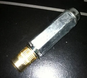

I just drill a hole in a bar and use a lock washer and bolt to set them. I've done maybe 20 this way of various sizes. I don't see much use for a tool unless you need it for pop rivets or do allot of them. Those tools probably wouldn't have even fit in half the places I've set them. Blaine suggested that method for installing the large frame inserts and I've managed to use it for all sizes with good results.
I would love an excuse to buy a new tool, but I don't do enough riv-nuts or rivets to justify owning one. I've rented or borrowed what I needed for big jobs.
I use something not unlike this for the few riv-nuts I need to do (I think ACE even sells something similar bagged as a "kit" in the same bins as the riv-nuts), and a small "economy" rivet tool from the hardware store
for rivets.
I've done the bolt & lock washer trick before but I was going to be doing more than a few so I figured I could spend a little and make my life easier.
