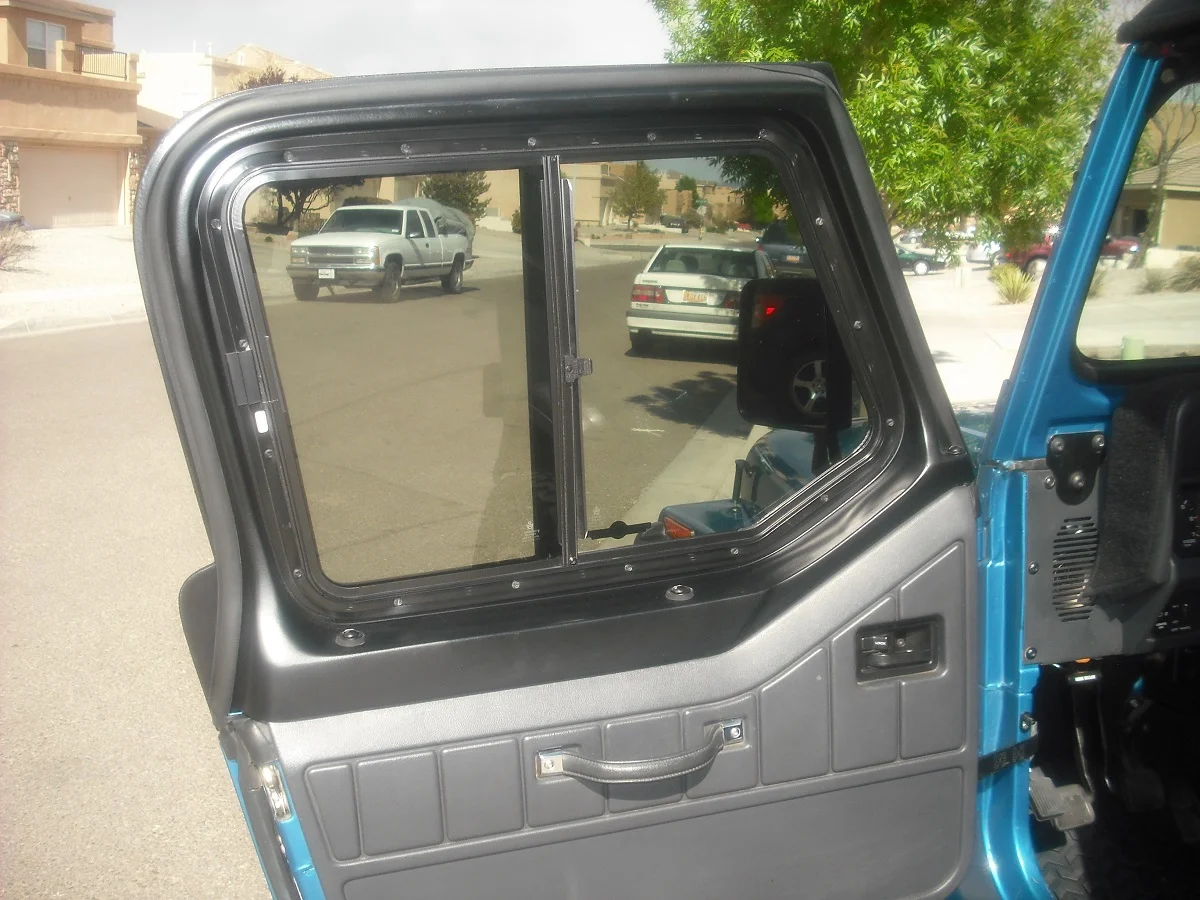

I've run soft uppers, soft uppers with glass, Bulldawg uppers, and full doors. If reduced noise is what you want, just get full doors. They seal much better, provide better visibility, and, when opened, better access to drive-thru locations. The Bulldawgs have a big negative in that they use a special insert for the uppers. You have to remove the factory inserts to use them. At least the version I have does.

if soft uppers was a 10 and hard doors was a 1 in noise level, where would you put the bulldawgs?
That matches my understanding with the inserts, and also that they use fasteners to attach, rather than just dropping in. Are the fasteners tool-free or do you have to carry around a socket if you wanted to remove them on short notice?
