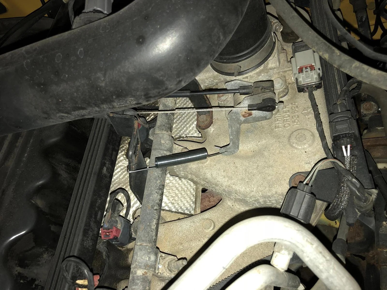

Add a throttle return spring, for $5 this was one of the best mods I did on my manual ‘06. The ‘05 and ‘06 manuals had only one for some dumb reason and it makes the throttle response so touchy that it’s tough to drive smoothly at low speeds particularly if the road or terrain is rough.
Ahh, the very touchy starts. I know exactly what your talking about. I will look into that right now. If you don't mind, will you explain to me how it works?
The autos, and my understanding is other year manuals, have a secondary throttle return spring that we didn't get. I put a dorman universal one on from autozone but I believe the stock jeep part is very cheap if you want to hit your dealer. There were holes there already, I just cut my spring to length and bent it into hooks. Check and see if you have anything in this location under the hood.
I plan on ordering a Throttle spring quiet soon, working on the jeeps audio system right now. trying to put some plans together with what I want to do. Thanks for the pictures, i will look tonight.
