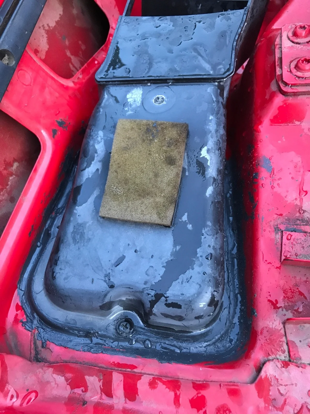

Thanks again everyone. I have another question. I've had a on going issue with a leak that is coming in on my passenger side floor it streams down under the dash. I just don't know how I've done this and got rid of the foam but still water can't figure out how.
