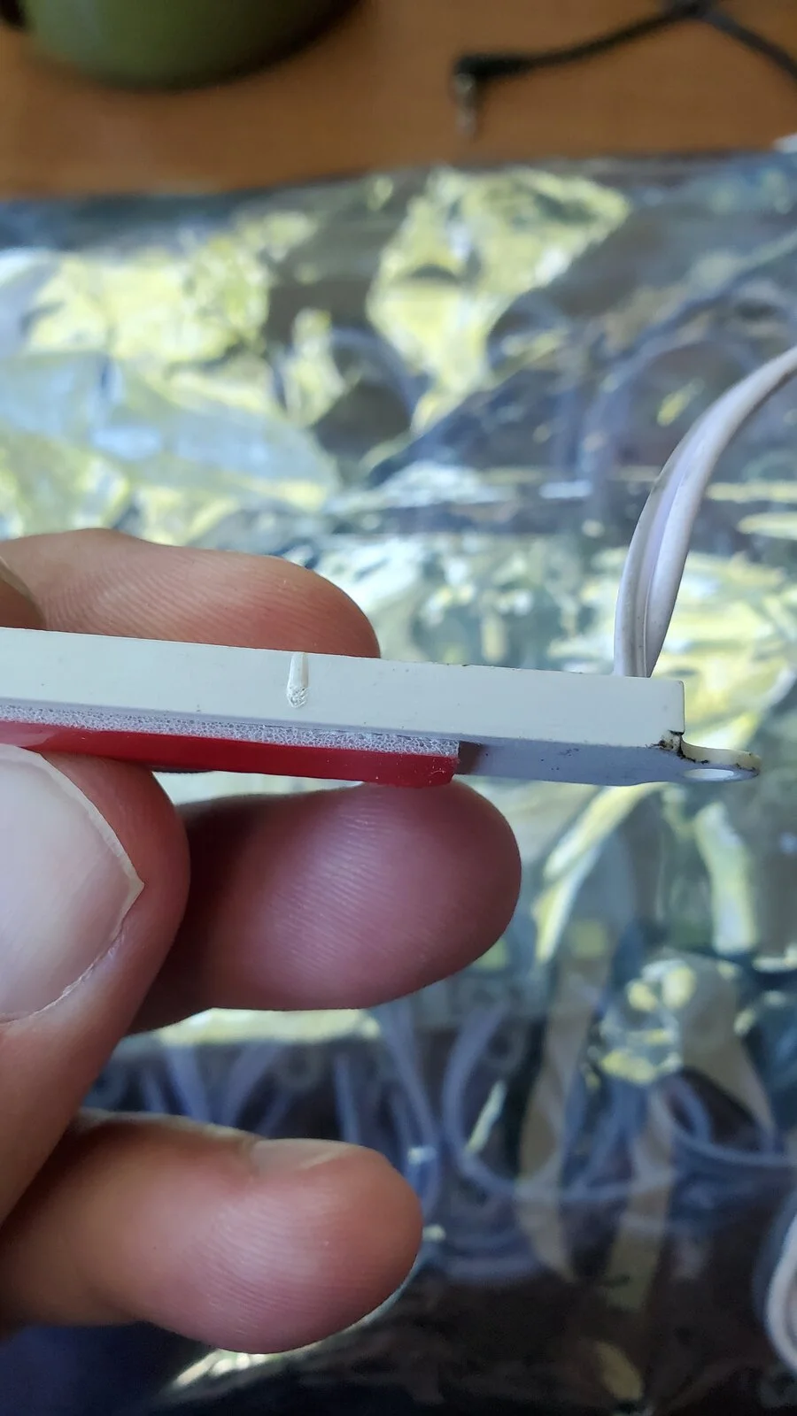

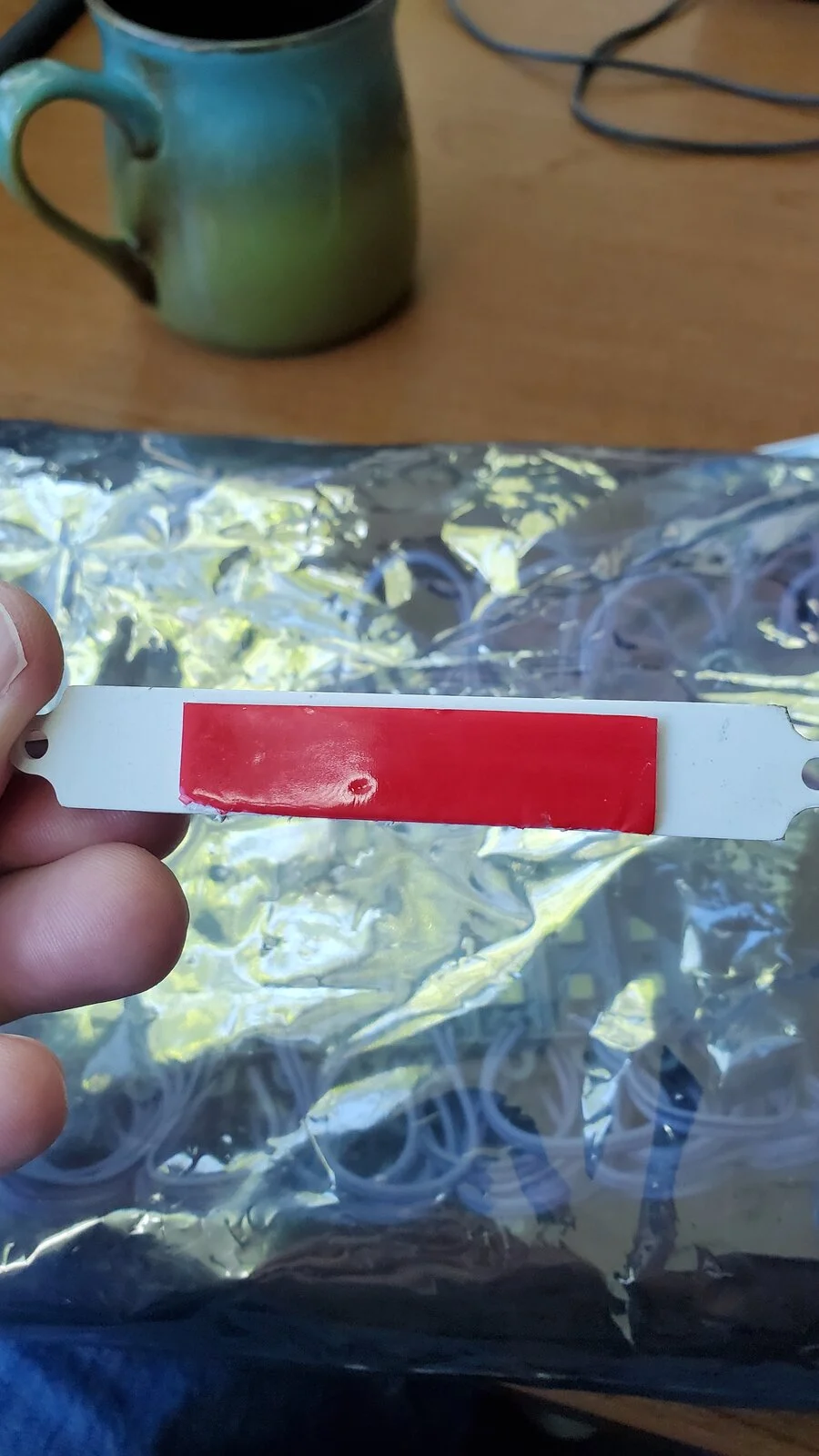

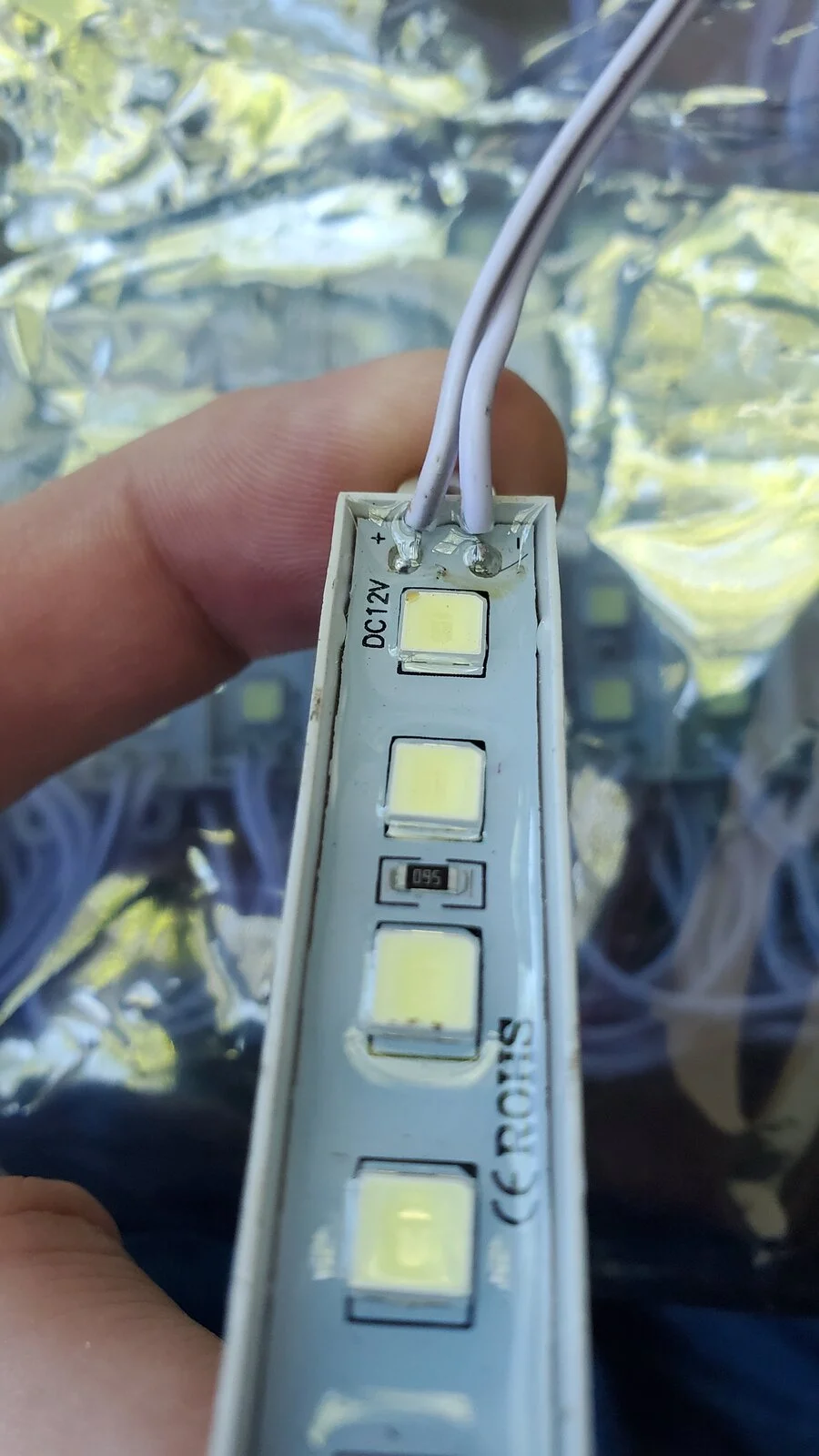

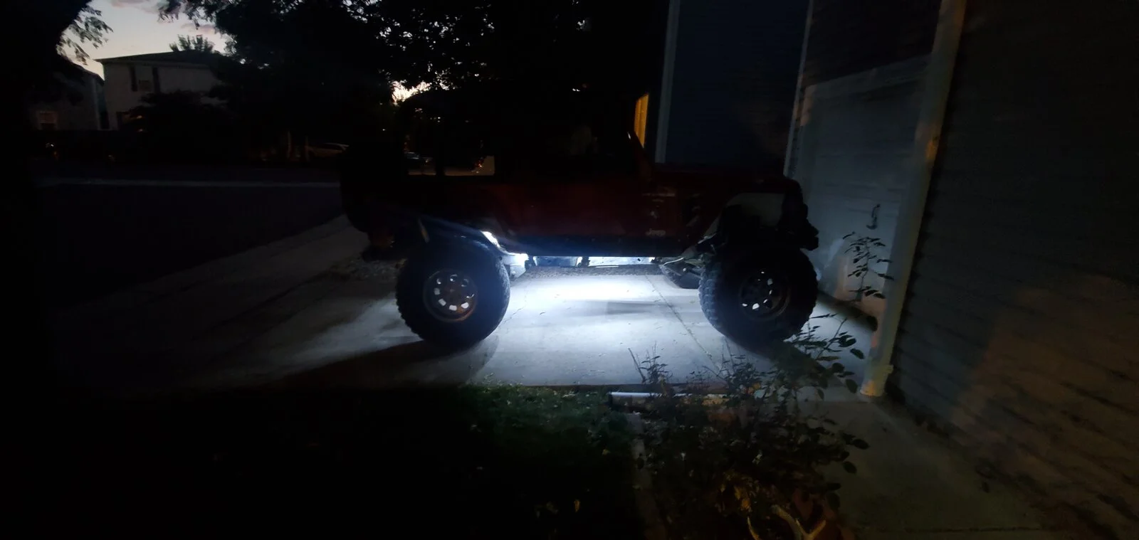

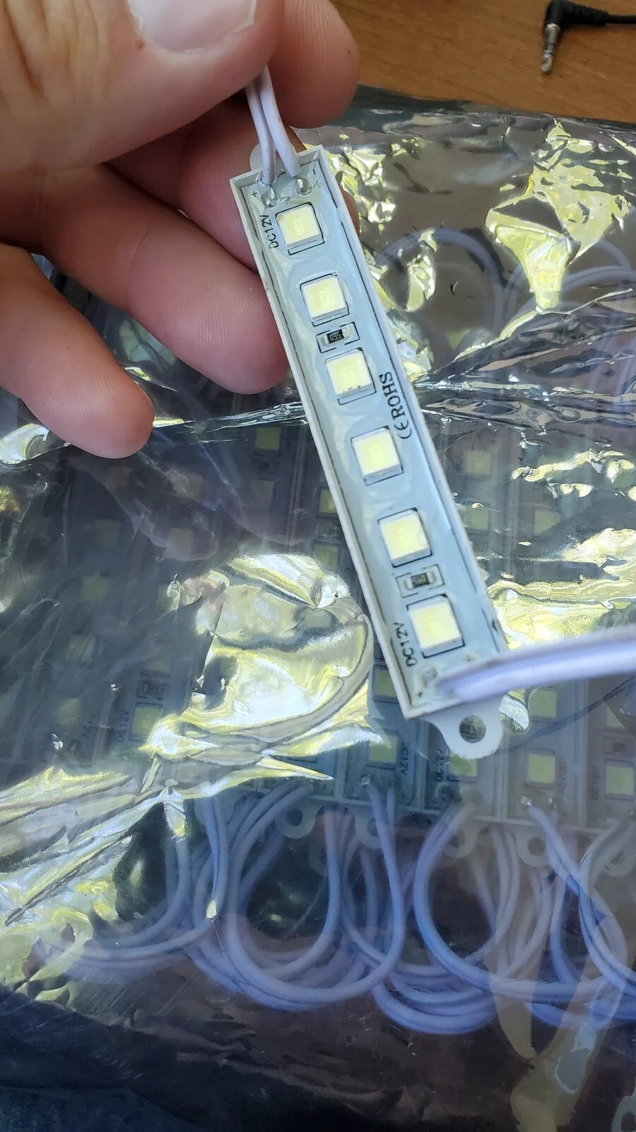

These are the ones to get. No need to pay extra for off-road rock lights when all you care about is if they are waterproof.I bought cheap outdoor sign leds. Has been a few years and I have only really used them twice (and even then they weren't needed). Something similar to these:
https://www.amazon.com/dp/B07CSRFFD4/?tag=wranglerorg-20
The ones I bought have 5 leds per strip. I have 15 under the front bumper 25-30 on each side, and a handful more in the rear and around the driveshaft. Mine are wired to a relay so i can use them whenever and maybe a 10 amp fuse (they draw so little power). Don't put them directly over your tires because that is dumb. Put them where they will light up the rocks, not your tires. Also, go for boring white. Don't do some RGB nonsense.
View attachment 328343View attachment 328344View attachment 328345
These are advertised as "waterproof" but the reviews seem to be mixed on that subject. Have you found that to be the case?These are the ones to get. No need to pay extra for off-road rock lights when all you care about is if they are waterproof.
Also, I have also only used them a few times where it might have mattered.
Also, it appears that these lights have a hole in each pod for a screw? Is that accurate? Did you use screws or did you just use the 3M method?

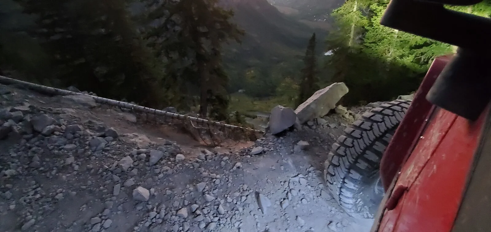

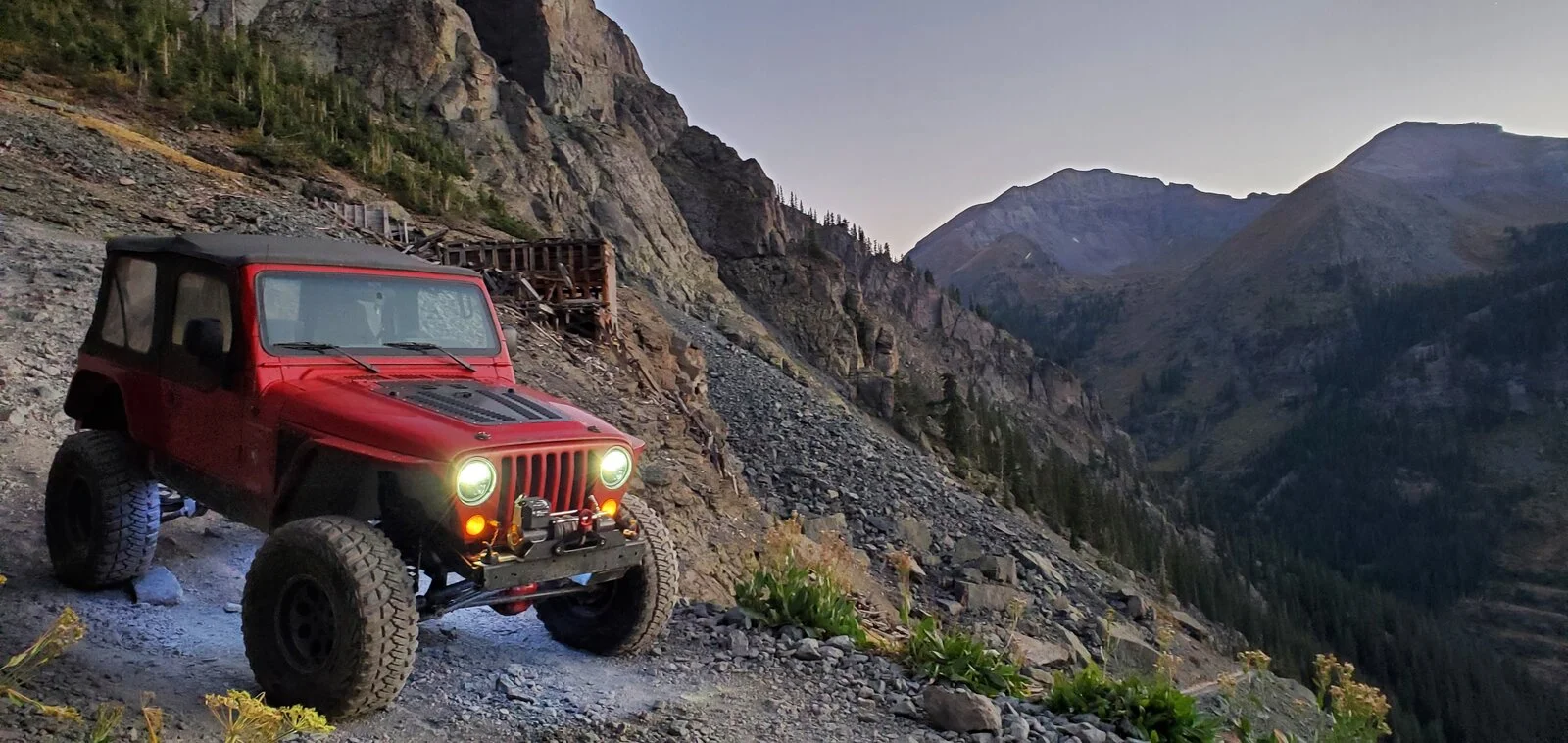

Right above Telluride! This is on Black Bear Pass just above Ingram Falls after the steps.Unrelated .. but man I will never get tired of the scenery you have in Colorado. Can you please share was this was taken at? Near Telluride?

Mine have been under the Jeep for at least 4 years of daily driving and are still working.These are advertised as "waterproof" but the reviews seem to be mixed on that subject. Have you found that to be the case?
