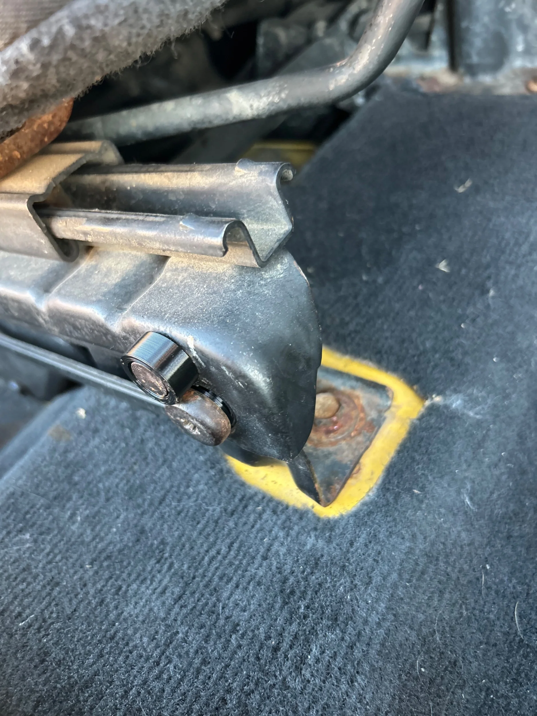

Do your front seats rock? Maybe about 1/8” worth of play in them? I’m sure there are people smarter than me that have come up with how to fix this but I thought I share what I consider a cheap fix to an annoying issue.
https://www.amazon.com/dp/B08D72MQB7?tag=wranglerorg-20
Above is the link to some simple 3D printed seat bushing replacements.

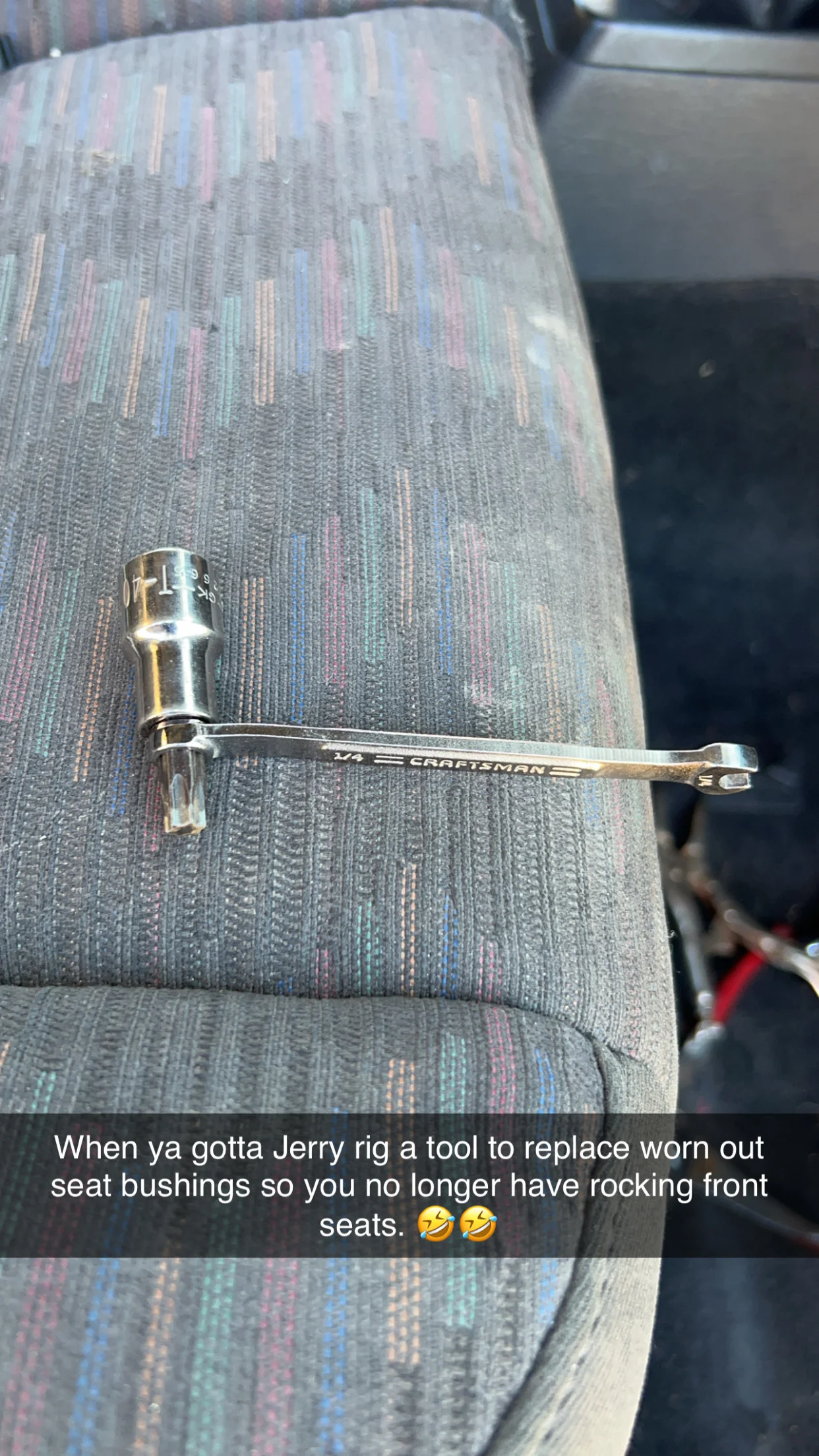

Fairly simple to replace the outter ones with the seats in. The inner are a little tighter on space for a T40 socket. One of the attached photos is what I did because I didn’t want to buy another tool and it worked fine. The other pic is just the final pieces installed.
No more rock in the seats!!

If these printed ones don't hold up, then I will just chalk that one up as a lesson learned and order the summit ones. So far, driving today, they seems solid. The quality of the print looked pretty good too compared to the high dollar printer we have at work. For now, it is fixed.
