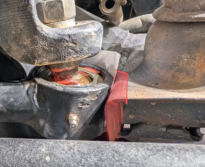

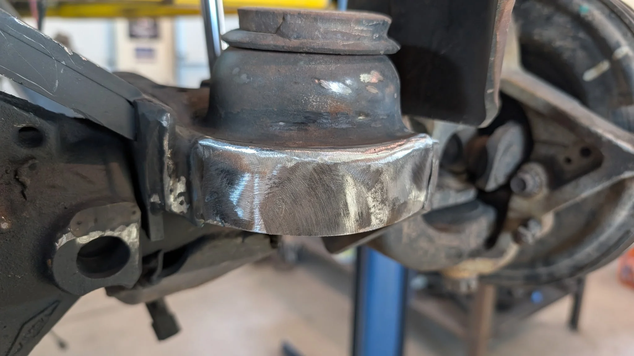

The corner of the lower spring seat needs to be cut away to safely clear the Johnny Joint housing.
I’m planning on doing this as well. I saw a random build thread that I cant remember the name of in here with a good idea for it. Saved the pic. Mines currently self clearanced

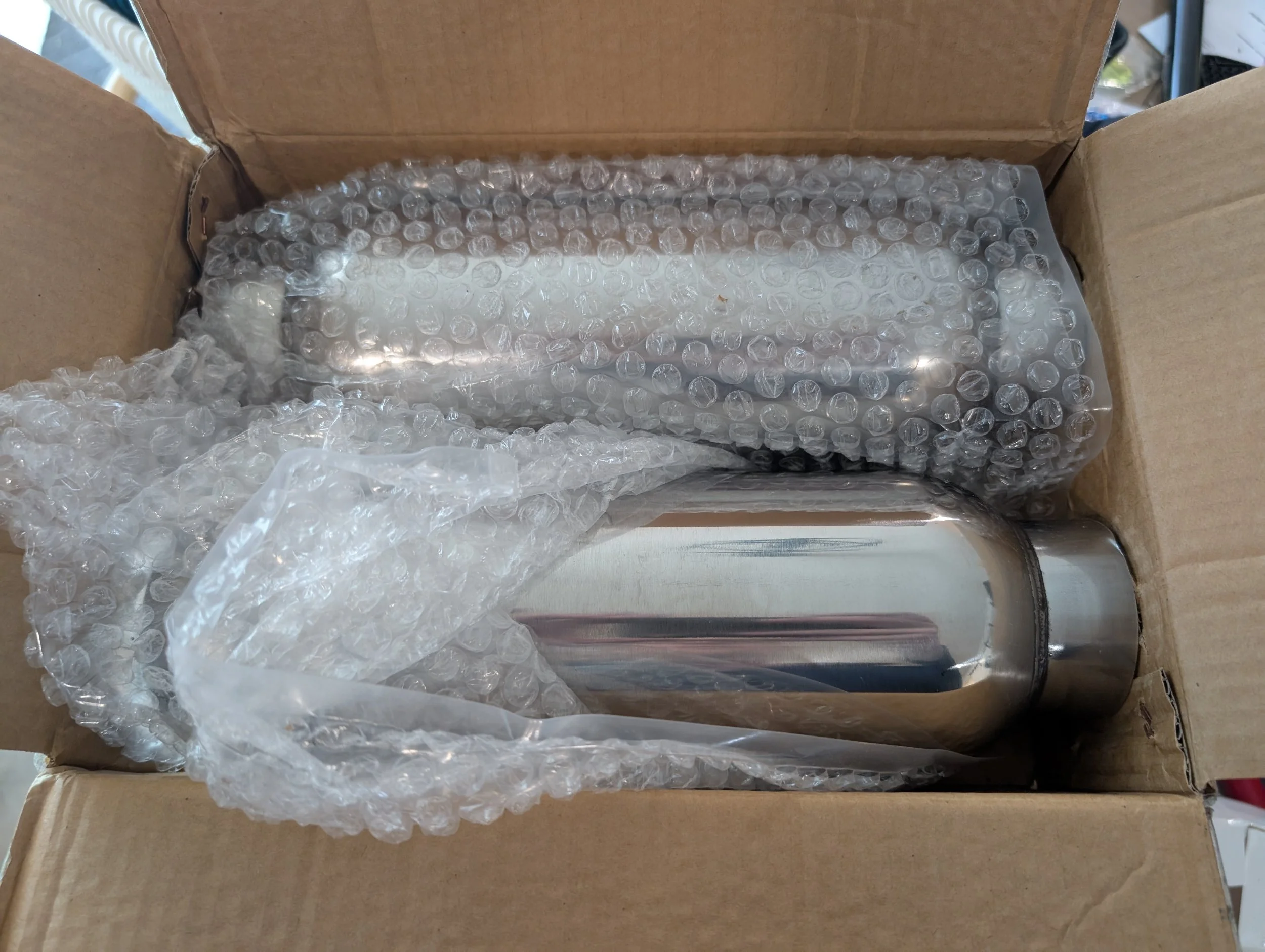

Straight piping until we can get more time for mufflers, but it drives again! A few follow up items:
* I need a longer brake line - 34" is just a little shy so getting a 38" line.
* Straight pipes are fun, but I want to get some muffler(s) in.

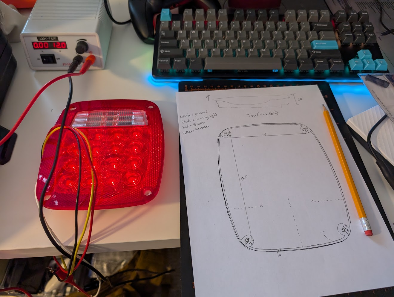

I put trail tail lights on my jeep a few years ago as a consolation prize to the mostly unobtainable black Savvy tail lights - and just never really felt like they quite fit. Over the years I have considered buying used (usually missing them) or considering others. However, I never really liked any other housing as much as the mostly OEM feeling Savvy.
Fast forward a bit - Blaine put together a great taillight that is the brightest and cleanest I have seen to date (including phenomenal reverse lights), however my mind has still been on something close to that Savvy shape (it makes me think of a clean and low profile version of an OEM tail light). He was generous enough to let me buy some of the components a-la-carte to play with and didn't mind that I had a different style in mind.
Another year or so later, I finally have the bandwidth and growing CAD skill to play with some designs - so that project starts today. My intent is to 3d print low profile housings using Blaine's awesome lenses. For now, I am not including the markers into any design plans yet - only so I can focus on getting the correct shape for the lens, screw holes, tub mount, and cable access. Once I figure that out, I will adjust the design to work in some type of marker lights. Initial prints will be in PLA since it's cheap to test with (something like $2 a print or less as I print single features instead of full housings) working up to ASA which will roughly cost me about $4.25 a side.

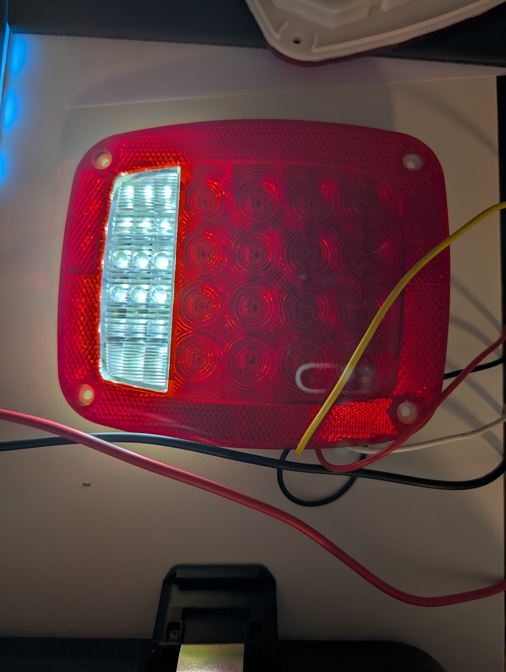

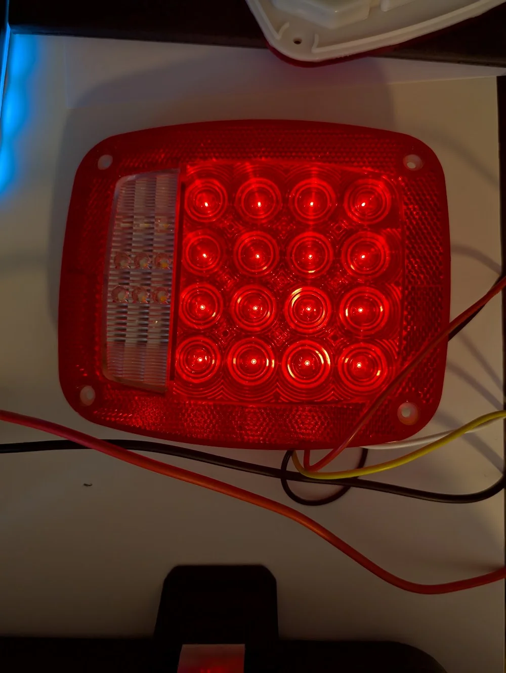

Most people likely don't care what color wire does what, since Blaine includes a pigtail that works and you just match them up - but in case you get curious like me:
  • White -> Ground
  • Black -> Running/Parking Lights
  • Red -> Brake light (bright)
  • Yellow -> Reverse
They draw from about 0.09A to 0.22A, just as a reference. There's plenty of pictures around of their brightness, and it's easier to picture on a jeep outside. But right now I just have the bench power supply, so it's bench shots and my potato changing exposure...
Running:

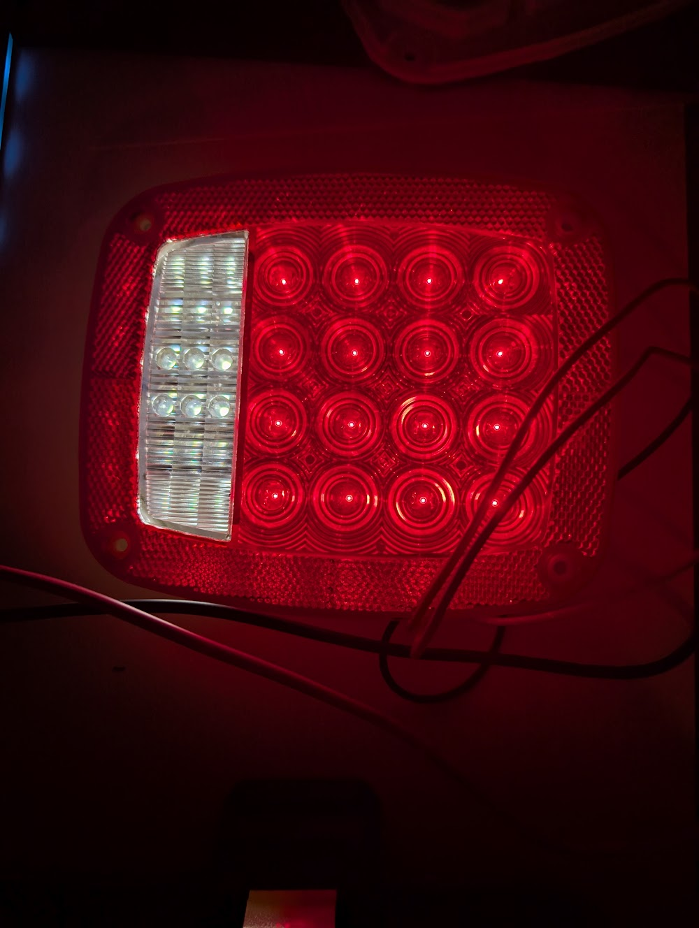

Braking (the exposure really doesn't do this justice - notice how the table is way darker):
Reverse Only:
Braking + Reverse:
  • White -> Ground
  • Yellow -> Reverse

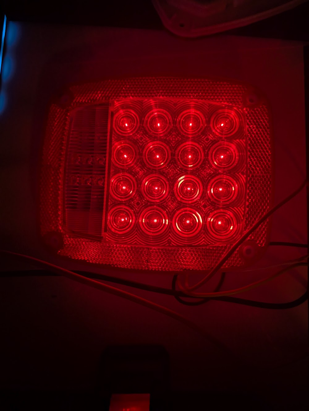

Running:
Reverse Only:
Braking + Reverse:

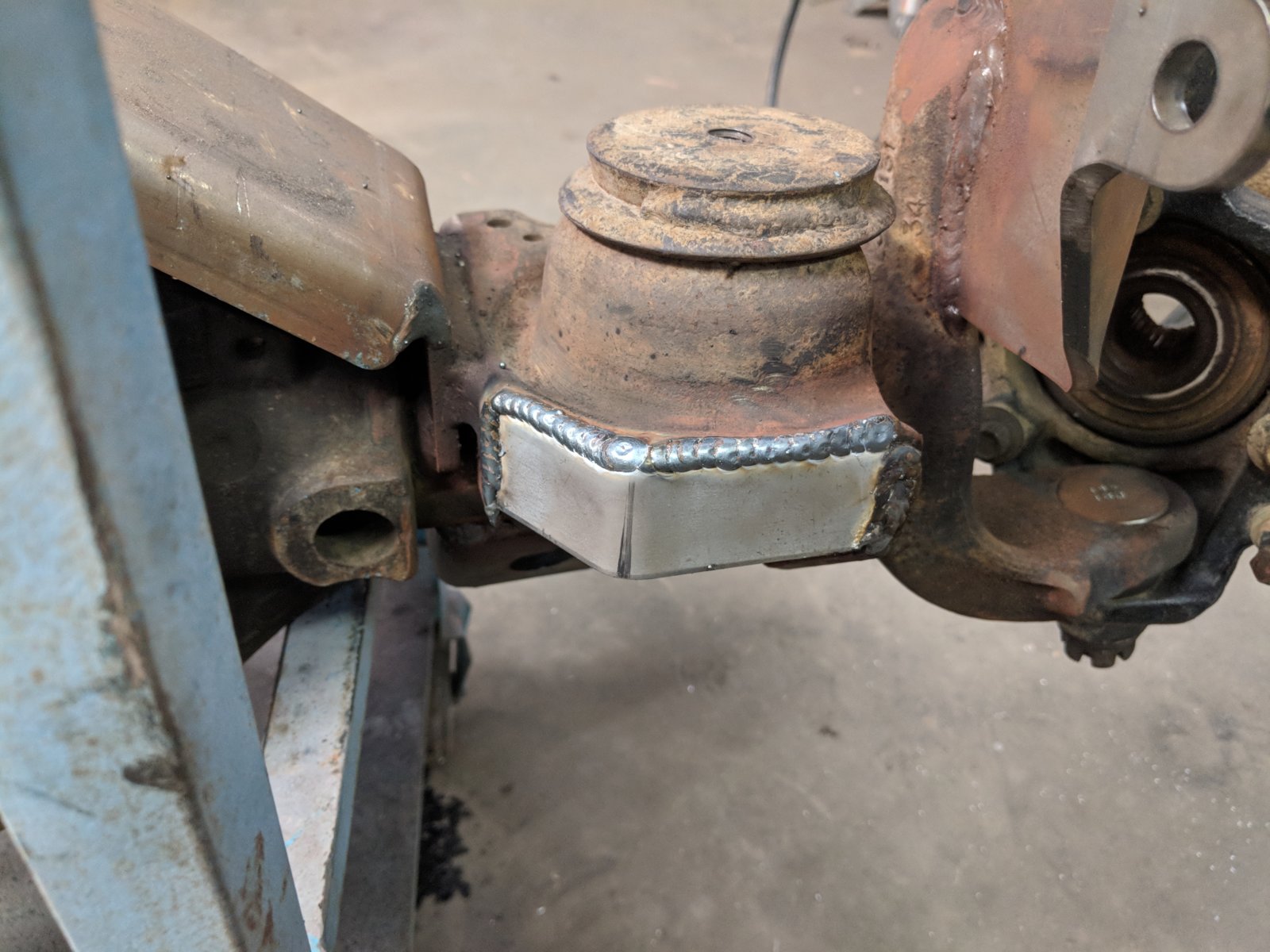

I forgot to share a few more pictures Mike took while I had to work and he was in his happy place doing work for me.
First the front left spring perch trimmed and cleaned up to clear the frame side of the track bar's Johnny Joint.

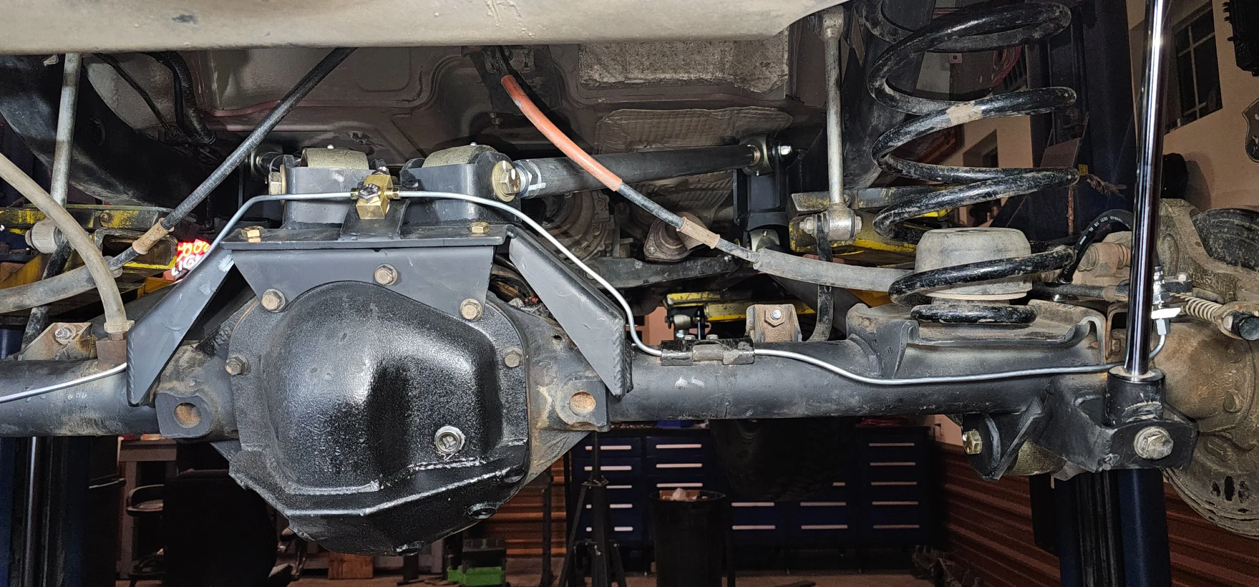

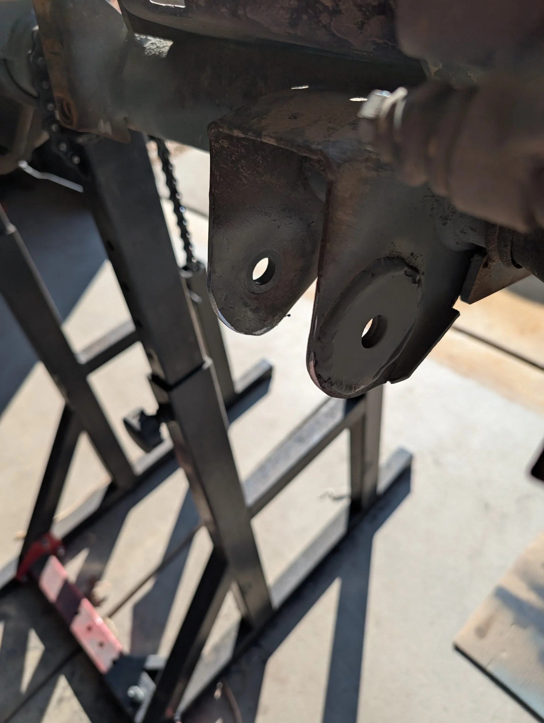

Next how far back the axle is pushed.

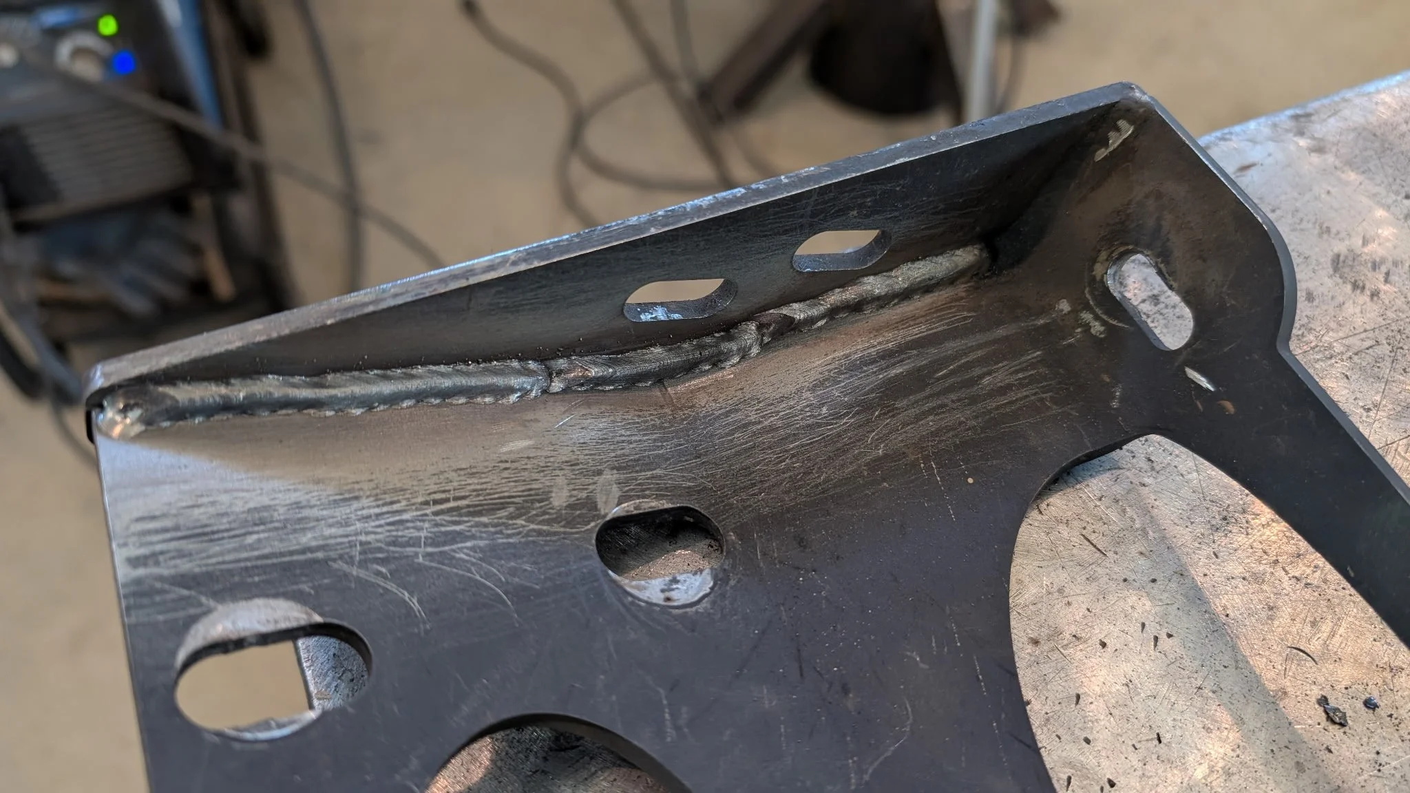

And finally the transmission mount welded down the sides where it could otherwise have bent and cracked over time.
There were a lot of little things that went into this that all add up to big improvements.
