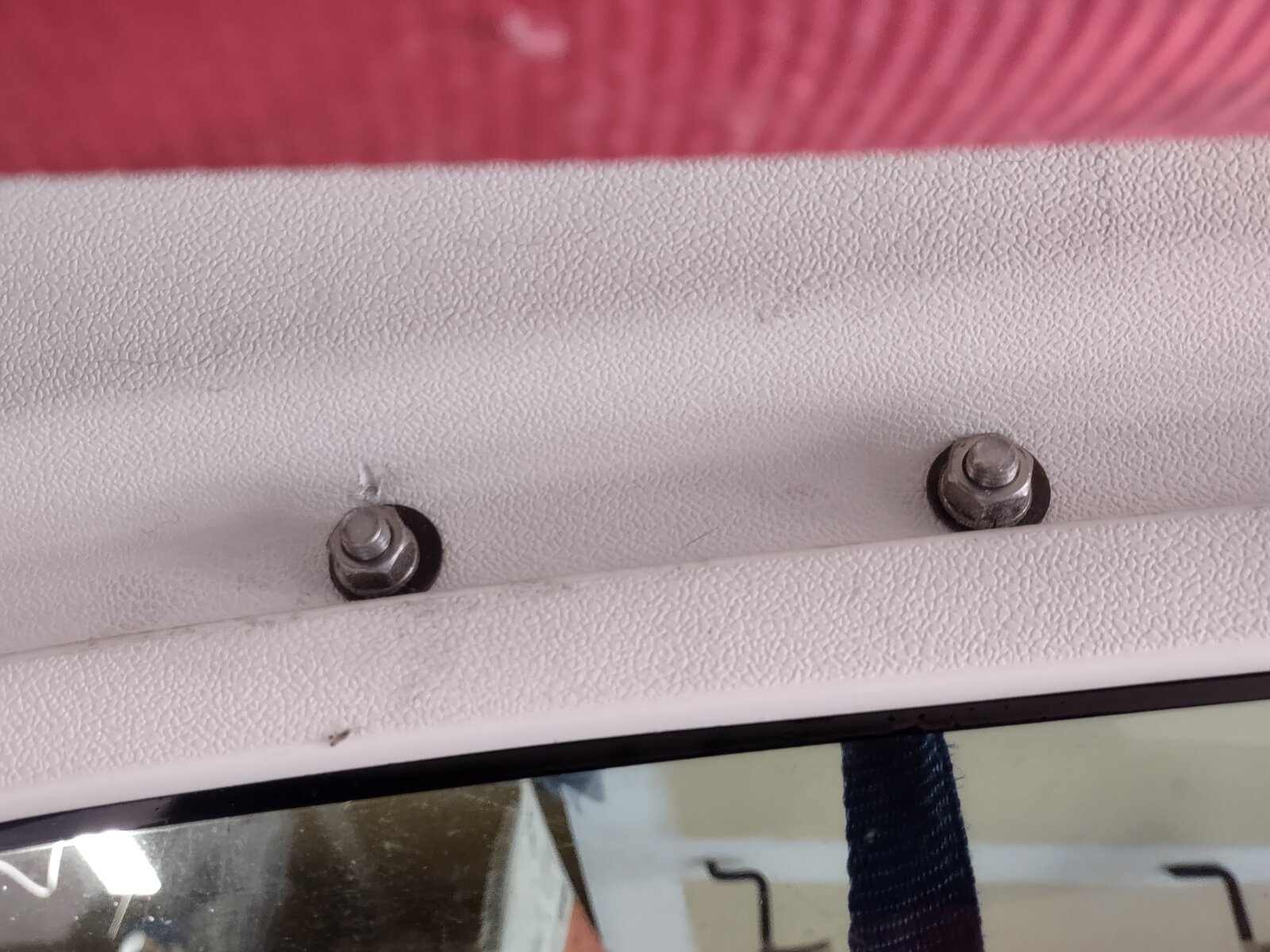

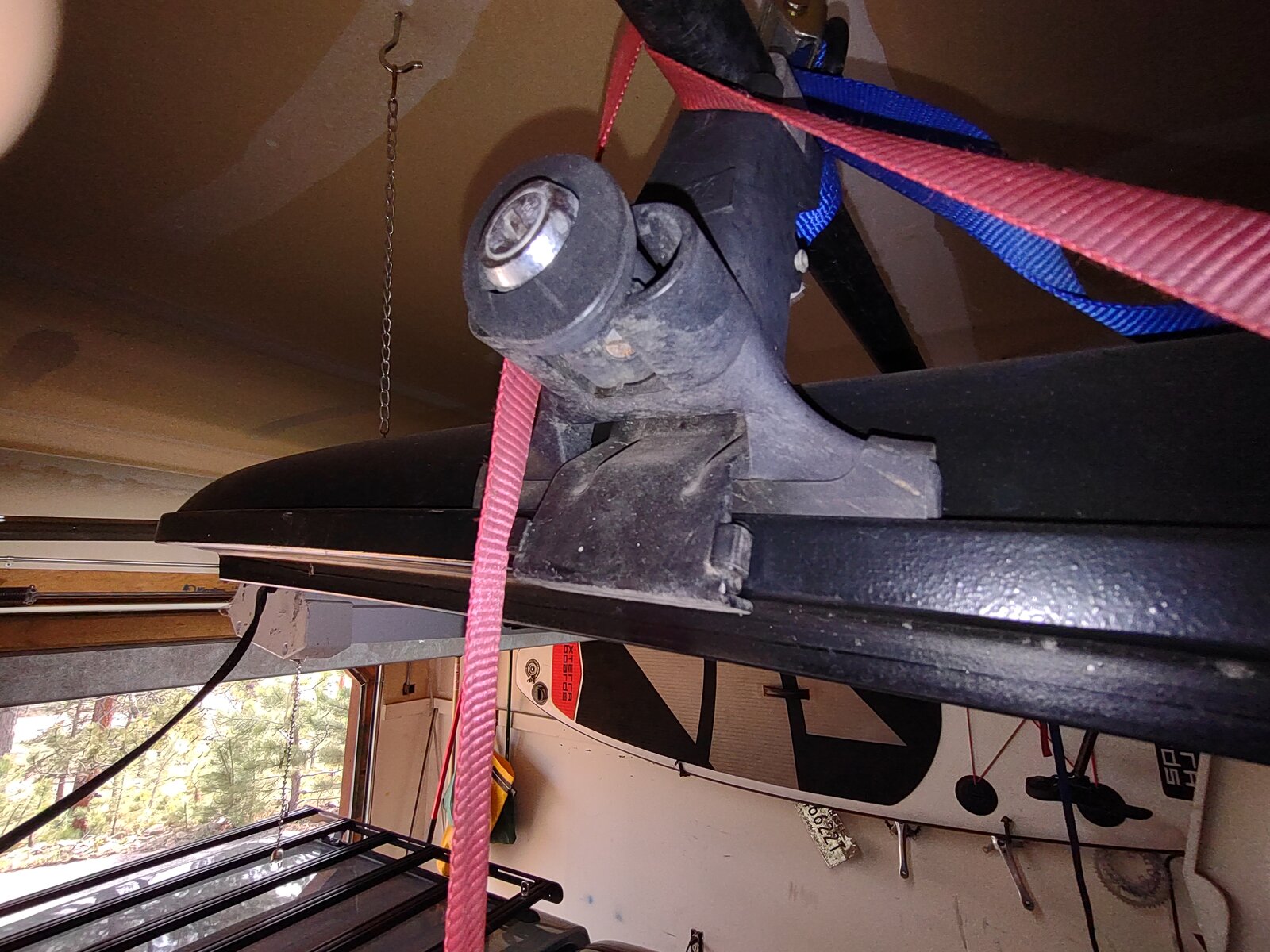

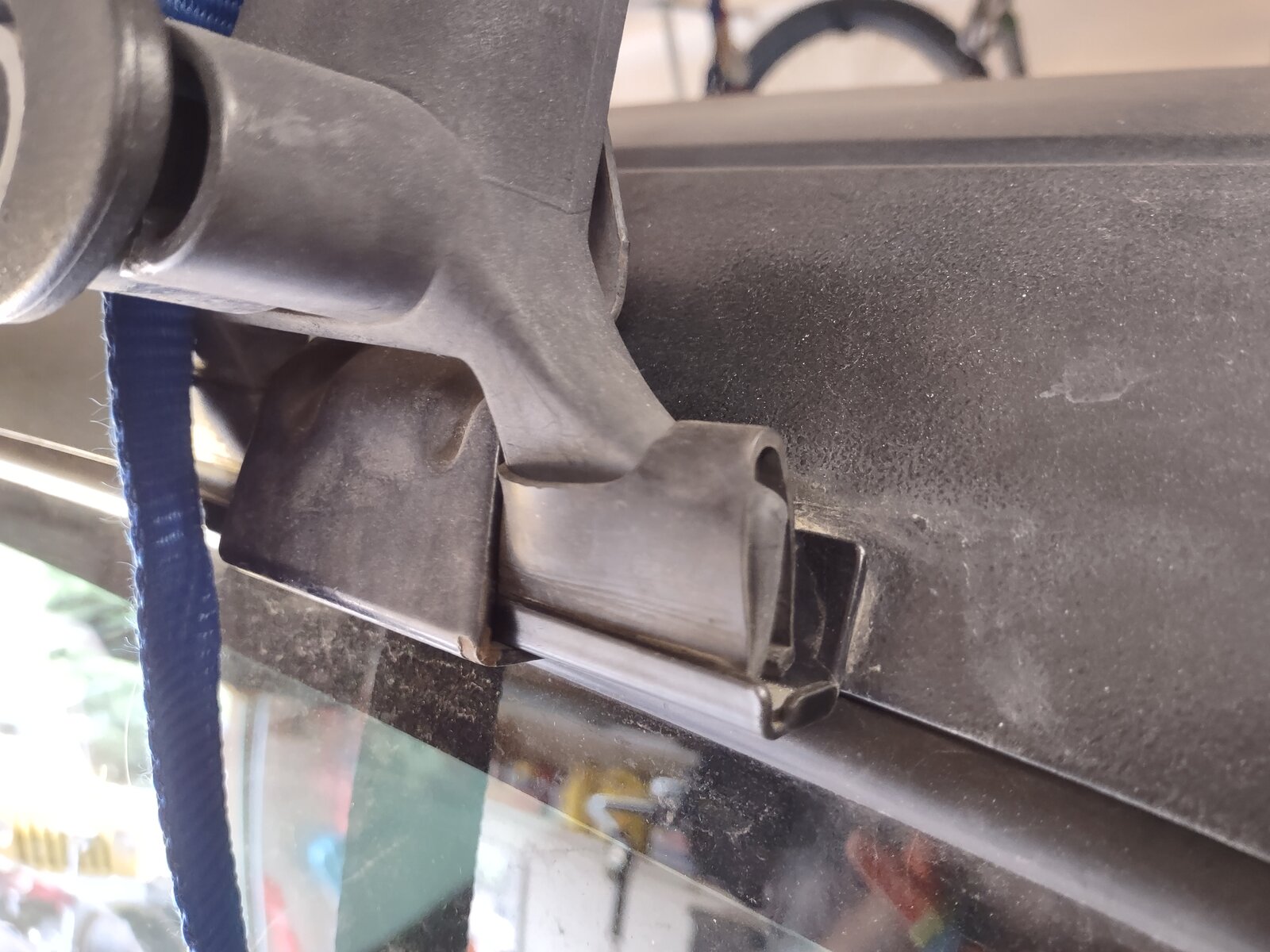

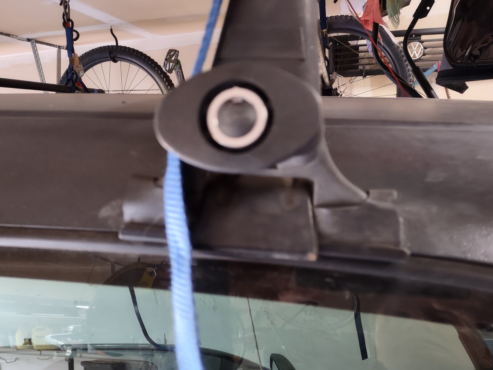

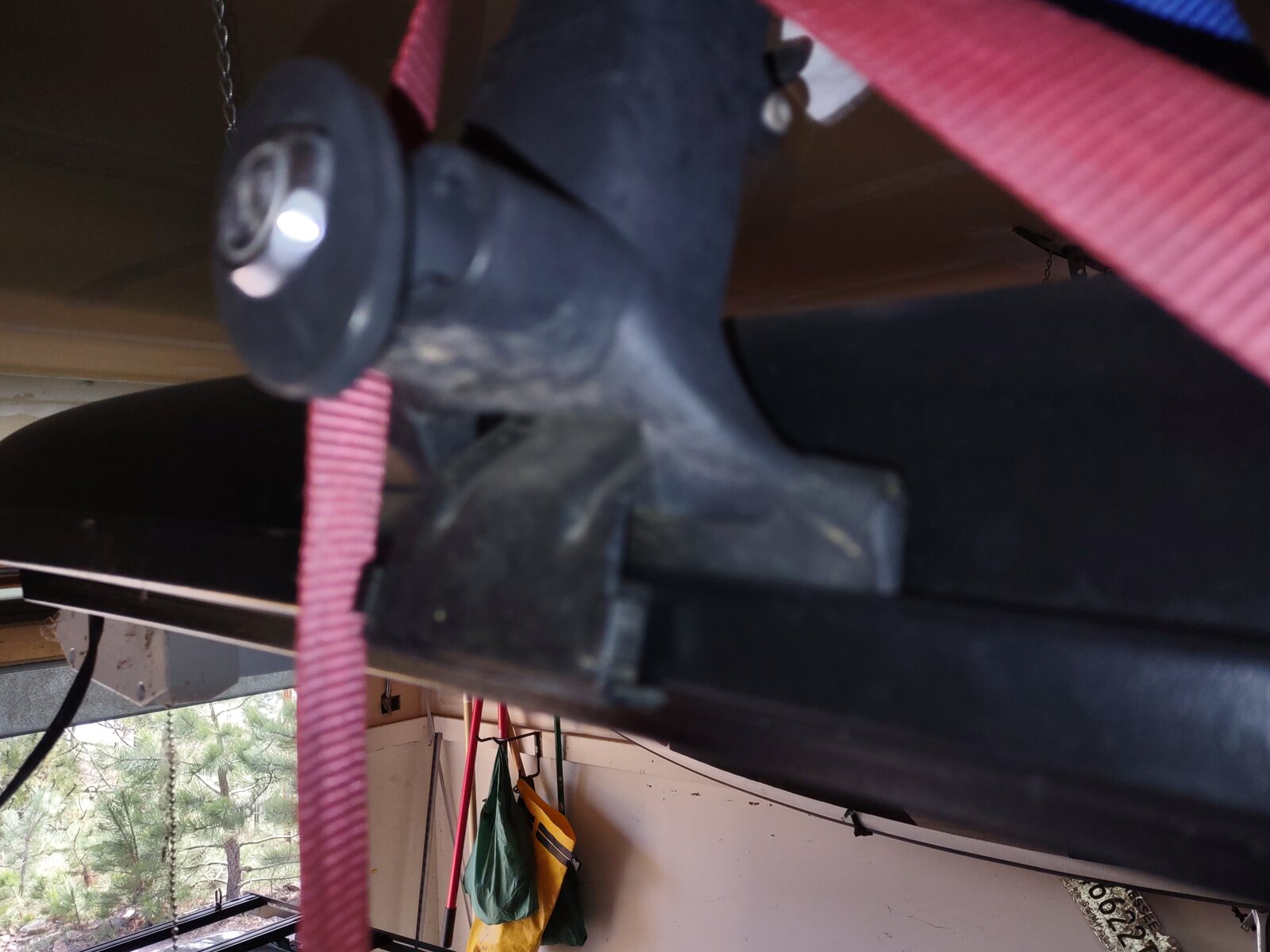

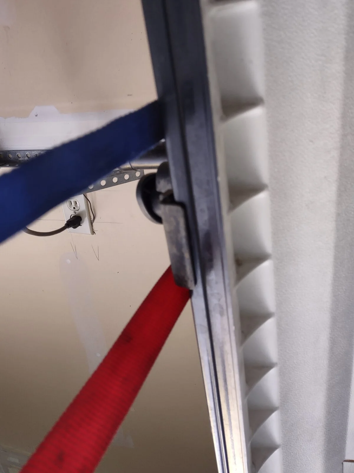

I have Yakima A1 Towers mounted to my hardtop via the front "gutter" channels and two (one on each side) Yakima Wide Body brackets mounted vertically above the back windows. I mounted them 36" (or maybe it was 42") on the center of the crossbars. I've hauled Load Ranger boxes, several different bike racks, and a couple of paddleboards on top without any issues and zero leaks. The A1 Towers and crossbars fasten securely enough to use when lifting the top and in storage. Your mileage may vary. I use the A1 Tower set-up on other vehicle rain gutters so the total cost was in the Wide Body mounts, ~$40.

Pictures?
