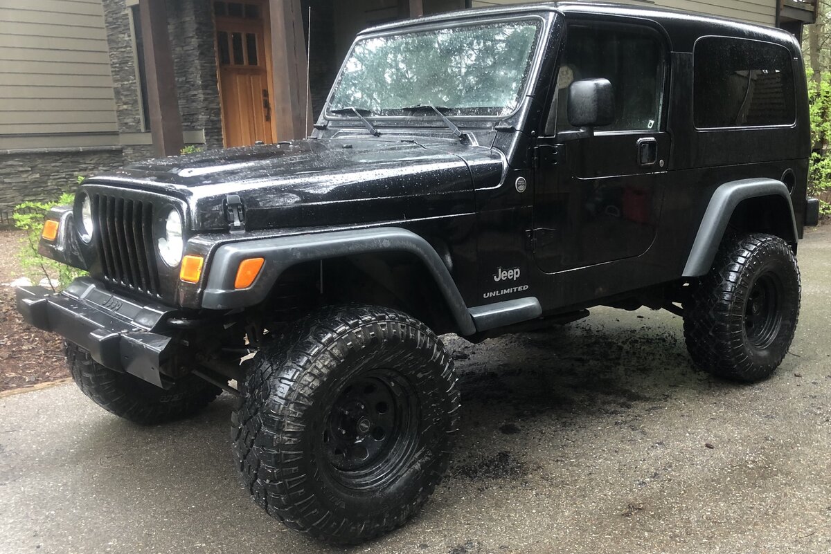

Back to some other upgrades, I managed to get my hands on some wide stock style flares. I’m warming up to the look and loving that my windows aren’t painted brown every time it’s wet out. Gonna miss the aggressive stance of exposed wheels but such is life.
Mods for the future are repainting the head light bezels, try to buff out the faded hood paint (or re-paint it), repair rocker rust, paint and install rock sliders and get the tear in the soft top and the rear window zipper fixed!
The photo below is how she’s sitting now:

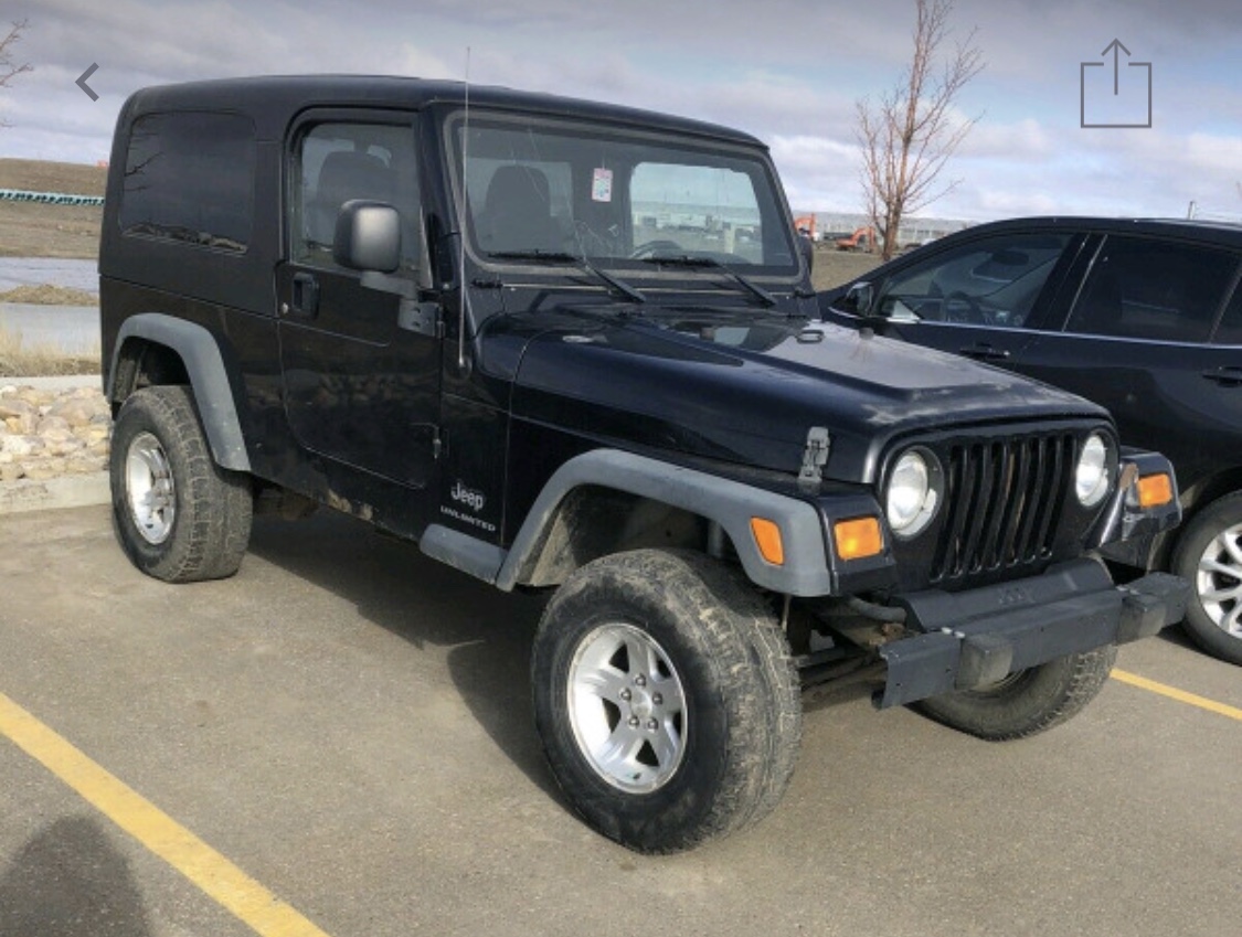

Fast forward about 4 years or so and a LJ came up on one of my typical kijiji searches and it ticked all the boxes!
It had insanely low Kms on it, around 109,000km, but I’m sure those were hard kilos! Hood paint was all faded, rusted rocker panels, a well used 2.5“ lift, spider webbed windshield, bald 31’s, dented drivers side fender and a pretty filthy interior. I got the feeling it was almost exclusively used as the PO’s slightly roomier side by side / quad.
Really basic trim level and options, meaning no A/C, cruise or fog lights. My TJ never had anything fancy either, might do an A/C install down the line for the occasional really hot BC summer days.
But it has dual tops, a 4.0, the 6 speed manual NSG370, minimal body or frame rust (excluding rockers), a Dana 44 with the limited slip in the rear and most importantly it’s a LJ!
Here‘s some photos from when I bought it...

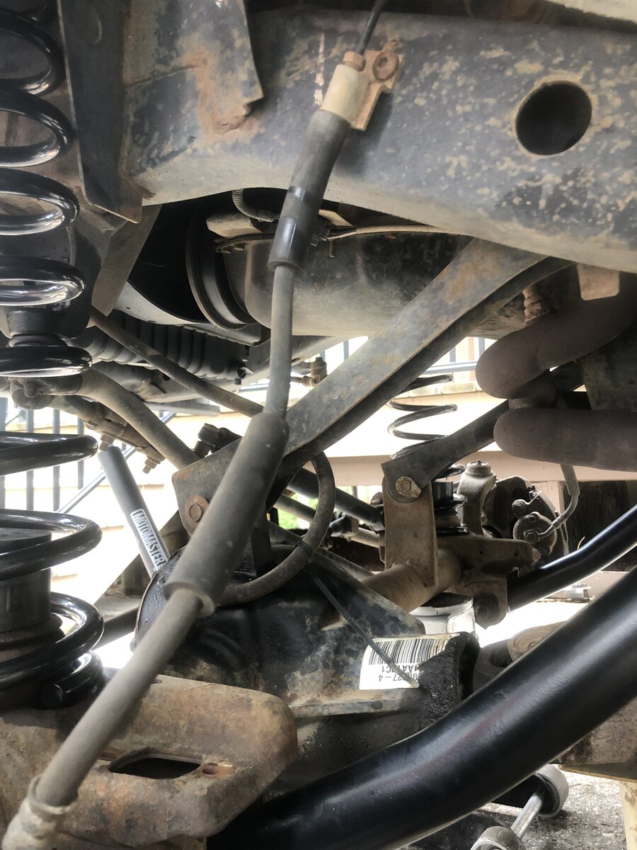

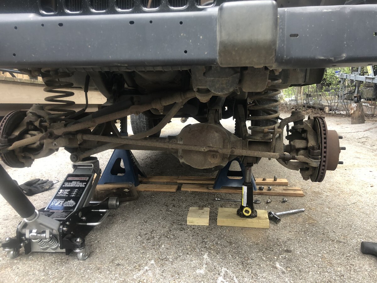

So, it needed new tires and the shocks were leaking, what’s a guy to do other than throw in a new lift and some new 33” shoes?
Went with a Zone 4” short arm suspension lift, a procomp adjustable track bar, 15x8 procomp 97 steel wheels and 33x12.5r15 Duratracs. Almost identical to my previous build, but hey, if it ain’t broke?
Sorry for the limited and poor photos of the lift install, I get caught up with installing mods! Taking photos is usually an afterthought unfortunately.
Only real issue I had with the install was a stuck front lower control arm bolt at the axle, a little time with the torch and the BFH and it eventually came free from the bushing.

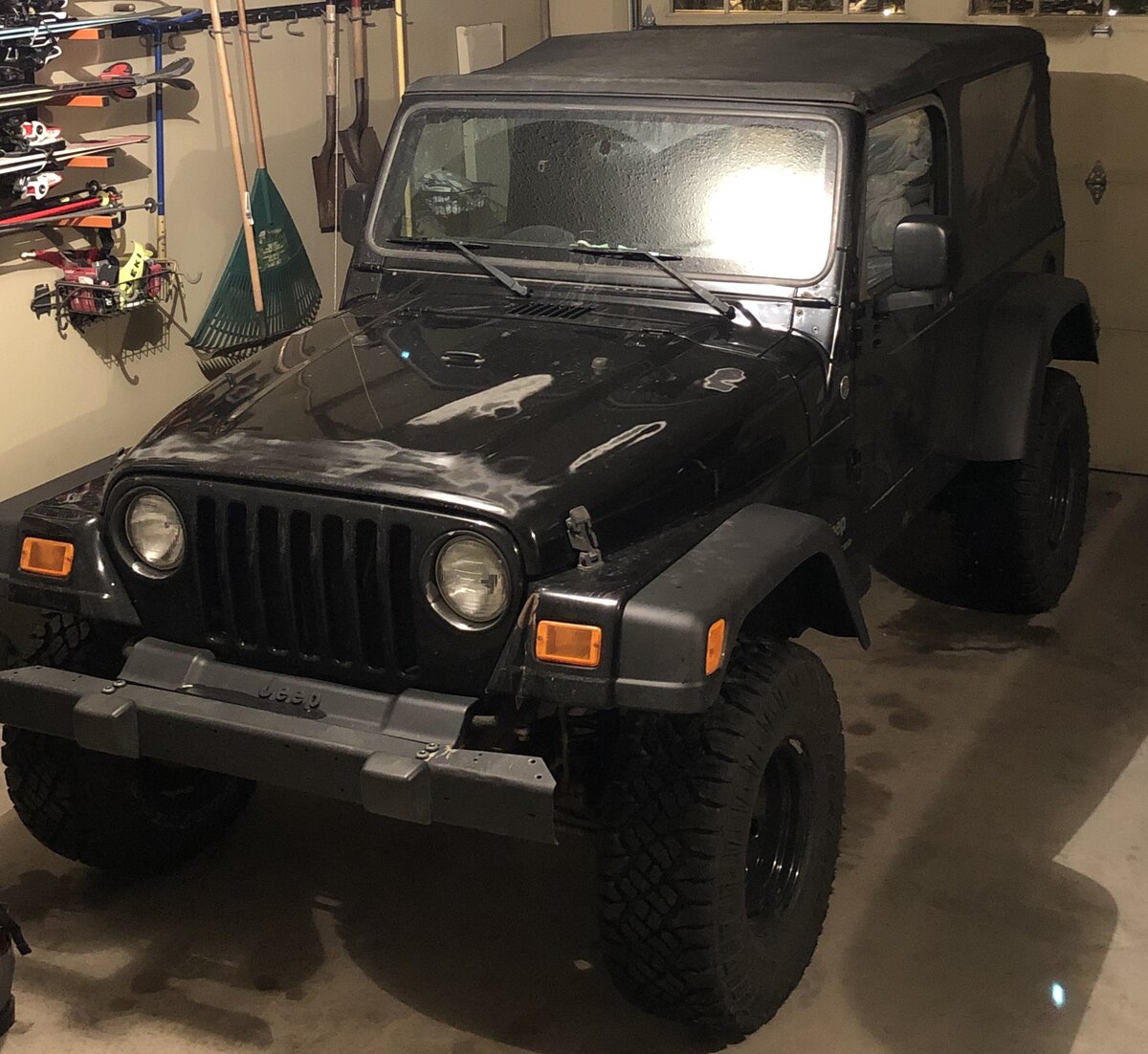

With the lift and adjustable track bar installed this is how it turned out! (Borrowing my old TJ‘s tires at that moment just to get the full effect.)

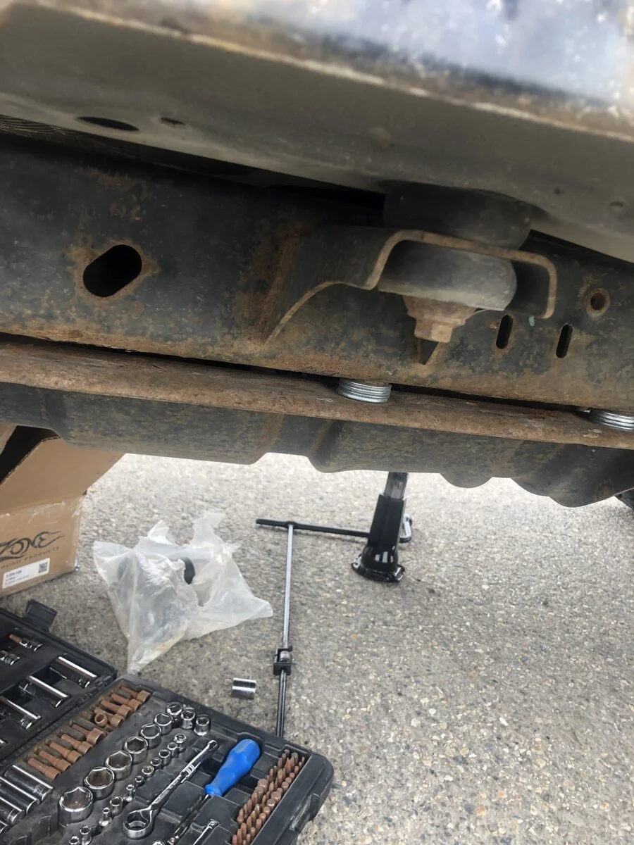

Past this point reality swoops in with a swift kick. About a week later after the lift install, on my way home from work, I almost lost my skid plate on the highway. I naively neglected to install the transfer case drop pucks in the place of the PO’s stacked washers. As it turns out, the washers were stacked too high and the guy had used the factory bolts which were not long enough to get more than a few threads into the frame with so many washers.
The reason the plate was only lowered by a few washers was because the PO had installed a low profile transmission mount to correct drive line angles. With the pucks installed 2nd, 4th, 6th and reverse gears would hit the edge of the trans tunnel shifter hole due to the angle that it was sitting at! Luckily I had all my tools and the drop pucks in the back of the Jeep so I put it back together in a grocery store parking lot and drove home using 1st, 3rd and 6th. Only lasting losses were a couple bolts and washers... and a little bit of dignity.
Must’ve been quite the sight for a bystander to see the Jeep roll in there with a skid plate hanging off the side and then some kid jumps out and starts wrenching on it wearing a dress shirt and shoes. I wouldn‘t get these kinds of interesting memories driving something like a modern Camry.
The parking lot repair session, the before photos technically :
