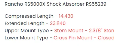

What size shocks did you use for it? I believe I like your idea and that may be what i pursue...
Reactions: 97TJNM
best thing to do is get the lift on and take measurements. Rancho has 3 different lengths but the lift heights they label them with don't always line up that well with reality.
Once you get the lift on and can measure the shock length at ride height, you can go back to Rancho and pick the shocks for each axle that will be closest to halfway between their compressed and extended lengths at ride height. You may end up with the 2.5" lift shocks on one axle and 0-2" on the other, etc.
Rears are measured between the bushing centerlines at each end. Front is measured from the bushing centerline on the axle end to the bottom washer on the frame end.
Would I HAVE to buy the shocks with the kit, or could I use my stock shocks to measure? First time messing with suspension so sorry if that's a silly question.
buy the Zone kit without the shocks, install and measure with current shocks or no shocks at all, then order shocks accordingly.
Would these two shocks be interchangeable? left is shocks that come with a 4.25in combination lift. Right is the ranchero 2.5in lift shocks.
