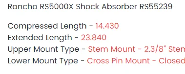

more or less. The Ranchos trade some downtravel to get a little more uptravel. Not a bad thing as long as the downtravel wasn't short to begin with.

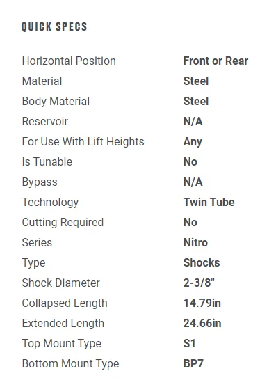

Quick question.
I would have to raise my front shocks and add bump stop to center their travel.
Is it worth giving up 1" of up travel to add 1" of down travel?
Quick question.

So if all that uptravel you have is usable, I wouldn't trade it for more downtravel unless you feel like what you have isn't enough
I have 5.5 up and only 4 down.
The shock and tire are both at their limit at full bump stop.
Ideally, I would like a longer shock.
However, a longer shock body means I would have to add bump stop.
Sorry to hijack this thread.
Correct. The alternative is to modify the shock mounts if you want the travel bias to be different.
