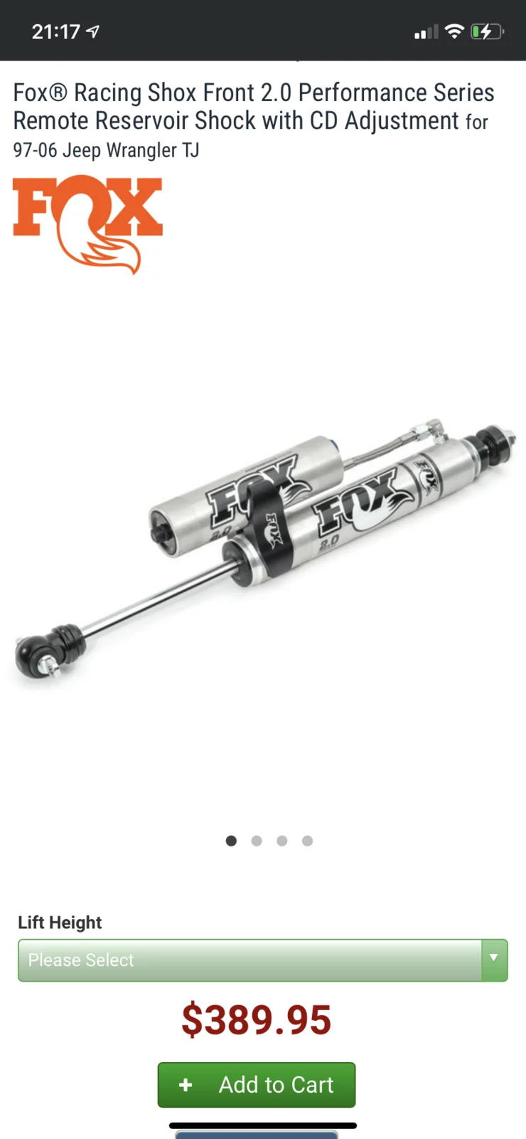

I just bought 4 inch lift RC. I was thinking to change shocks for fox ones. I will be better? Will be really worth it or still a hard ride?? Thanks
I was thinking this ones front and rear. Is too much? Will be a good choice??
