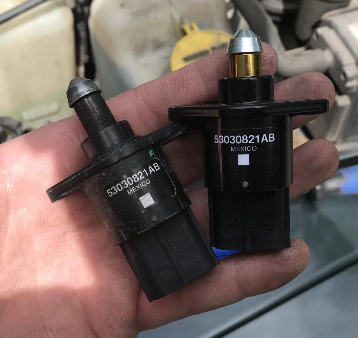

Update: IAC replaced with Mopar part. The pic shows some “slight” variation. Note that in the pic the o-ring is missing from the new IAC, I did install it!
I’m sitting in my idling TJ. Initially all seems well. I’ll give it a few days since the issue has been intermittent and I previously thought cleaning the IAC fixed it.
I must say that the last three time out prior to this the issue did not present itself.
Issue remains resolved - zero idle issues and I’ve driven the crap out of it yesterday and today.
