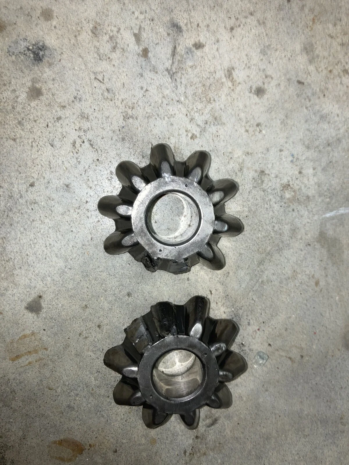

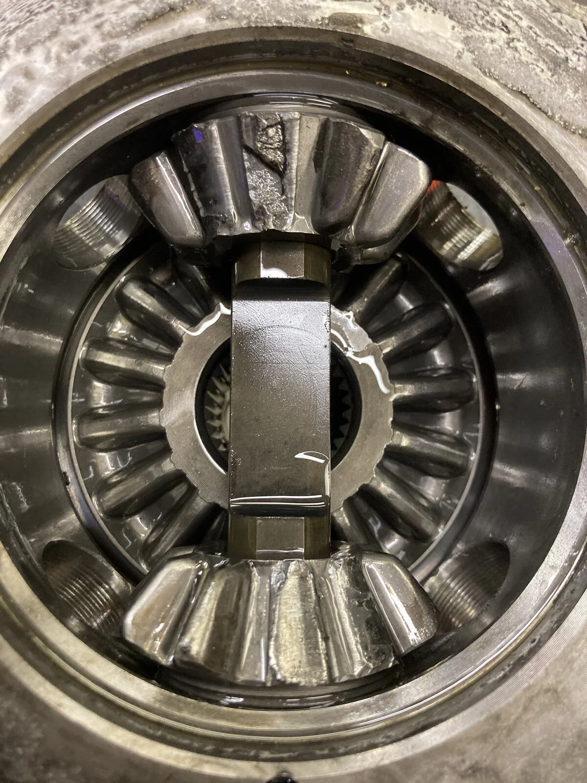

Finally blew up my front Rubi locker at Hot Springs ORV last weekend, and pulled it out tonight to inspect the damage: spider gears have broken teeth! From some searching I see others have done this and you can't get the gears anymore. Curious if anyone has any laying around? Or if anyone has compared them to normal Dana 44 spider gears or others to match them? Be nice to fix before I drop a grand on an ARB.

I'm running 35's on my TJ. The front Rubi locker only having 2 spider gears compared to 4 on all other aftermarket selectable lockers is the obvious weak link. I'm certainly not going to replace with another Rubi locker. I was rock crawling on 4 fingers at Hot springs ORV, wasn't doing anything crazy, front end was locked and I was burning the tires to try and get over some huge boulders. On the final climb out of the trail, noticed the front wasn't locked and went back to camp to pull the diff cover: found pieces of the spider gears in the bottom.
