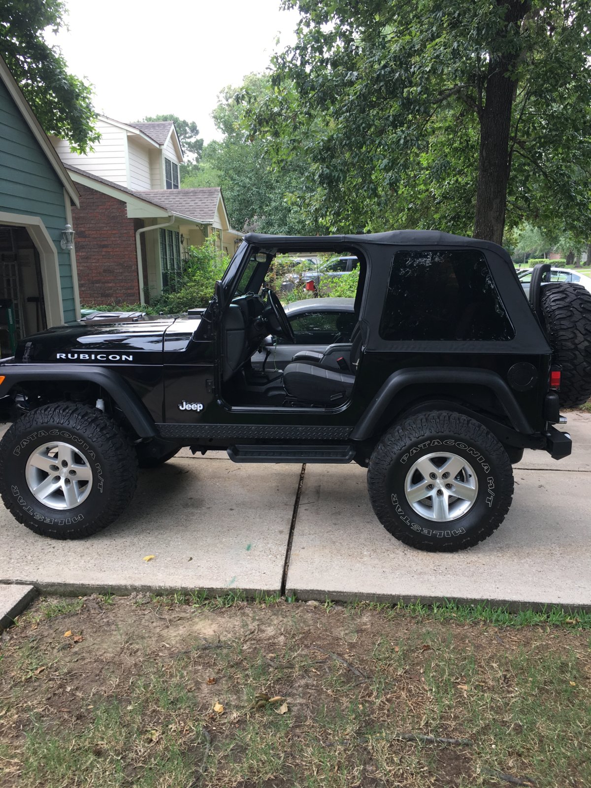

This is my rig with a 2 inch lift and 265/75R16 tires.

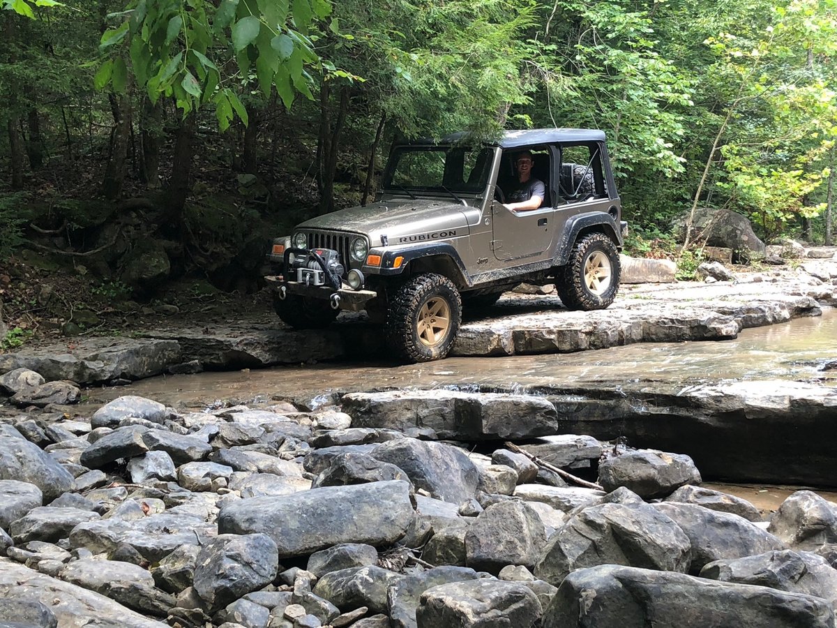

My 06 TJR on OME 2 1/2" lift.

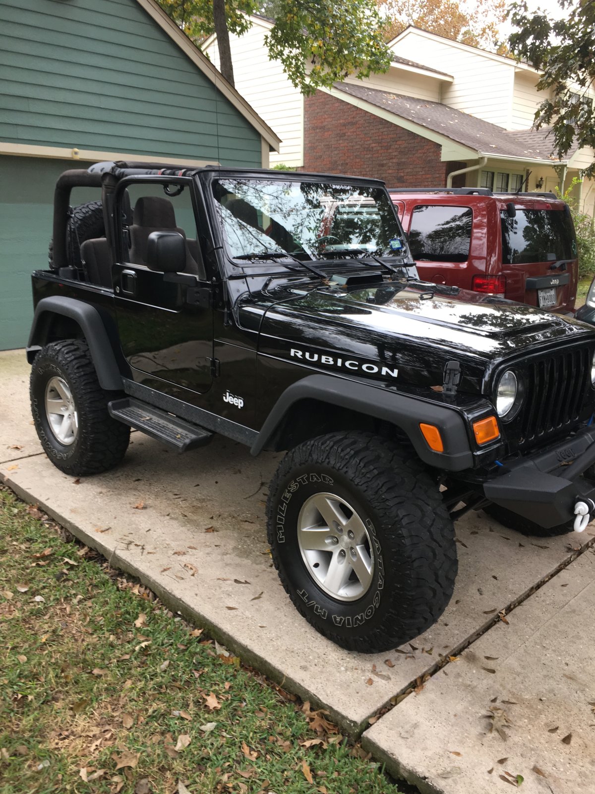

Had 265's on the Moab rims too. No rub anywhere. Rides nice at 25 psi.
