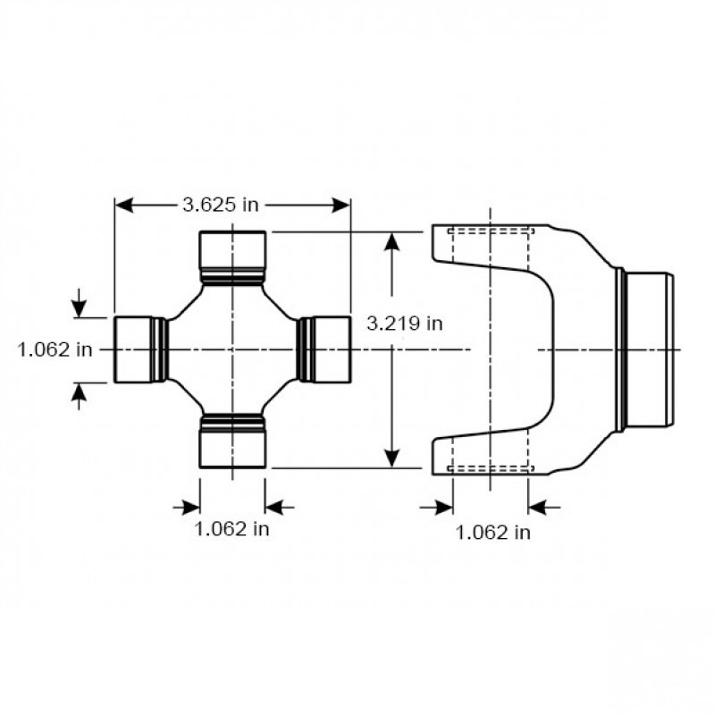

This my help it is a 1310 to 1330 u joint conversion. If I read it correctly one side is 1310 while the other is 1330 so you could essentially use Dana 35 yoke with Rubi D-Shaft

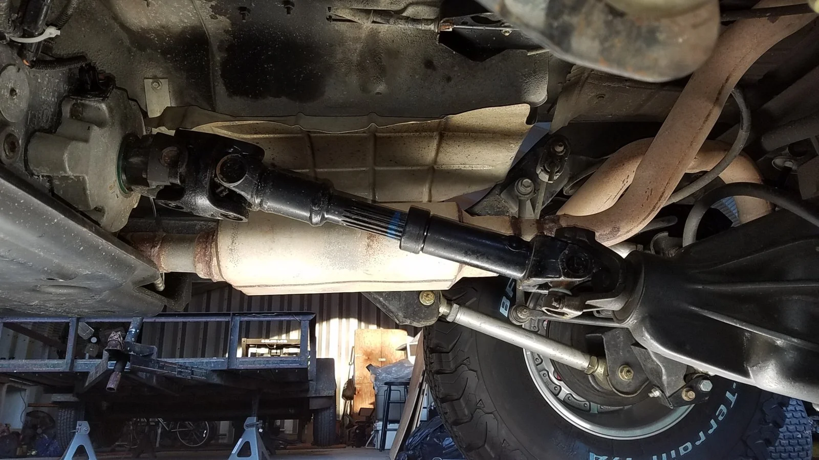

I used the 1310x1330 u joint on the front diff and had a new driveshaft built that has 1310 to the t case and 1330 at the rear diff. The Dana 44 yoke is longer on the diff so it makes for a shorter driveshaft by about an inch if I remember correctly
