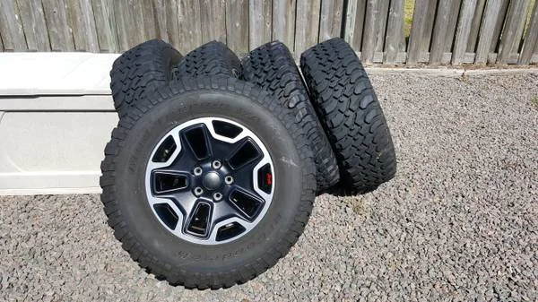

Curious if these would fit on my 06 TJ or do I need wheel adapters or wheel spacers.
it's as simple as getting the adapters? do the adapters push the wheels out further, or does the offset make it negligible? Not trying to be a pain but I have a set of 4 JK's sitting in the garage that i'd like to try and don't want to spend $200 in adapters if there are other areas of concern. I too have an '06 TJ
