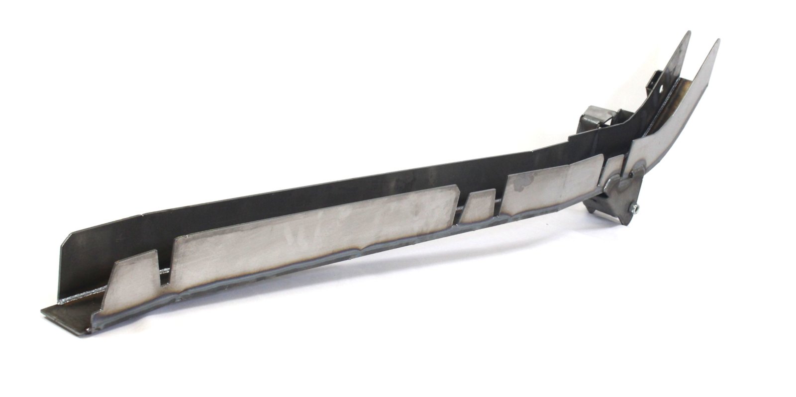

That is certainly an eye sore but that can absolutely be fixed. Safe-t-cap makes that whole rear trailing arm that can be welded in after cutting away the rusted out section. I've personally done that with mine except I did the entire length from the center skid back including the trailing arms on both sides. Major job, but if you have welding access you can save some serious $.

I bought two of these. This basically replaces all of the lowest part of the frame and should take care of any rot that I didn't find poking around. They also have front sections if I need to go that far. The one bad spot is really a head scratcher. I'm not sure if something got trapped, or if the internal e-coat had issues or what? The other side really doesn't look bad at all. I'll know more when I start cutting.

Well apparently in that spot, there is an area where water can be trapped and there is no drain hole for it to escape so it just kind of sits there rusting away from the inside. If you notice on the new piece you can there will be an added drain hole in that spot to prevent future issues in that spot. That is btw the same section I installed.

Anyway, knocked that out and began cutting. I rented a hypotherm plasma cutter to help out. That was a very good decision - made quick work of cutting. I was slowed down a bit since every single skid plate nutsert was spinning and I had to cut little windows in the frame to get some vice grips on them.
The bottom of the frame (mostly in the back) is rotten. I was impressed how much debris there was in the frame.
This is a shot of the rot compared with the replacement frame sections. I think I'll go with the replacement....

Damn, those pieces of the frame you took out look nasty. Are you only cutting out the bottom of the frame rails and replacing those pieces?
Where did you get those replacement pieces anyways, are those SafeTCaps?

Just the bottoms. The frame rots from the bottom up so the top of the frame is actually in great shape. Then you slip the pieces over the remaining good frame and weld it together.
I bought them from Morris, although they were just drop shipped from SafeTCap.
