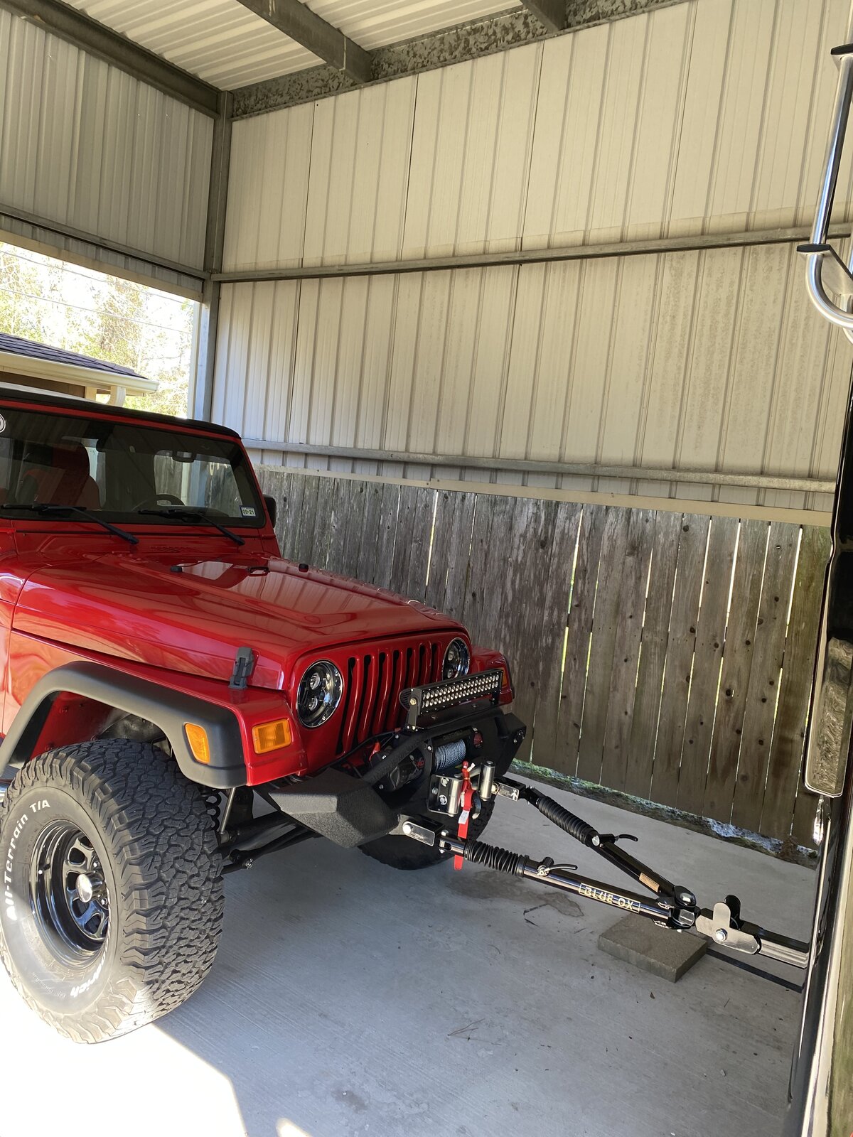

I like my Smitty winch bumper with the recovery lugs. ‘No plate needed. I just hook up the Blue Ox tow bar & go. ‘Works perfectly.
Had these attachment points custom fabbed to fit over the OEM bumper and tie into the frame. No extra plate, doesn't effect clearance and works great with my Blue Ox.
Reactions: Farmergreg
Not a very good picture, but this is my Roadmaster tow bar attached attached to my Smittybilt bumper. 30k miles of flat towing with no difficulties.
