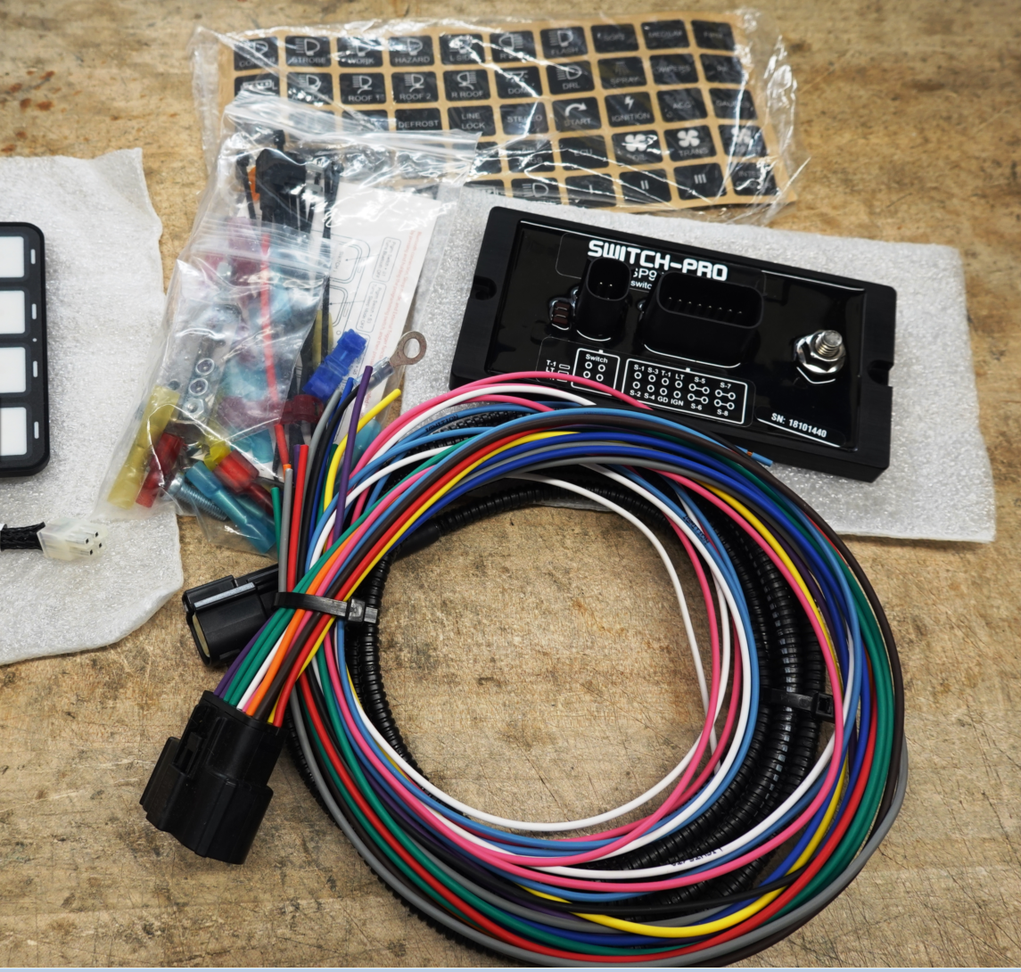

As part of my highline, I am in the process of eliminating my second PDC from an XJ and changing to the SwitchPros controller.
There are several reasons for this. Space efficiency was a major one. There isn't room for two factory PDC boxes in a highline. Related to space is the reduction in clutter with the wire management.
And while I do prefer the aesthetics of the Carling switches over the SwitchPros control panel, over the last 8-9 years of messing with switches, I have not found consistently reliable Carling style switches. Currently, half of mine work. Meaning I do not have functioning aux lights. My expectation is that the SwitchPros will be reliable.
The SwitchPros is expensive. But after some quick math adding up everything I would be buying to rebuild and reconfigure my existing auxiliary PDC, the SwitchPros ended up not being much more of an expense on an already expensive project.

Mainly due to the AUX being the amateur copy of the professional version that was designed for race cars in the offroad world. The amperage functions are programmable and built into the control box along with the relays. I've always ignored paying any attention to the Switch Pro stuff due to cost. Then I installed one and I'll never do anything else after that. But, I have a very high appreciation for local folks who are innovative with very high quality products and who also do their manufacturing here.
For Scott- 3 lbs. 4 and 1/2 ounces.
Relay and fuse box- 11.6 ounces
And, some Bussman relay and fuse boxes if anyone is in need. I'll sell them for 1/2 of what they are retail since I will never use them.
Did the 3 lbs. 4 and 1/2 ounces include the relay and fuse box? Even if not, if the whole system weighs about 4 lb, that's a huge weight savings for me. I haven't weighed everything, yet, but for the secondary PDC system so far, my estimate for the total system is over 7 lb.
That included everything that comes in the box including the box.

I would neither take one for free nor install a free one. I've made a point of asking every owner of one that is under the hood of any rig I've worked on how many times they have replaced the relay board in the box. The answer is never zero. I started doing that after a few friends complained about having to replace the underhood part. Not for me.
But, there is no comparison if you look at the relay and fuse box I have laying on the scale. That is the equivalent to the relay box sPod has you mount under the hood. Equivalent part.
