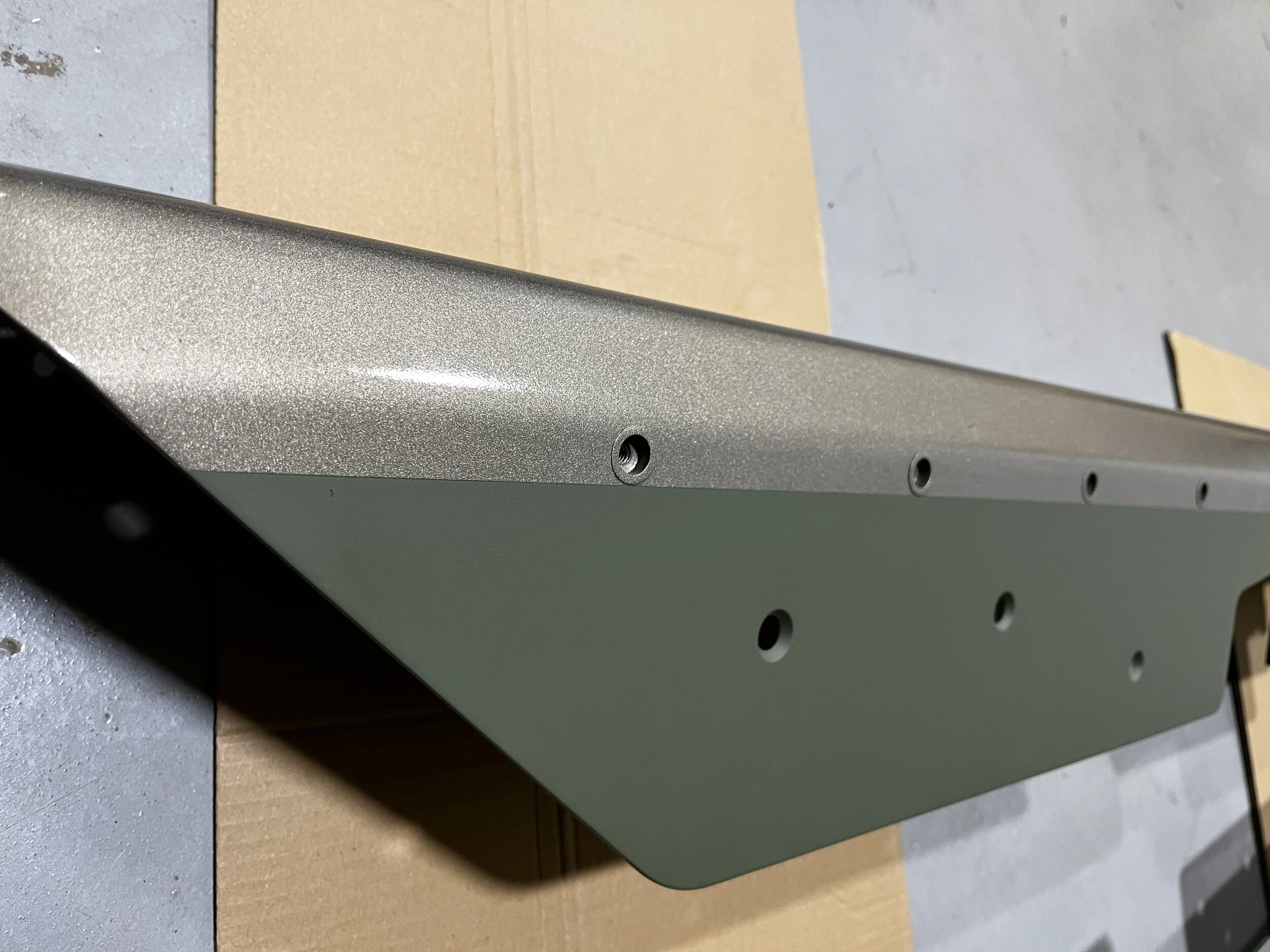

Slow progress on the build this weekend. "Other duties as assigned" again. I modified the Atlas' planetary shift lever bracket for more clearance during assembly and then blasted and painted it OD green (no pictures). Then I painted the bottoms of the aluminum slider backers OD green (I painted the sides Light Metallic Khaki last weekend):
The Light Metallic Khaki went on really well, but the 2K primer top coat was horribly orange-peeled as it came out of the can, and I'm not sure why. Maybe it was old? I don't think I'll use that stuff again. It doesn't look bad in the photo above because the light's at a flat angle, but I'm not at all pleased with my work. Very disappointing, again. :mad:
I'm not going to re-do it, though, because the way the sliders assemble onto the LJ, only about the top 3/8" and the ends between the fender flares and the step sliders are visible. It'll be our little secret... ;)

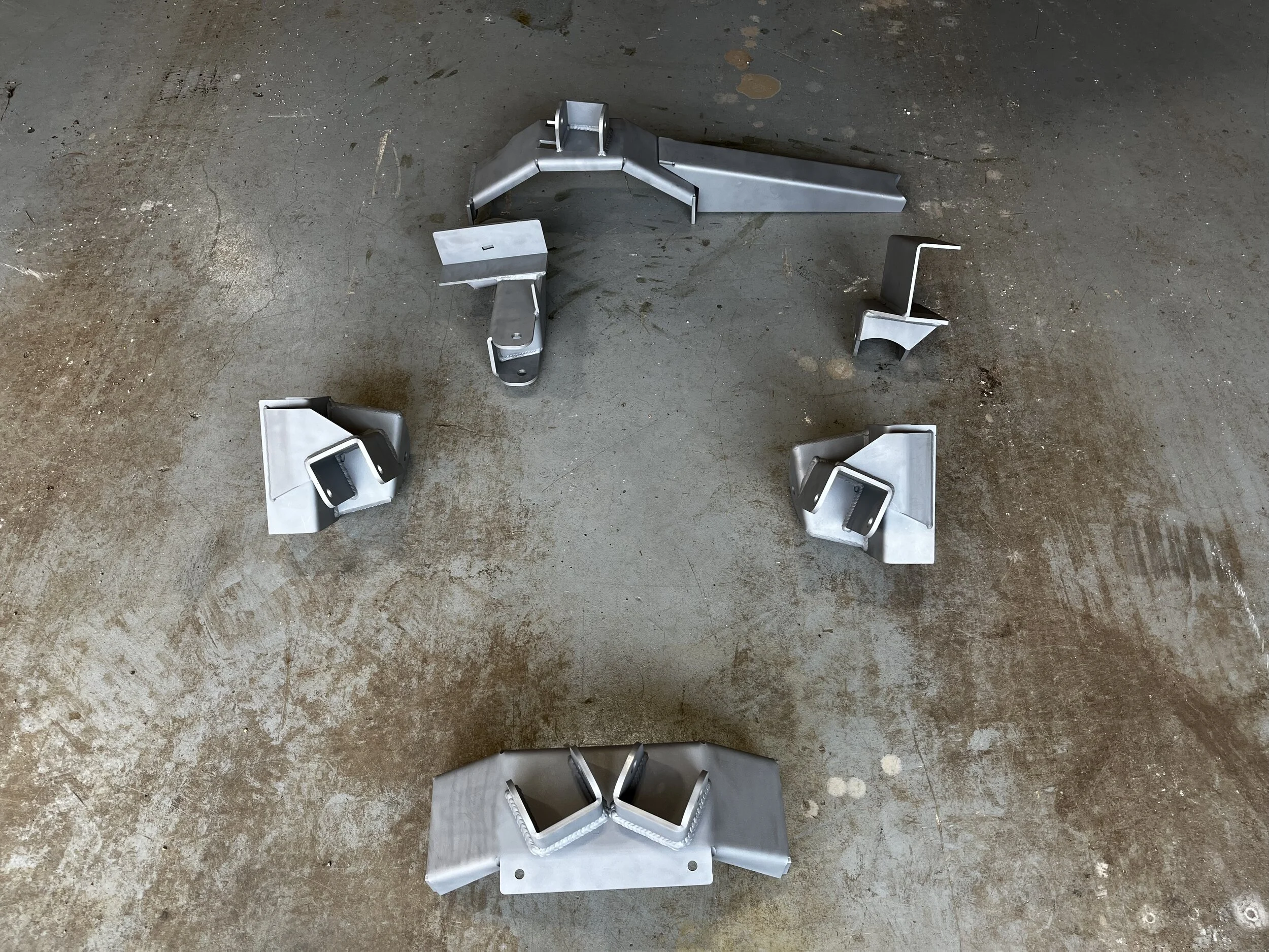

I got the Savvy mid-arm brackets blasted today before getting ready for the Christmas party at my new office:
Tomorrow I'll rattle can them with primer so they are ready for installation. I'll have two five-day weekends to get some work done on that. Stay tuned!

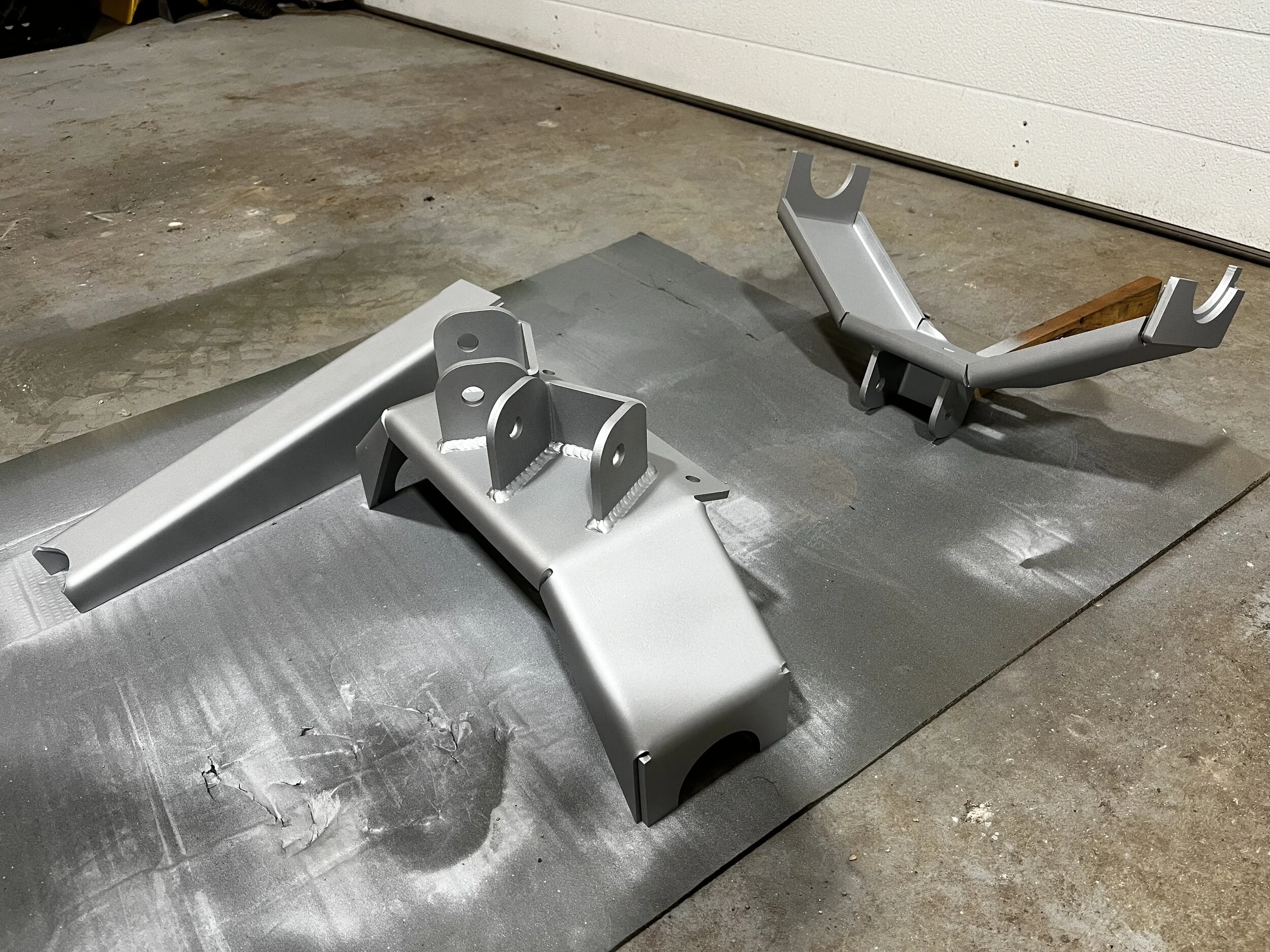

Everything's primed with weld-through zinc primer, ready for installation to start next weekend:
Now I have to find something to do the rest of the day - a rare occurrence for me.

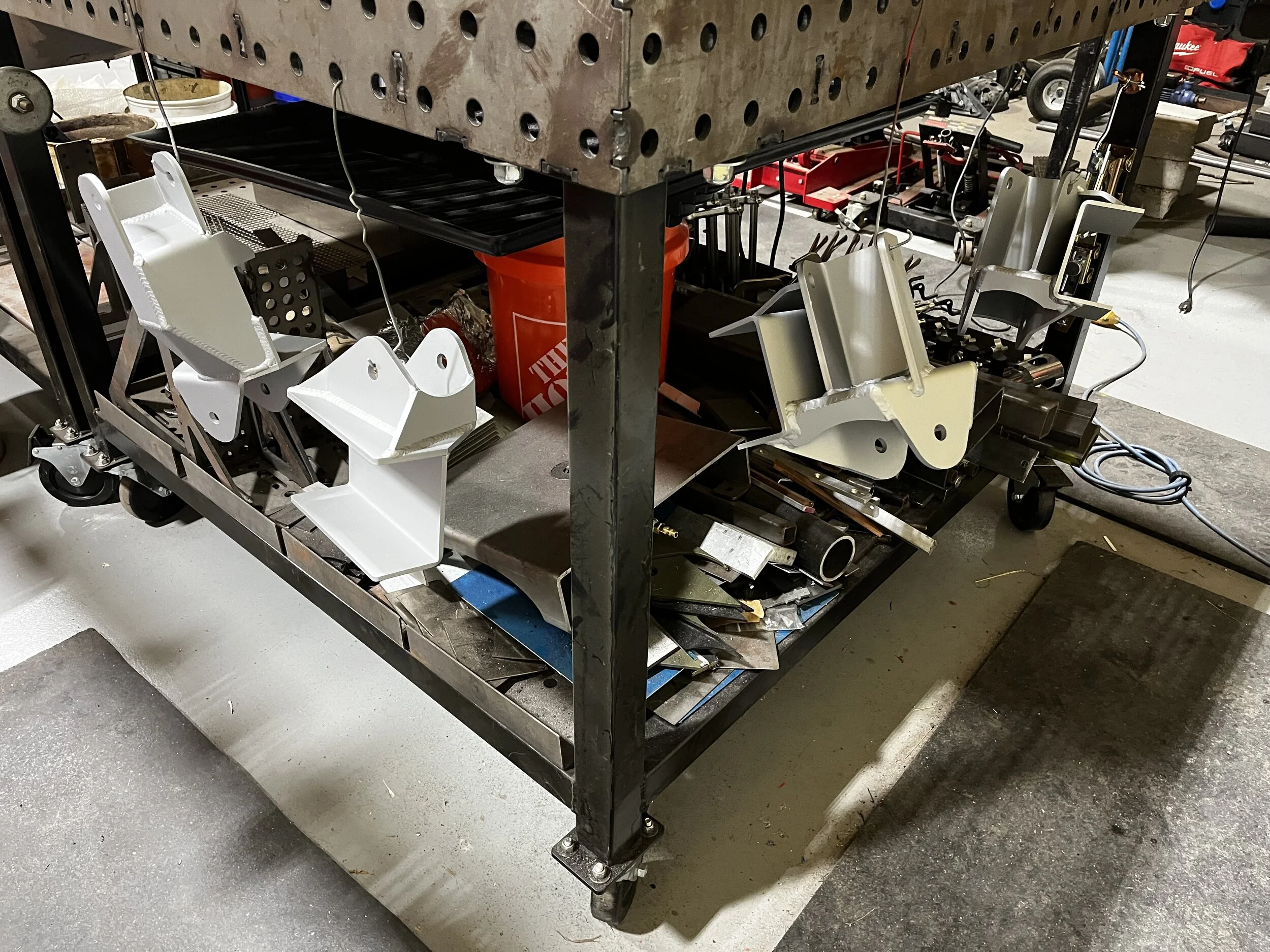

Scott - What's your plan for those corners on the trusses? I'd weld and clean up all those corners before you install, that way you get a good welds on the back. I'd also do that before applying the weld through primer. For me, that primer makes welding more difficult, and I avoid welding directly over it if I can.
Reactions: Wildman
I've only used this primer a few times (I bought three cans, and I just barely broke into the third for this.) Previously, I wire-wheeled along the weld path prior to welding, mainly to avoid the noxious fumes (I also wore a respirator.) I haven't tried welding directly over it, but it's good to know it's not recommended. As for the corners of the trusses, I had planned to weld those during the installation since the wedge-shaped opening is outward. My thought was they were not welded during manufacturing so that you could tweak it slightly if necessary to get it to fit. Otherwise, why wouldn't the welder have welded them when the control arm mounts were welded? Of course, this is Savvy we're talking about. Their QC has failed on every item I've purchased (mostly missing parts, though).
Mr. Blaine had given me a tip that I forgot about until I made that last post - that is to cut off a short section of the legs of the C channel portion of the frame brackets to make welding them in place easier. He said for a hack welder like me (I'm paraphrasing :)), it'll help me avoid gravity causing the weld pool to drip. I plan to cut the legs short next weekend, so I'll have to touch up the primer again. Stay tuned!
