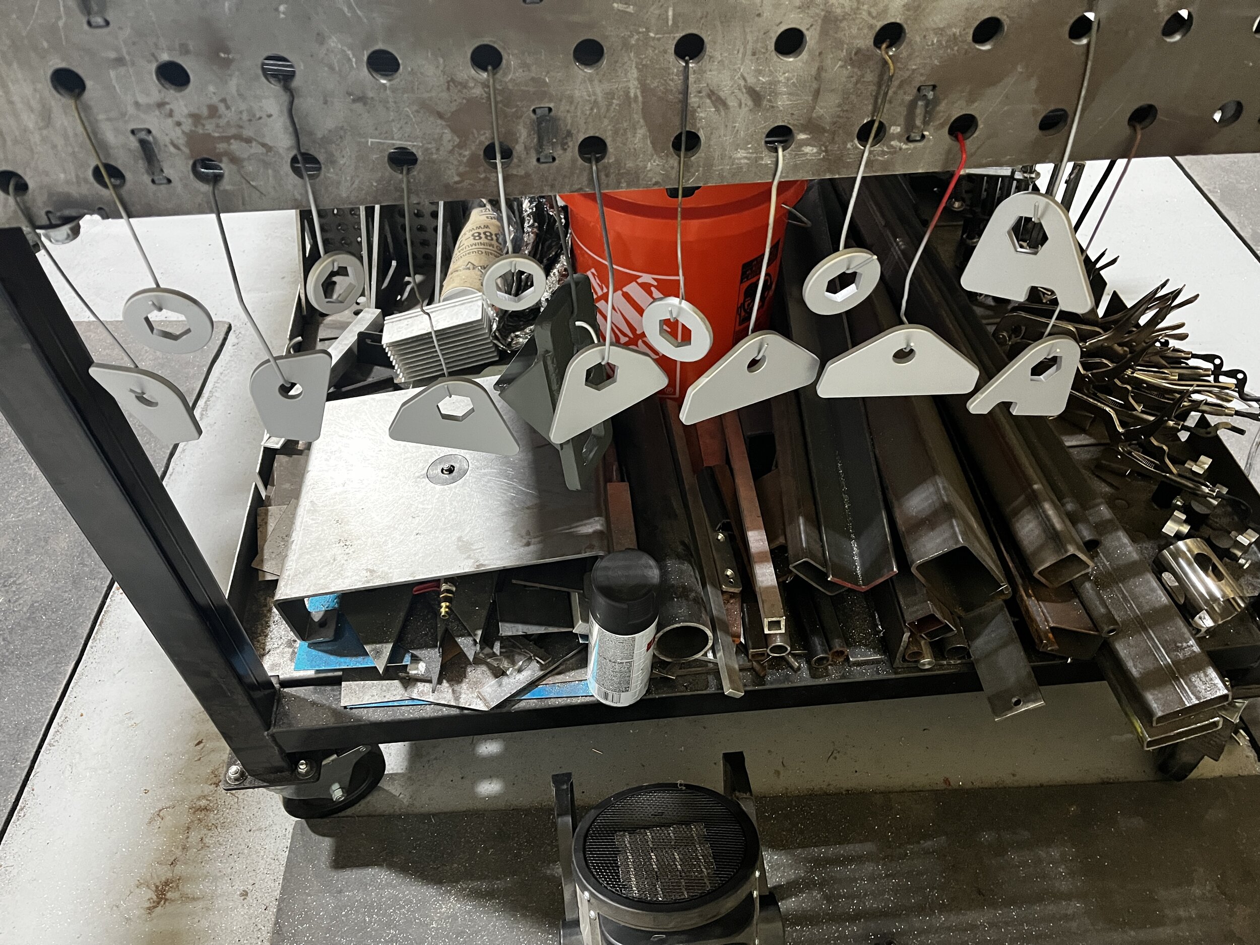

And here are a few after-welding pics:
Tomorrow, I'll paint these, and then it's back to the cutting brake project. I gotta make some progress on those to stay ahead of NashvilleTJ...
