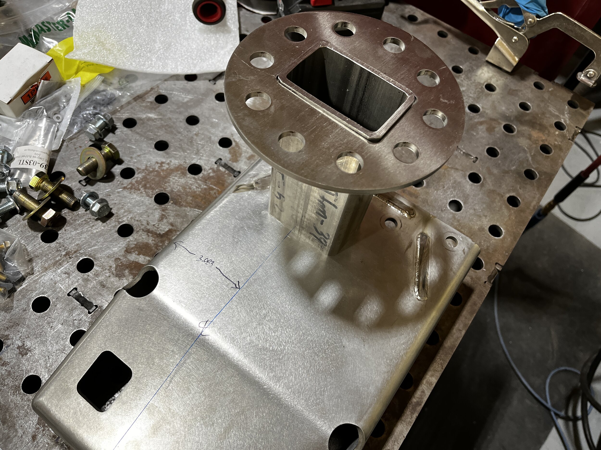

Back to the build. What started my change-of-plans with regards to the rear of the LJ was wanting to install a valance panel below the tailgate to strengthen the tub laterally. Fluxor's implementation of Mr. Blaine's design seemed the natural choice. In my quest for a light weight build, I wondered if I could switch to Fluxor's complete rear package to end up weight-neutral adding a valance panel.
My MORryde hinge/panel kit and HyLine spare carrier setup weighs 45 lb. Klay and I figured his stuff would save me 3-5 lb, which was not bad, given that the valance panel kit weighs 7.24 lb. However, it would take some modification to be weight-neutral adding the valance panel. After I received the stuff, I realized I could modify the spare tire carrier and save even more weight. How much? Well, this morning, I did some figurin', and I think I can save about 6 pounds off the carrier, so I'll be about 3 lb lighter with the valance panel added. Not bad! Here's how I plan to get 6 lb lighter than Klay's design of the spare carrier:
1. Cut the mid-section out of the top bracket that mounts the main bracket to the top hinge, and add a couple gussets to make up for the smaller brackets - cuts .80 lb:
2. Cut the hanger bracket off the main bracket - cuts 1.55 lb:
3. Get rid of the tire mounting bracket - cuts 4.23 lb and another .43 lb for bolts and nuts no longer needed:
4. Cut a bunch of lightening holes in the main bracket - cuts - 1.96 lb:
5. Replace the lug stud bolts with press-in wheel studs - cuts .12 lb:
6. Add a piece of rectangular tubing, a new tire mounting plate (with plenty of holes for light-weight!), and a couple more of the same gussets as #1 above - adds 2.90 lb back:
All that ends up saving over 6 lb! Now, I just have to do all the work...
Stay tuned!
