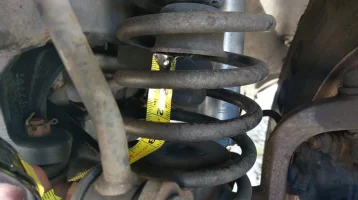

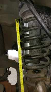

Can you post a pic of the sagging spring?
Here's a pic of the front spring with the measuring tape roughly in place.
It was tough to get a good shot of the whole spring and still show an accurate measurement, so here's a pic of the bottom of the spring, while I was holding the top of the measuring tape against the top end of the spring.

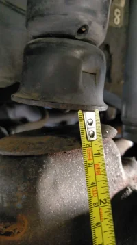

With the Jeep on flat ground, how much shock shaft is showing; and how much room is there between the axle pad and the steel bump stop cup?
Ignore the soft bump stop jounces and you may need to cut away the red shock boot. The boot isn't really needed.
From the bump stop cup to the axle pad is a little more than 3", maybe 3.25".
The front shock part number is RS999128, which is supposedly for a TJ with 0" lift. I don't understand what you're getting at with shock length, since this shock has about the same extended and compressed length as other shocks for stock height.
That 3-3.25" of space ought to be your suspension up up travel. That travel is what allows the suspension to soak up the road. Knowing that your springs are sagging about an inch, your Jeep has lost an inch of being able to soak up the road. Meaning that the Jeep is less comfortable than it could be.
If the shock is bottoming out before the bump stops, then two things are happening. First, you have less than up travel than the 3-3.25" of space between the bump stop cup and pad. Meaning there is even less ability for the suspension to soak up the road. Second, your shocks are acting as the bump stop which means they could be damaged.
There are better ways to measure travels and confirm if the bump stops are correct, but measuring the exposed shock shaft is a quick and easy check for obvious problems. Rancho shock recommendations seem to run long. It is worth double checking.

As the Jeep is sitting right now, the shock is extended to 16.75". The compressed length of the shock is 13.438". That leaves about 3.3" of remaining travel before the shock bottoms out. Full travel is 7.062", so the shock is sitting with just a little less than half its travel left.
In theory, I'd hit the bump stop cup before bottoming out the shock, but it's pretty close and my measurements aren't as precise as the shock spec numbers here.
Anyway, the numbers say pretty clearly that I'm missing an inch or so of spring height.

For what it's worth, there is a nice clean spot on the axle pad where the jounce bumper has been hitting. You can see it clearly in the photo I took when I was measuring the gap to the bump stop cup.
