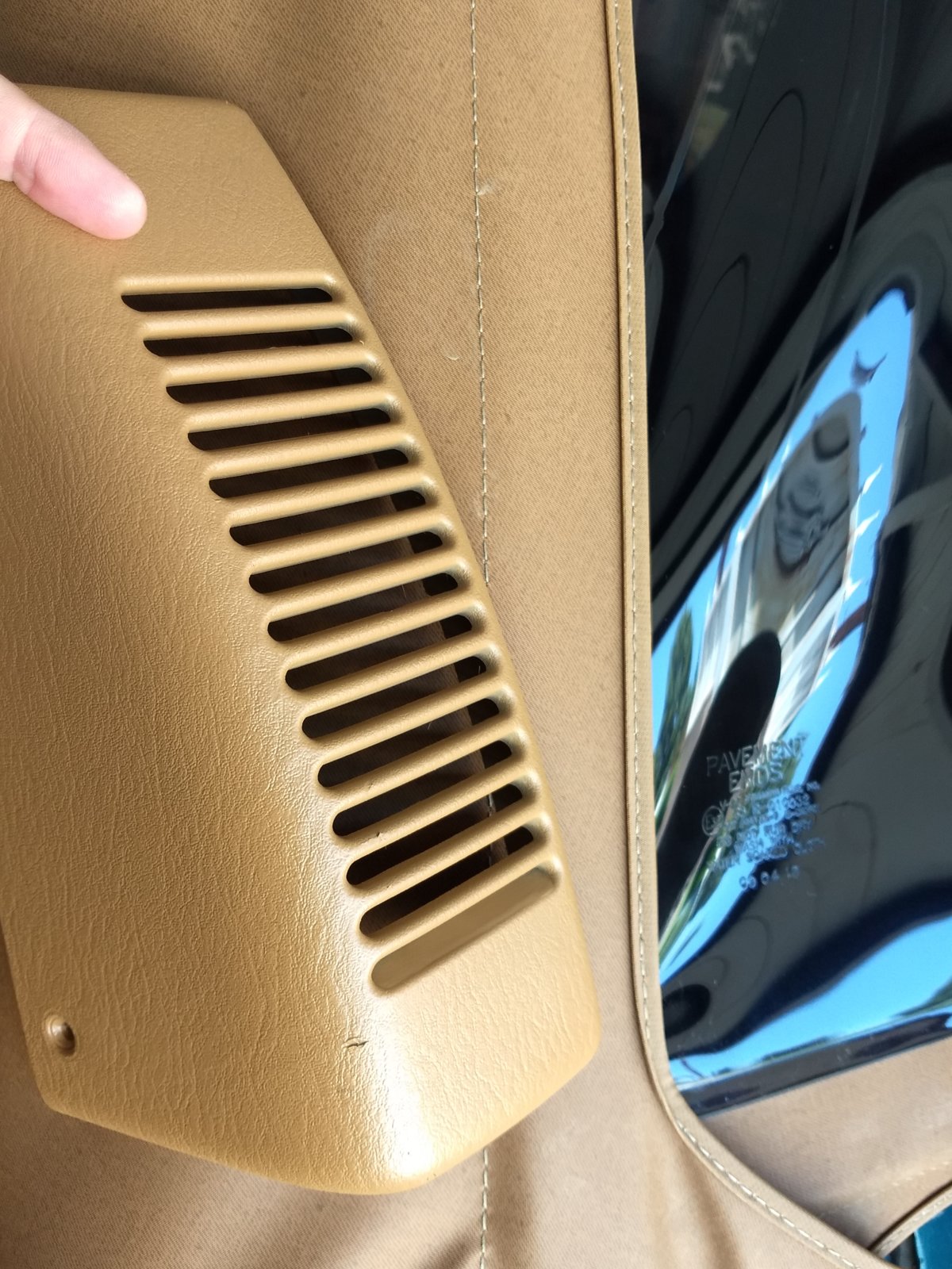

I've been painting my interior using SEM color coat aerosol 15173 (Camel) that I picked up on eBay. Here's a shot of the speaker grille, next to my soft top (which is Bestop/Pavement Ends "spice" color). I'm painting over grey, so I can't compare to the Sahara factory color. Hopes this helps give you an idea of what to expect.
The "palamino" 15323 was a bit too yellow-y and brighter than the Bestop Spice color BTW.

Looking great. You painting the whole interior?

That is awesome.

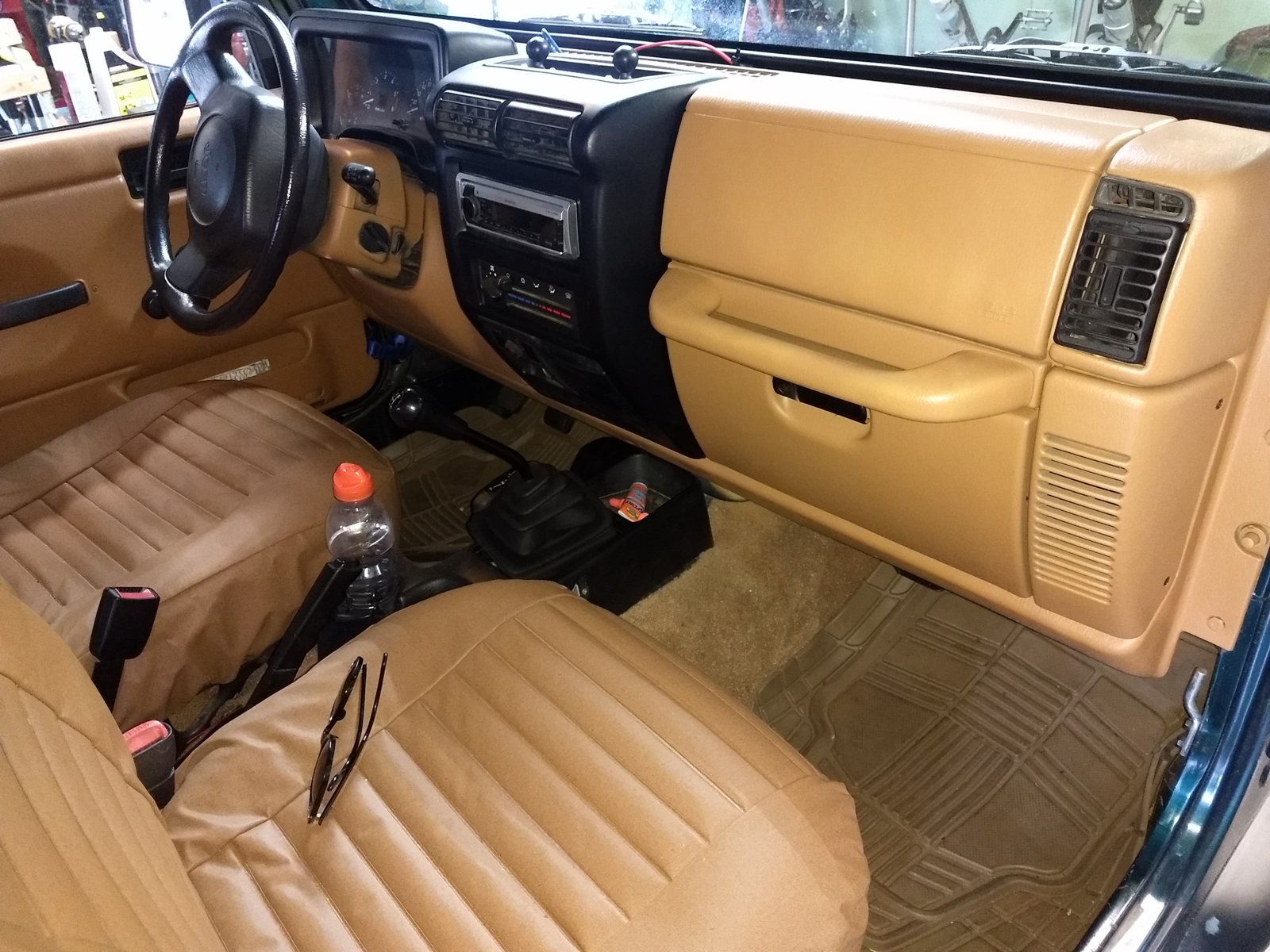

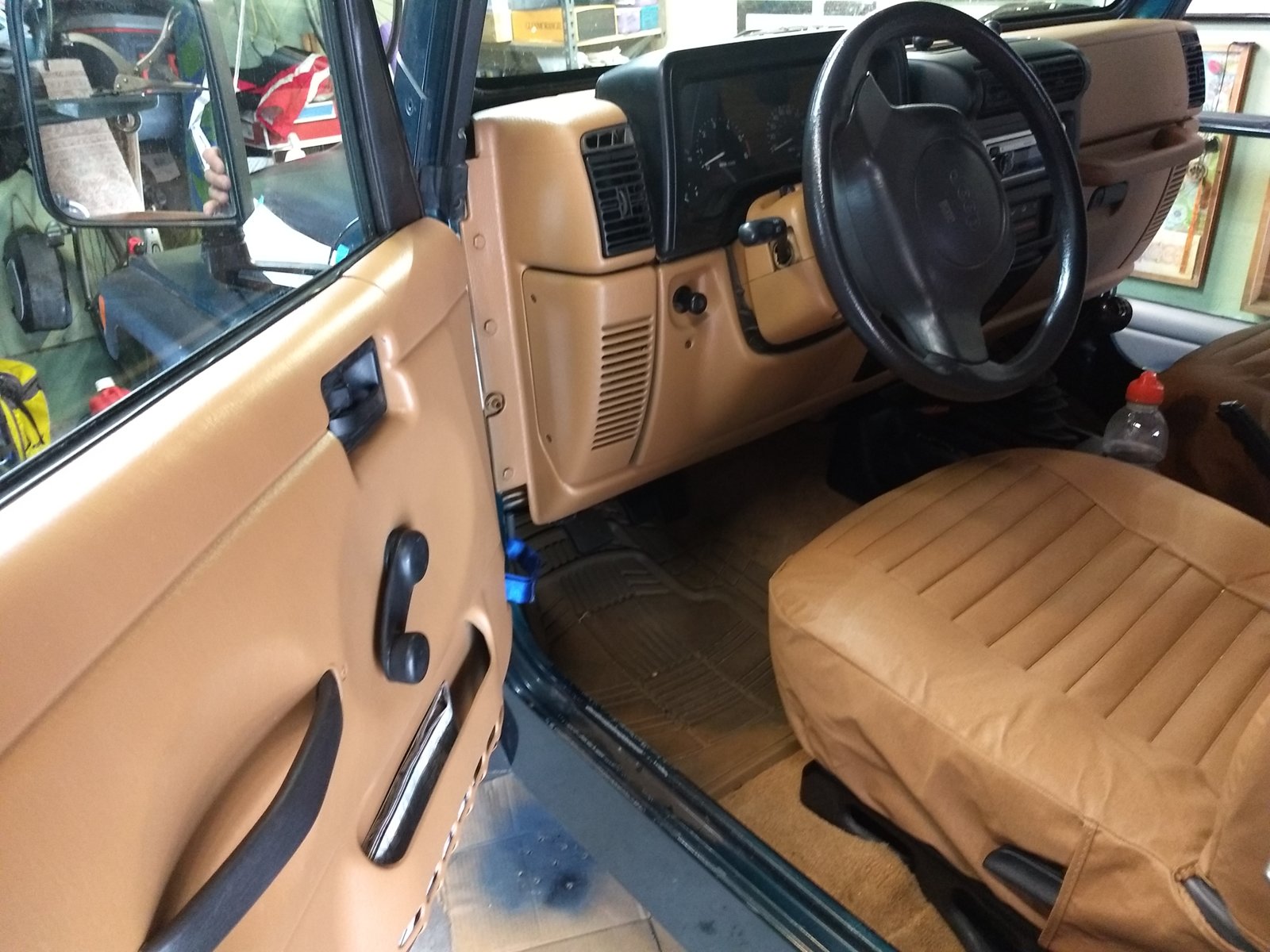

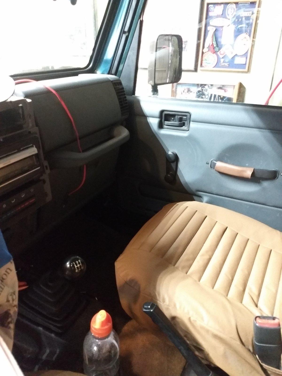

Before and after. Note the seat cover is the Bestop Spice color. Hope that gives you an idea of the color match. I used an adhesion promoter before applying the SEM paint. Whole job was two and half cans, but that was to go from grey to camel.
Amazing job, @intheSFValley. I didn't know it was possible to change the color of your interior panels so dramatically. You even painted the steering wheel shroud, which gives your interior a unique touch. You now have a one-of-a-kind color combination overall.
I'm curious for my own project: how did you remove the airbag cover? Or did you just paint everything in place?
Reactions: intheSFValley
I was debating whether or not to paint the shroud. I think it looks alright, but it would have been easier to leave it grey. And I did not remove the airbag cover, just masked everything up and painted in place.
One warning, the paint can't take much much abuse. I ended up scuffing it on a road trip where a cooler rubbed up against it while bouncing around the desert. Good news, it's pretty easy to touch up the scuffed areas in a few minutes.
I can confirm that the Sure Coat is also very delicate. (Sure Coat is SEM's water-based version of Color Coat.) Since I've painted my door panels, console, and dash, small areas have rubbed off. Since the Sure Coat is the same color as the panels, the rubbed-off areas don't look that bad. It's not perfect but it's still a huge improvement over what I had before. The Medium Camel 5020 is absolutely the dead-on exact color of the original panels. I have painted and unpainted panels side-by-side in the Jeep and you cannot tell which is which.
