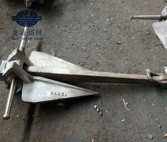

Just my personal opinion but there's very little difference between how a Danforth or CQR plow anchor and a Pull-Pal work. All three were designed for use in sand and all work best when there's enough line out (scope) to give a low pull angle to help it dig in.

Out of the two anchors and the Pull Pal, I'll take the Pull Pal; that'll cut and hold in dry sand better than the other two.

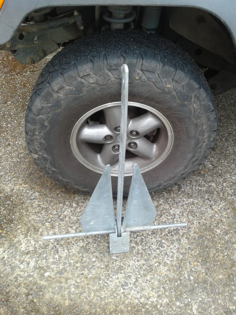

Oh man, now you guys have got me curious about this.
As you can see, this would be unhandy as all get out to pack around "just in case". Rigging it up to a winch and pulling on it in the sand would violate all sorts of safety rules for winch use on a Jeep as well.
Hmmm, sounds like a stupid human trick in the making. I like it. Not going to try it, but I like it.
Easier, safer and more satisfying to just learn to drive in the sand with all it's variations.

Buried sand anchors are never truly safe, but I don't know that I've heard of one suddenly and violently escaping the ground; that's just not how sand works. Also, it's worth noting that 95% of the time, you can extract yourself with a shovel simply by digging out the rig.
