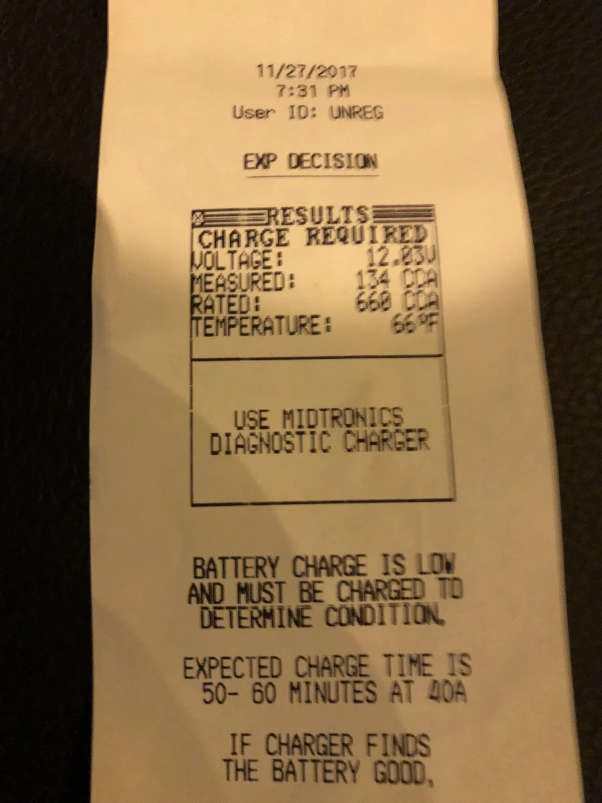

The advanced test took significantly longer than autozones test. Will be testing the battery again tomorrow once its charged. Thanks for the reccomendation @Jerry Bransford!
That Bosch 117A should be fine, but has your battery already had a properly conducted load test performed on it? Not many auto parts stores know how to properly give a load test to a battery, they need to hold the proper load on the battery for no less than 10 seconds. Many don't do that and after just a brief test pronounce it good even when it is bad.
Technically they can't do a proper load test on it now because it is at 12.3 most likely it would fail a load test right now that it doesn't have a full charge.
