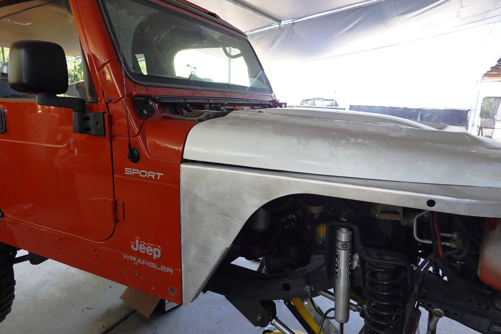

Today's clown world is just that, a fucking clown world. Anytime some fuckwit puts up a used, reasonably good condition AEV TJ hood for sale with a price of 2200 dollars, it is fucked and not getting better at all. There is a large contingent of folks who are fully enamored with Nemesis. We just installed a set of their high line fenders. When the owner saw the bullshit we were having to deal with, we removed them and put them back in the box. This is the hood gap on a typical high line hood we use. It is correct with only very minor mods needed to make it fit. The fenders are at the upper limit of the slots at the firewall.

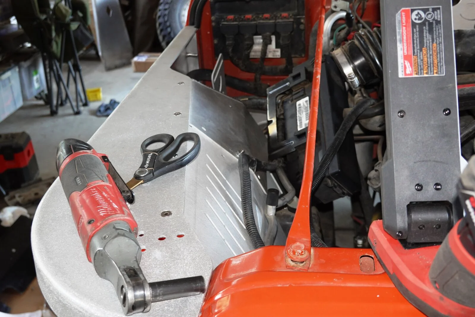

This is after slotting the holes to move the fender higher.

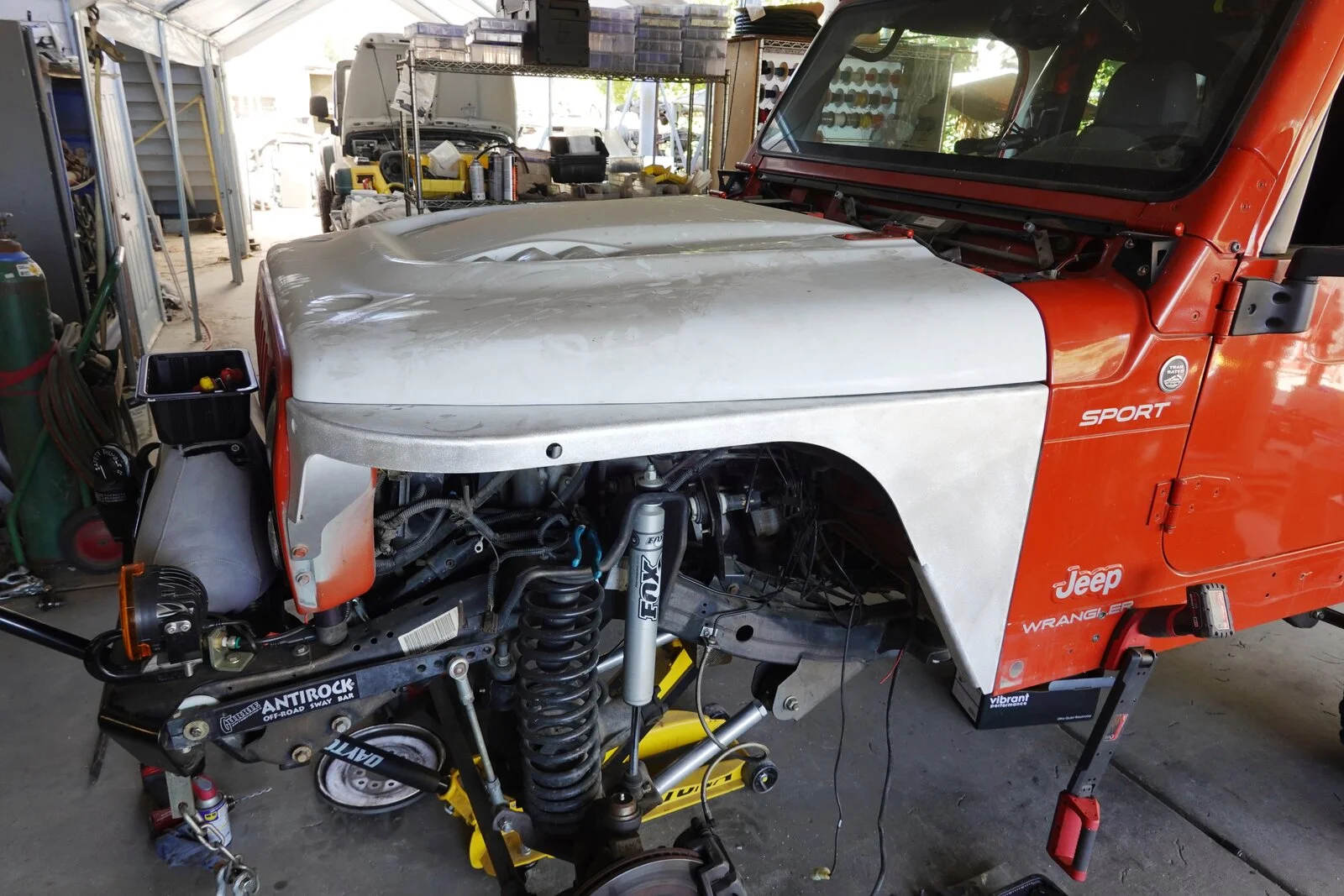

The front of the fender is way too high but we could have fixed that. The two things we can NOT fix are the goofy lack of real estate to mount anything.
And almost the worst part, they have a complex battery tray with a very specific hold down that has a tab into a slot on one side and bolts down on the other. In their infinite short sighted wisdom and being full on shit fucking designers, they made it fit ONLY an Optima battery with no other options. The two components of the mount and tray are so complex and convoluted that you can't modify the Optima version and depend on the strength.
The final straw that put them back in the box was having to cut the Savvy aluminum backer and also trim back the steel slider.
