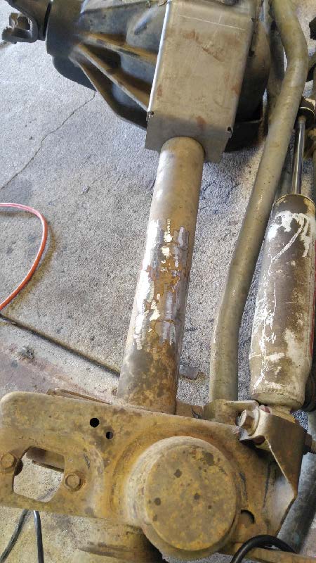

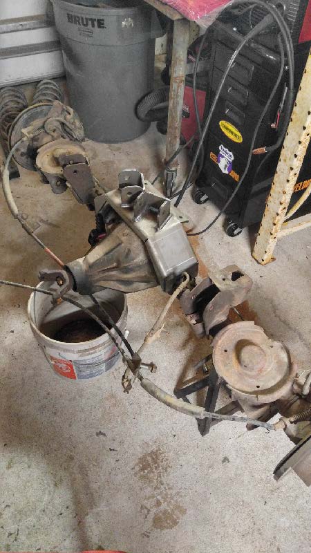

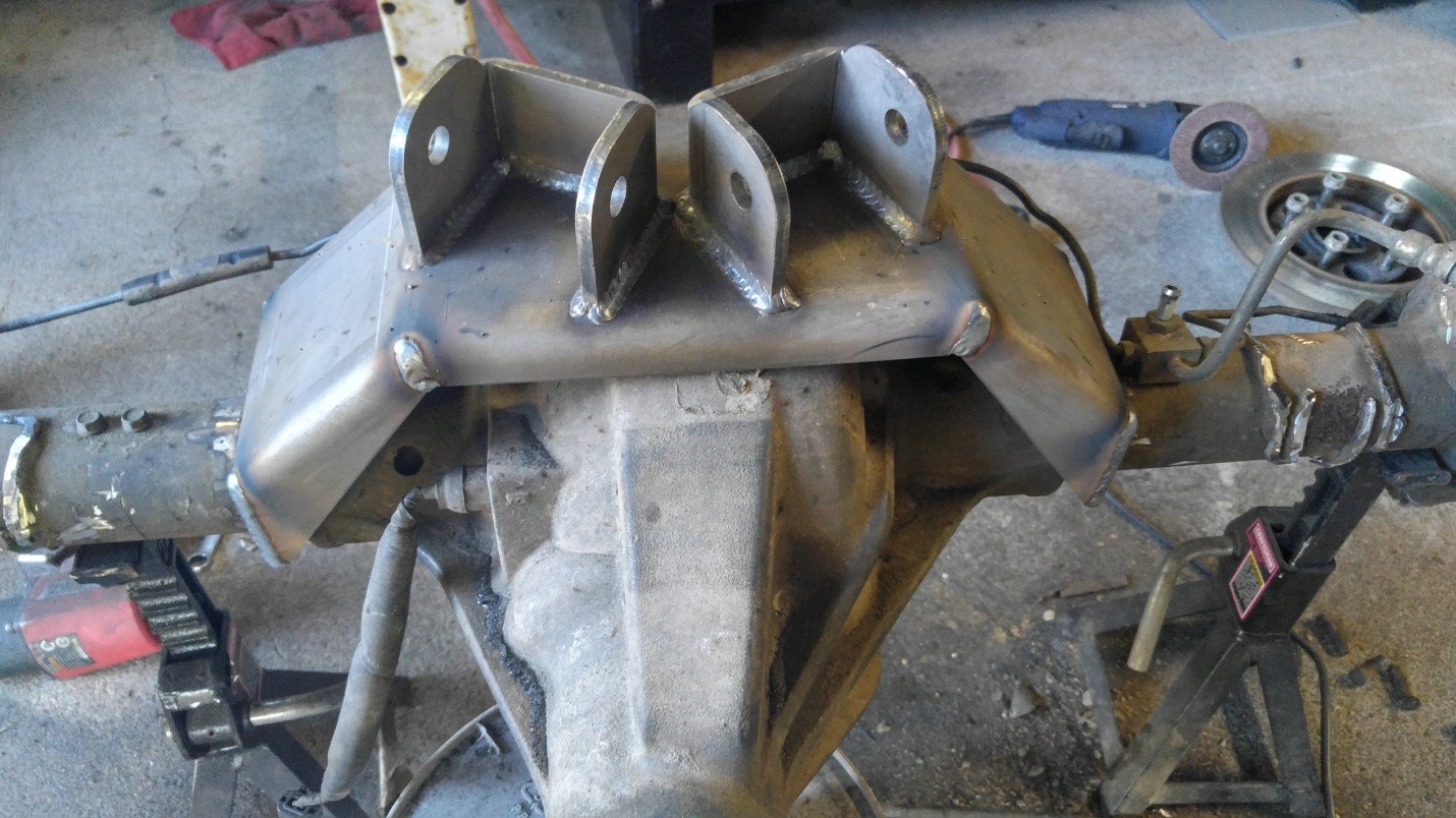

(Here is a picture with the rear axle removed and Savvys Truss sitting on the axle. This is a heavy duty Truss and placement is phenomenal. You will have to re-route your brake line but this wasn’t a huge deal.)

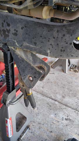

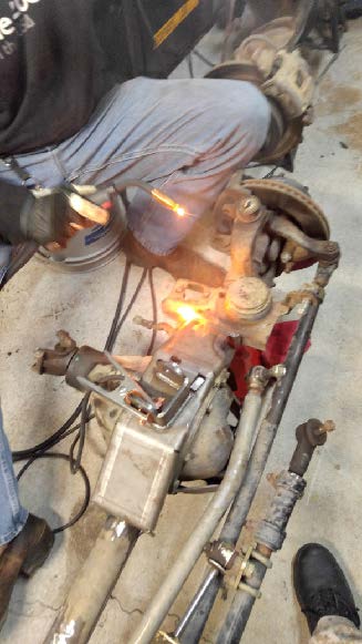

Now the fun begins. It’s time to start cutting the stock brackets off. Hopefully you have a plasma cutter. A cut off wheel will work just fine, but a lot more time consuming.
This was the most time consuming process to cut all control arm brackets off the frame and grind everything smooth.

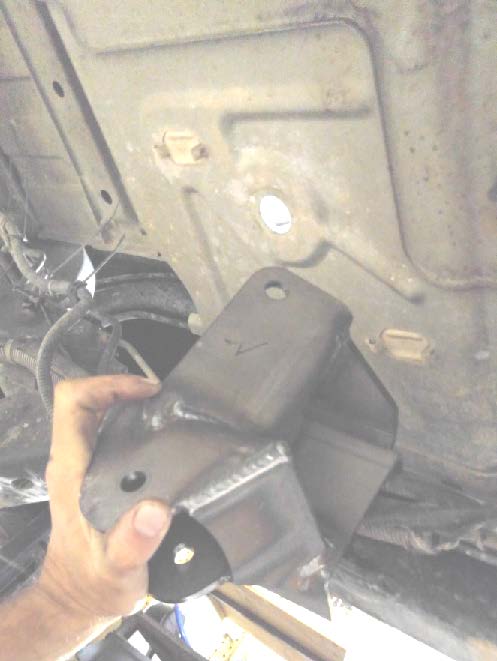

Here you can see about where the bracket will go and why the lines need to be relocated. Do not forget these lines when it comes time to weld these brackets on.

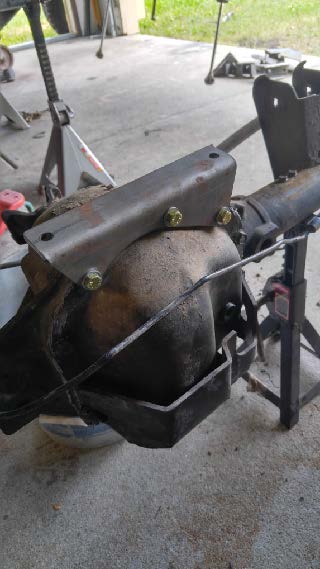

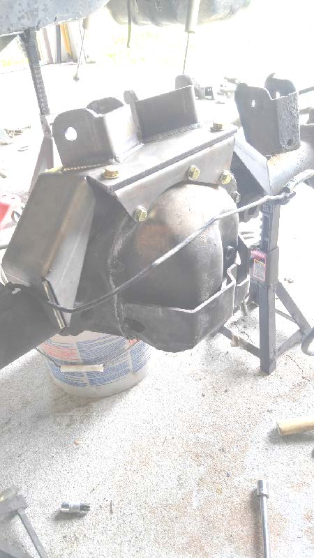

You can see how I have the brake line in front of the diff cover for now. The bracket you see on top of the diff cover is what you will use to align the rear truss. I put this bracket on and tightened the bolts only tight enough to hold it in place.
(Tight bend of brake line around the truss.)
The top 2 bolts align the truss to the bracket I showed on the previous picture. I wasn’t a huge fan of the tight bend of the brake line but it hasn’t been a problem so far. Time will tell.

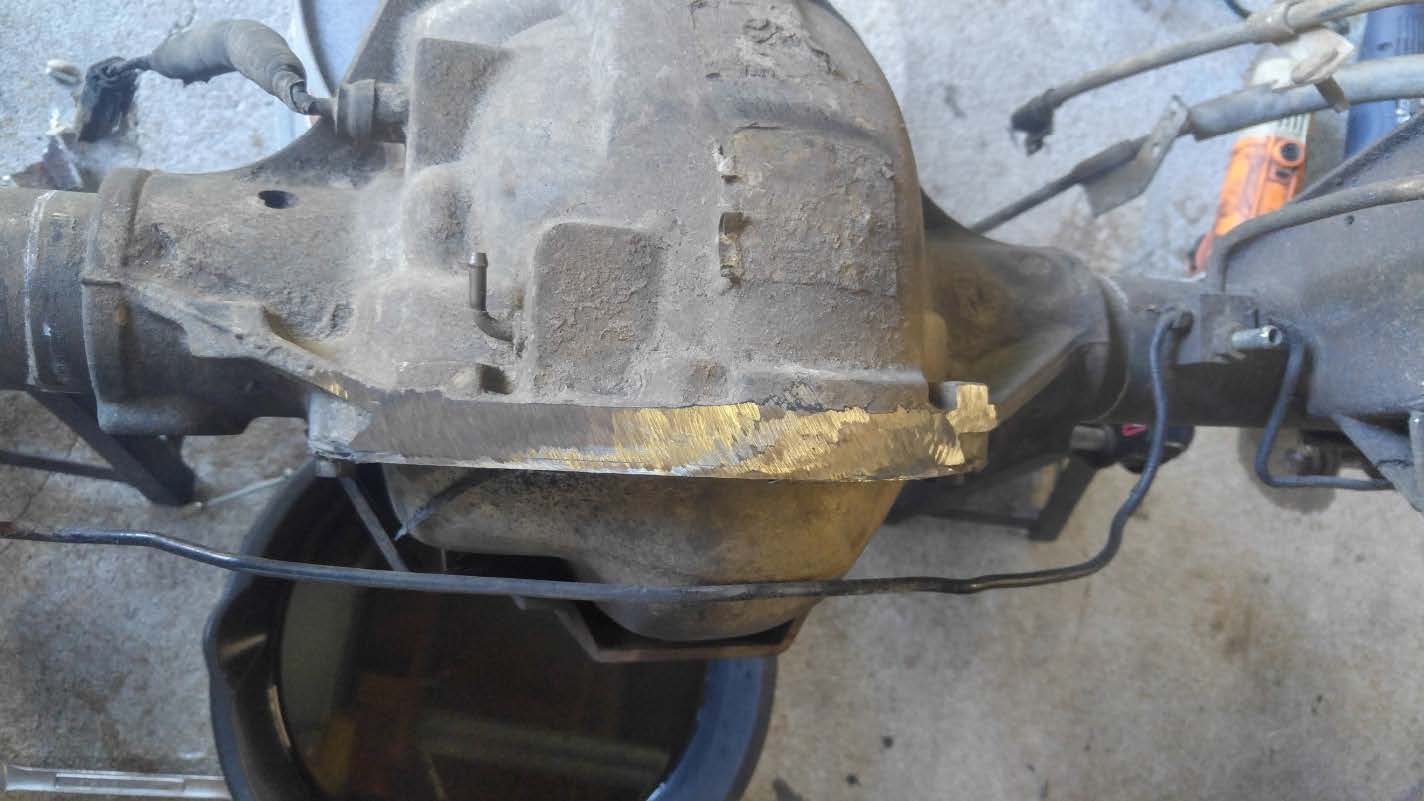

Here you can see where the upper control arm brackets were cut off the axle and the truss were welded to the axle. I was running short on time and didn’t grind the old brackets smooth, but I will when I get back from my Colorado trip. Prior to welding this bracket to the axle Marty recommended I grind the top of the axle housing I believe a 1/16, but don’t remember the exact measurement. See picture below.

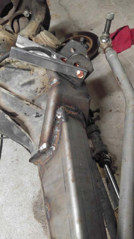

Again you have to remove the 2 upper control arm brackets from the front axle. This time I removed and ground clean and painted.
Again, the test fit was perfect. Marty gave me specific instructions on how to weld these brackets in place so I don’t apply too much heat and end up warping the axle tubes. 1-1/2” welds and 1-1/2” spacing in between the welds in the pattern you would use to tighten head bolts. A Criss/Cross pattern starting from the outside and working your way in. I took several breaks making sure not to warp anything.
(My welds weren’t all pretty but they got the job done. Seems like the more beer I drank the worse my welds looked.)

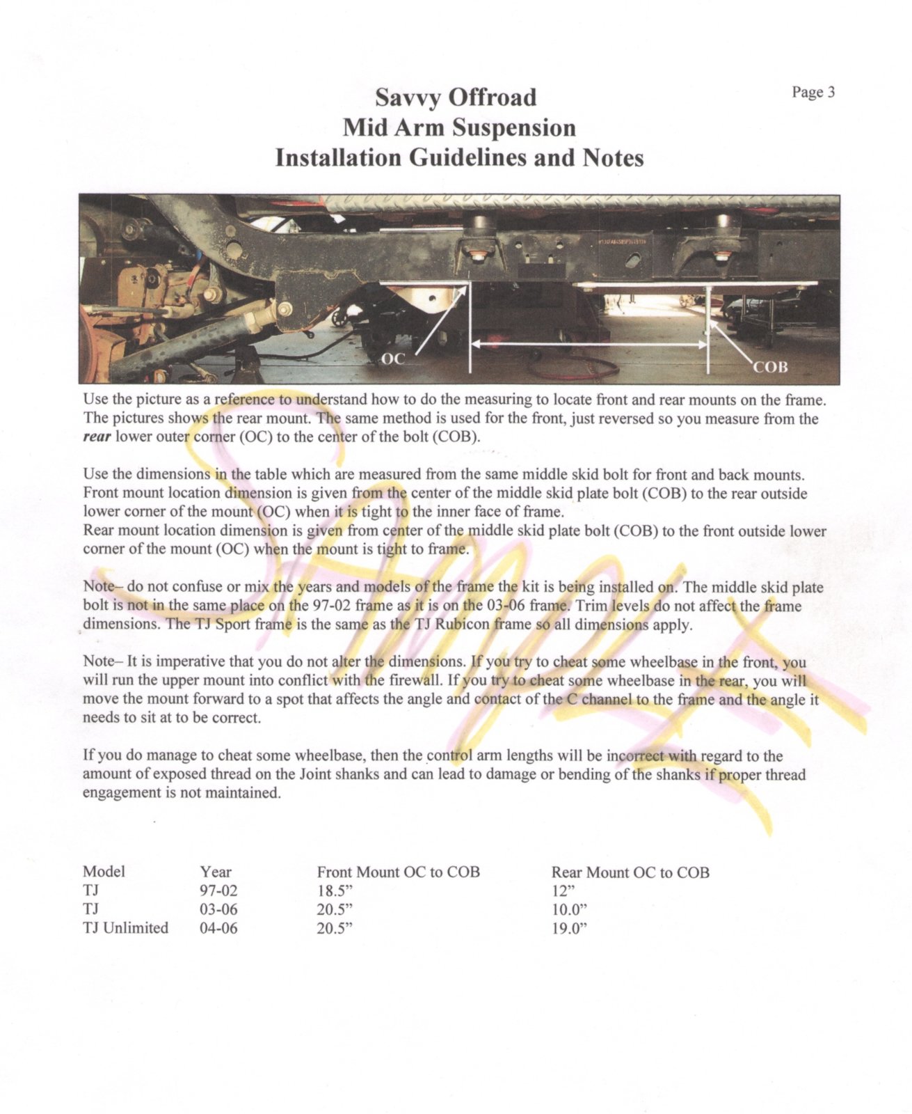

I will put the documents that I received from Marty for the placement of the brackets that still need to be welded to the frame. Be sure to prep the frame and grind everything down to bare metal for good weld penetration. Also these documents will give you an initial setup for control arm lengths.
The location of the bracket placement is an exact measurement and the initial setup of the control arms are a starting point. You will have to make adjustments for pinion angle and I also have some clearance issue with diff cover clearance on the front. You absolutely need to test and tune. Get your bump stops set up correctly, ensure your axles are sitting square and get a front end alignment. Here are pictures of this kit on my jeep. I haven’t had the chance to test and tune, but will get this perfect very soon.

- The rear brace for the truss to diff cover bolts is NOT optional. It should be used with a stock thickness diff cover to locate the truss properly fore and aft.
- When cutting the front cast mount off the diff, it should be cut halfway through on a horizontal plane so the ears stick up through the truss and then are welded up. This provides a mechanical bond, not a fusion bond from welding. (The truss can move with the weld filling the holes, and even if they do break, it can’t move, due to it still being a tight fit.)

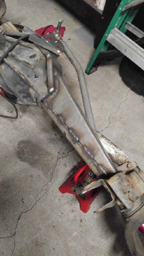

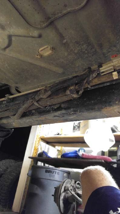

(Be careful cutting around brake lines, locker lines and electrical lines.)

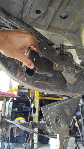

You will have to un-clip all these lines. I pushed them all up in between the frame and the body. I have a body lift for the tummy tuck which gave plenty of clearance for lines and hoses.

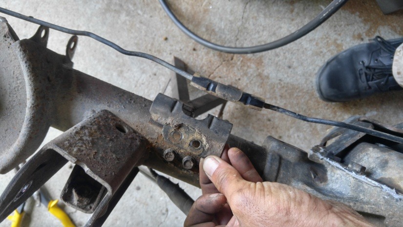

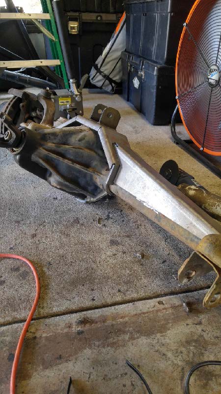

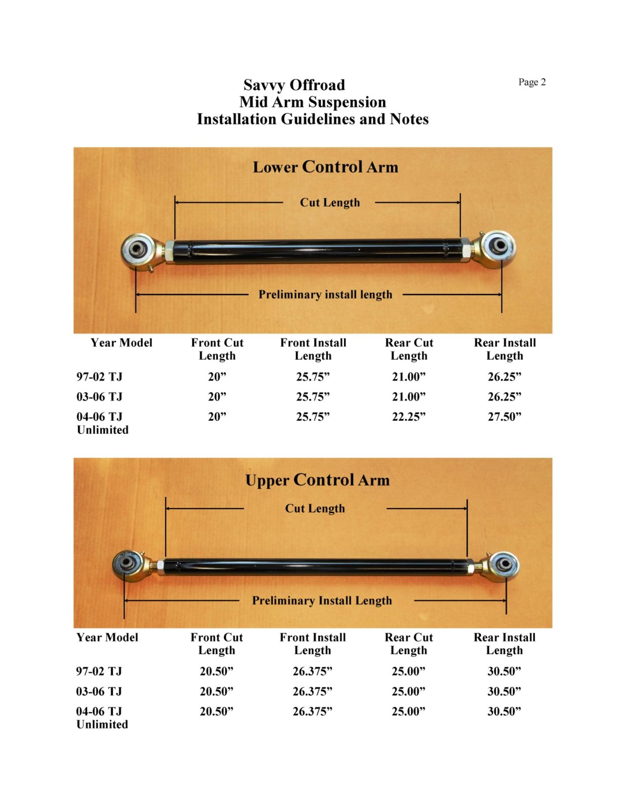

I removed this bracket that holds the brake line to the axle. It may not seem the brake line will have enough to be rerouted, but if you carefully work with the line it will bend around the diff cover.
