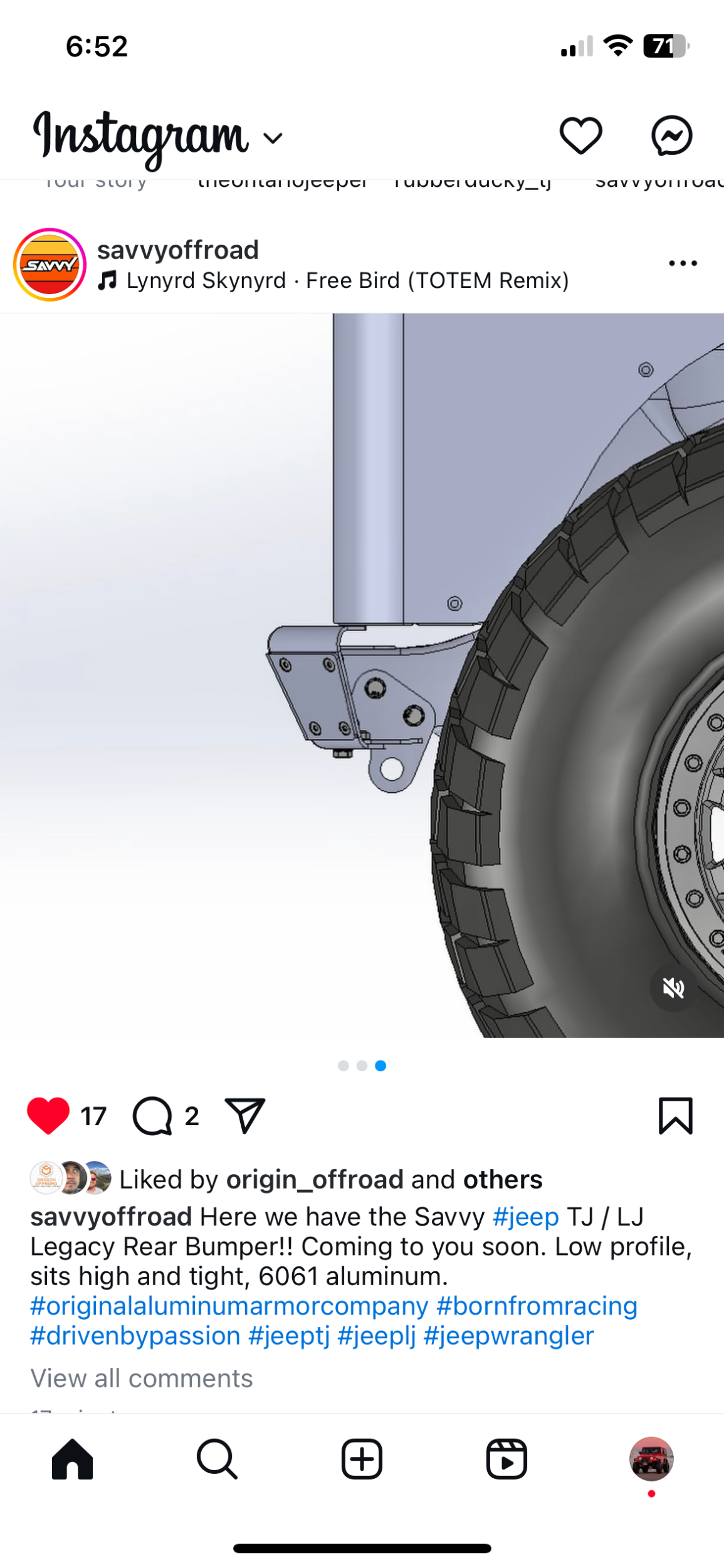

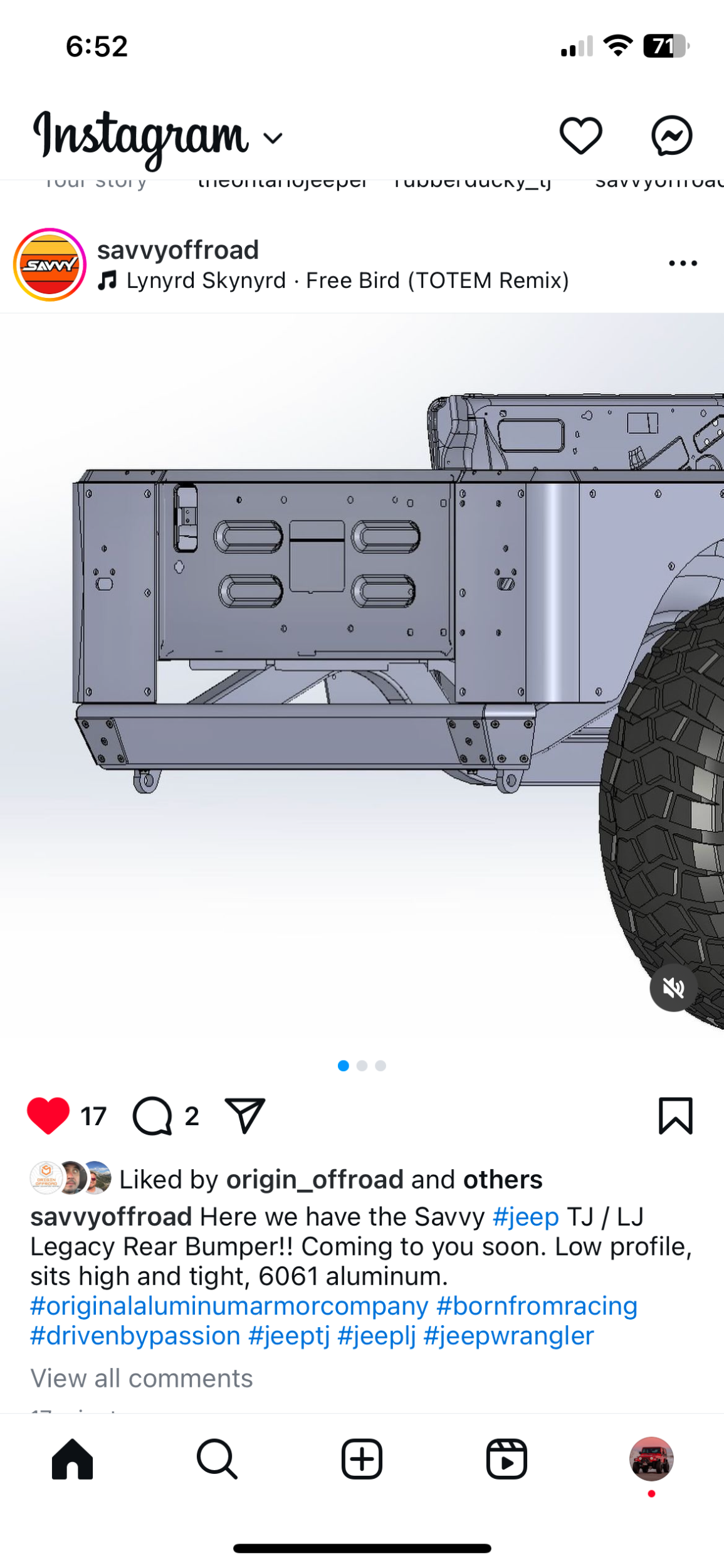

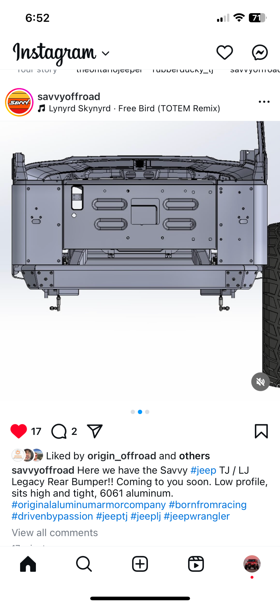

Interesting to see the recovery points under and tied in as the frame support.

Probably work fine in this application. If it was on my LJ I would drag them to the point of replacement.
Was thinking the same thing. That spot gets alot of wear. I’d much prefer like fluxs front bumper corner armor that even wraps on the bottom for protection. Not adding an extended hit point.
I drag that part on my TJ with a raised rear frame.
The only way that attachment will begin to work as a recovery point is if the ring plate is installed with flag nuts inside the frame rail, or if the bolt is sleeved all the way through the box frame.

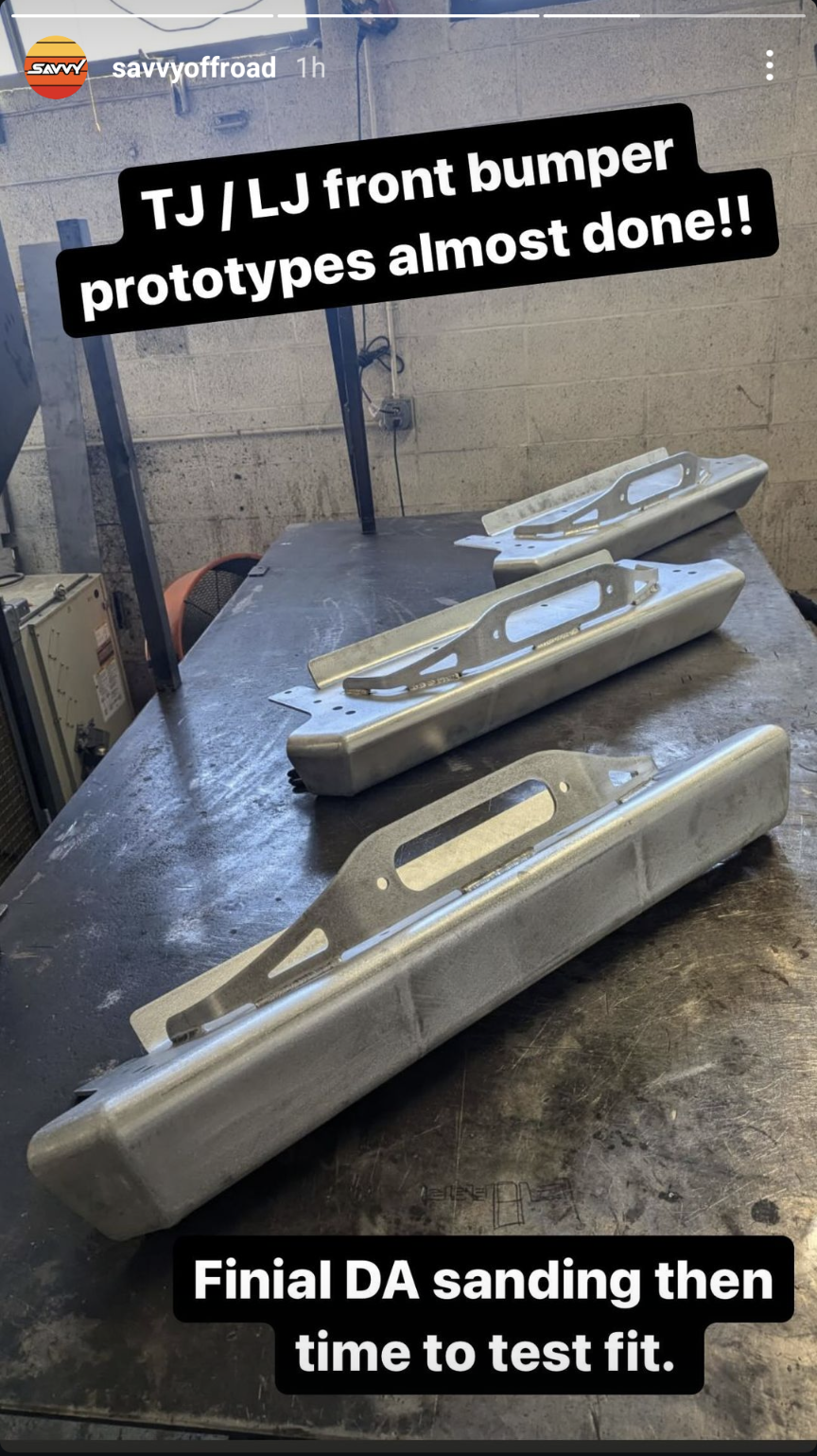

This was mostly from one day. Adding those hangy bits seems like a bad idea.
Guess if you have been waiting you might see something in the future. I've already made my bed with Fluxor, ain't gonna wait another year.
Don’t like the non adjustable, not double thickness, direct welded winch deck. Also what’s with the heat marks down the middle? Back side brace welded on?
It looks like it's outside the departure angle, but rocks don't follow the departure angle.

More cost savings at the expense of what used to be a high performance rock crawling bumper. Now the winch deck is half the thickness of the original design. And every one of those new welds to attach the fairlead mount and whatever internal bracing has been added to the inside is eliminating the heat treatment of the aluminum. And the reenforcement bend at the back of the winch deck is too small of a bend radius (and is way out of proportion).
One of the fundamental reasons for original Savvy design aesthetic being what it is was to utilize and preserve the qualities and characteristics the 6061t6 aluminum with as few compromises to it's strength and resiliency as possible. Whoever is doing these updates to the TJ line does not understand the material he is working with.
