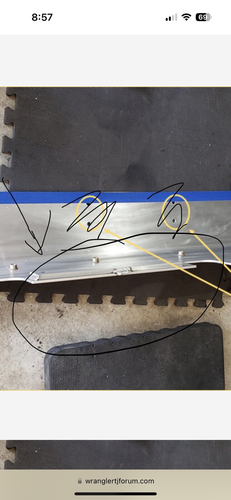

How does this plate affect the overall mounting strength of the slider? Since it’s welded on it has to affect the heat treat to at least some extent, since a bolt goes through it, why not let it free float and use it more like a washer instead? I understand that it’s needed but does it need to be welded?

Also I honestly don’t have many photos of the slider, mostly just pulling information and pictures from different threads on the forum.

The discussion was centered on the bumpers.
Alight well now I have some more questions, it appears and I assume all the joints are welded, why not use the corner protector that you used on the front bumper on the rear bumper aswell, is the rear bumper splitting from a hard impact on a corner not really a problem? Why not go with a simpler design like the front to keep the welding at a minimum?
