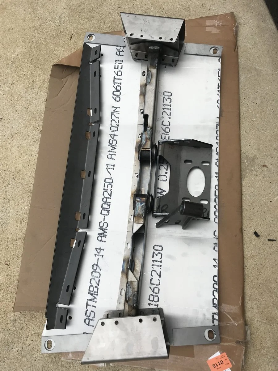

This thread was invaluable in helping me get the skid installed on my TJ. I wanted to add this pic though that shows all the parts in the orientation they will go...it can be a little confusing and might save someone some guess work...
wow. What a difference!
this image gave me the idea to fly back to AK with the kit. Thank you.
