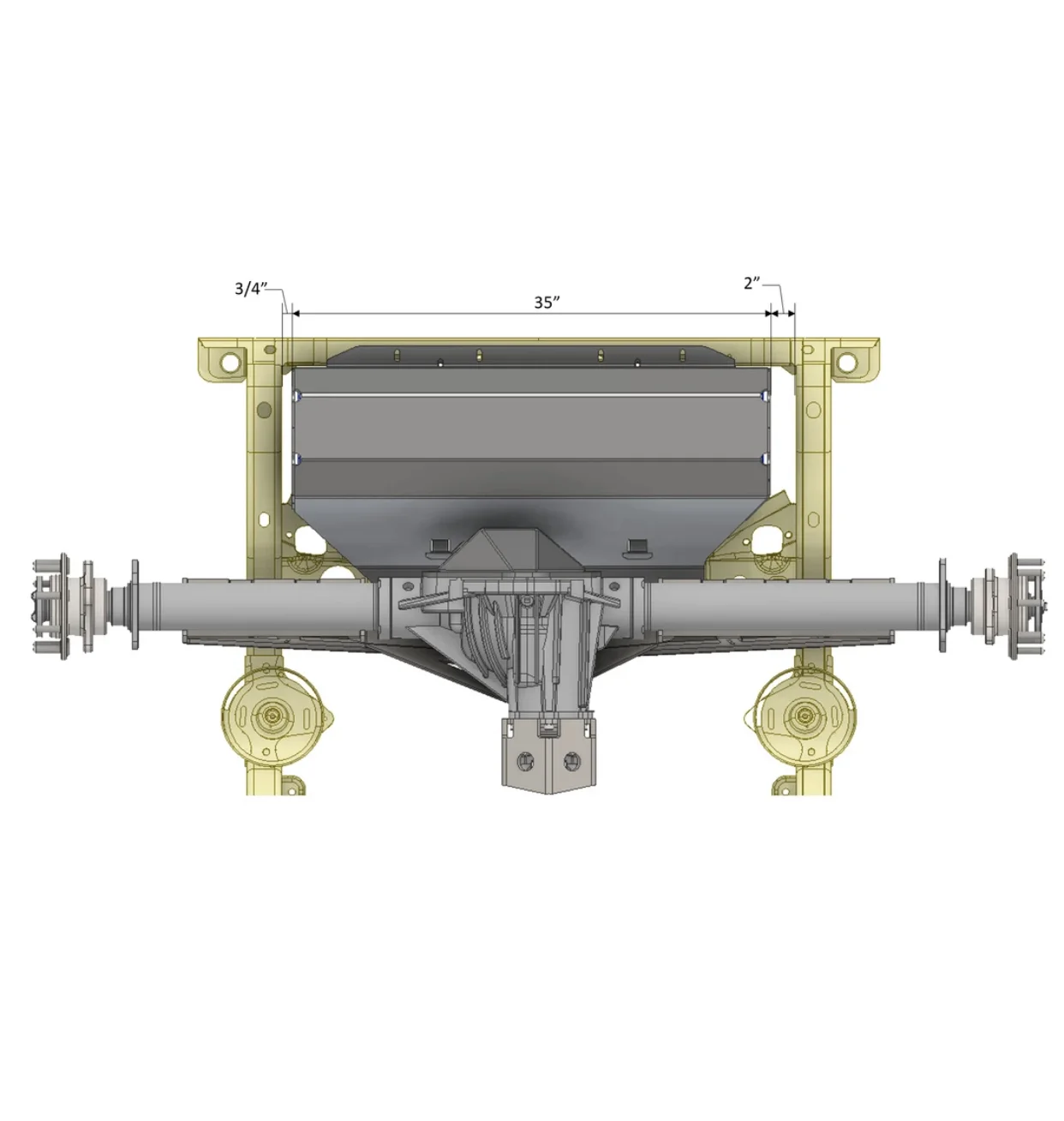

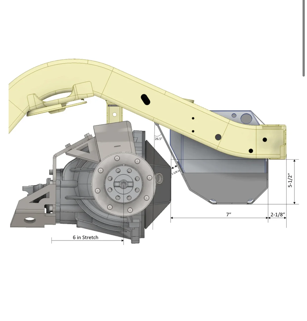

Looks like a pretty straight forward competitor to the 15 gal. Genright Alien one as far as components included. The main difference being the way they get the 15 gal. volume and the stretch you can achieve.
Motobilt claims 6" and Genright claims 9". Is that extra stretch worth it at ~$133/inch?
