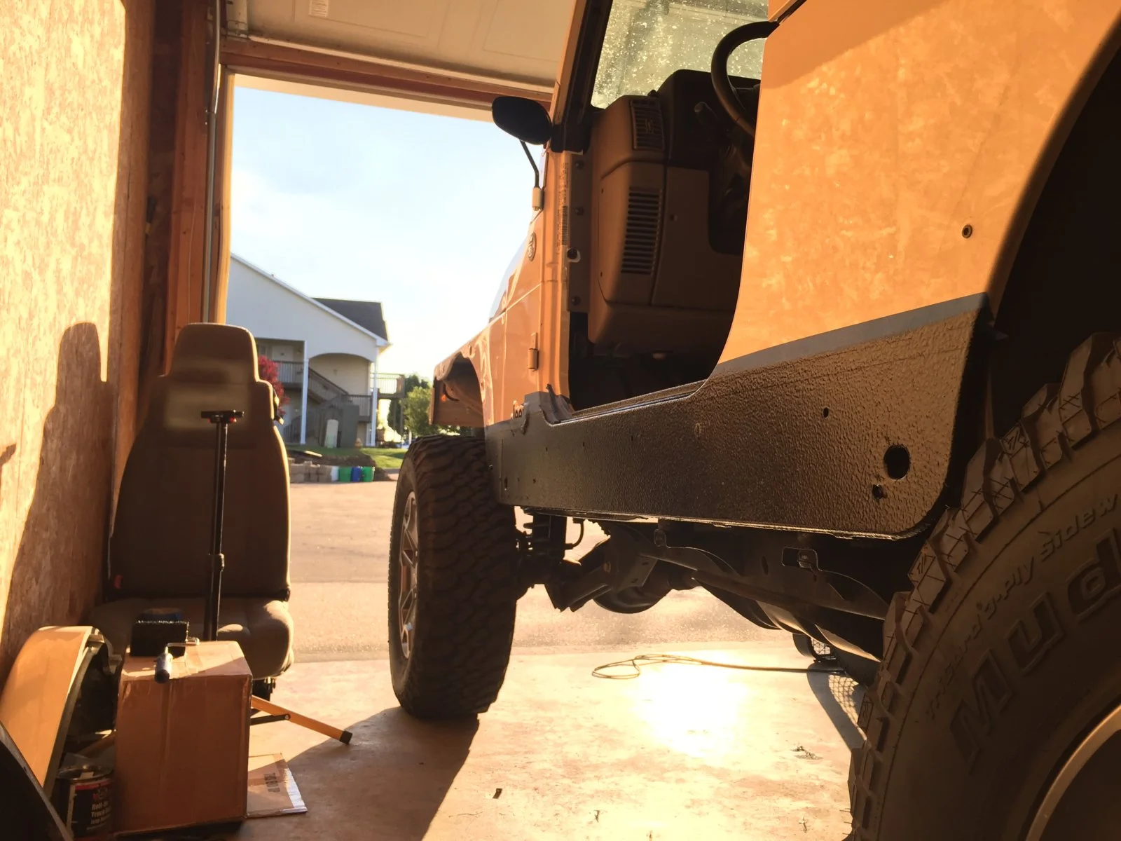

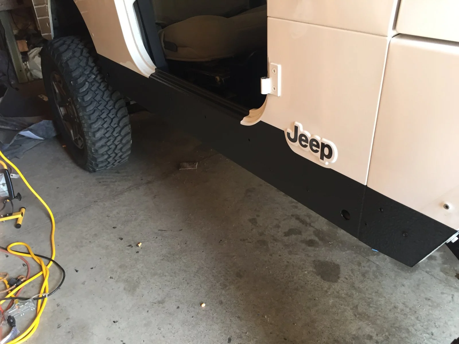

I had this same dilemma when I put mine on and ended up using Monstaliner behind them. And for the record, I initially had them on for about a month in the summer without anything between the body and the slider. That short time was enough to cause a few areas of surface rust to develop where grit had worked it's way in.

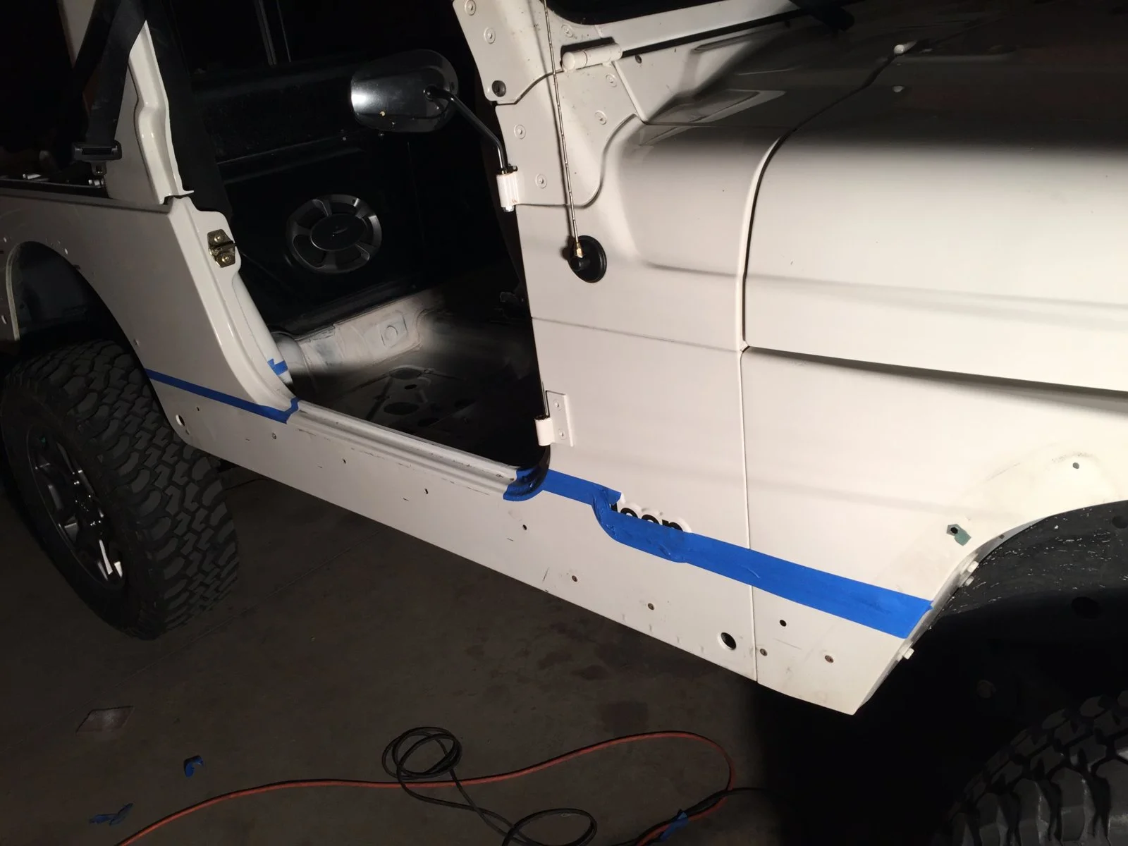

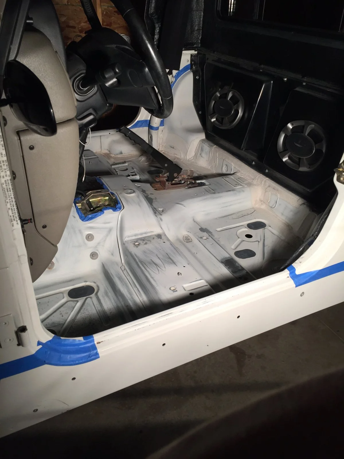

I live deep in the center of the salt/rust belt. I have sanded/primed/painted/sealed everything under the panels and parts that I will add as well as the undersurface of the parts that I will add. The rocker guard gasket looks like just the ticket.
